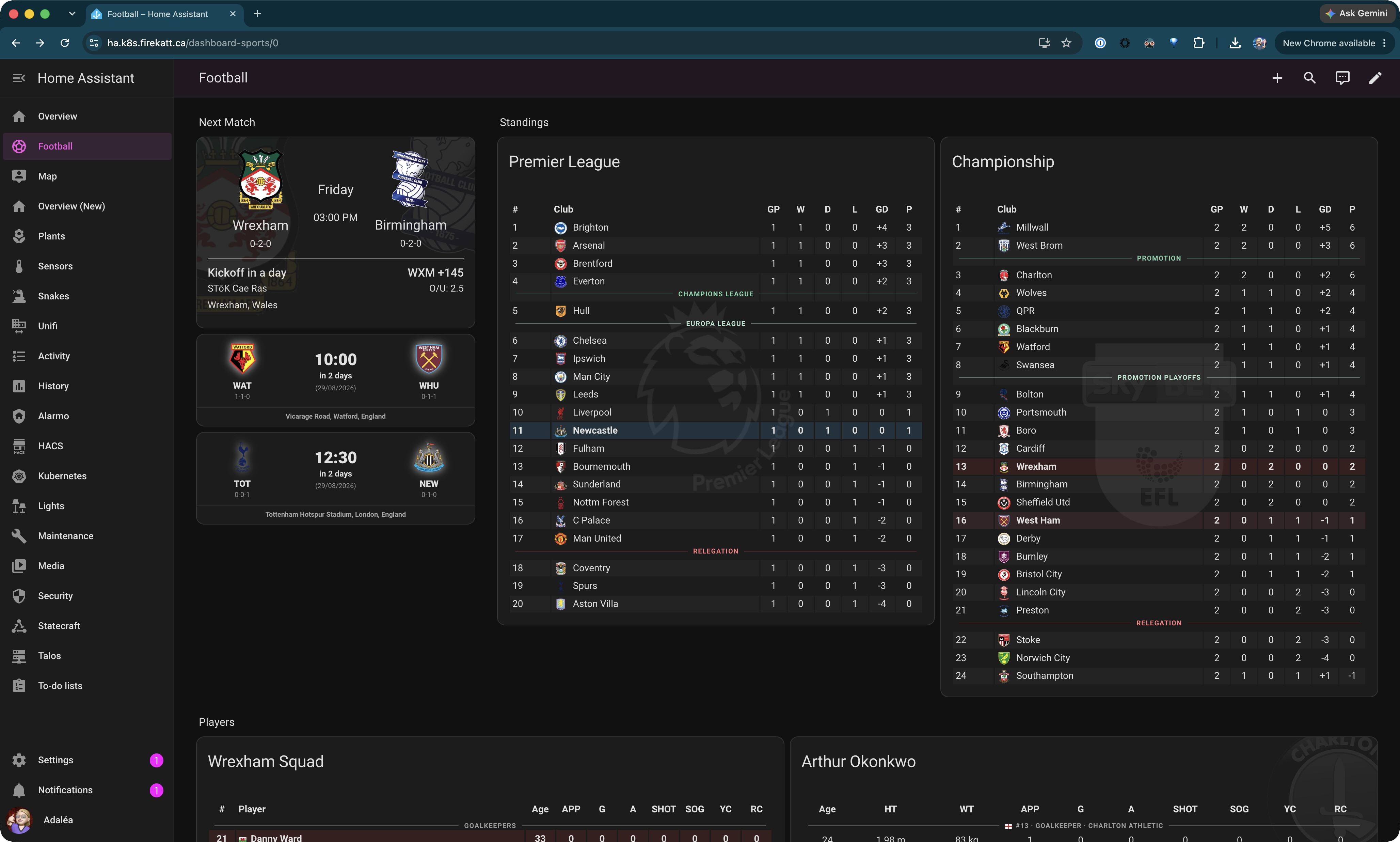

Football dashboard
I just wanted to share a football dashboard I made that lets me track 3 teams that I follow along with a few specific players as well. All the data is being pulled from the ESPN api
sensor.yaml code

Standing tables
type: horizontal-stack
cards:
  - type: custom:flex-table-card
    title: Premier League

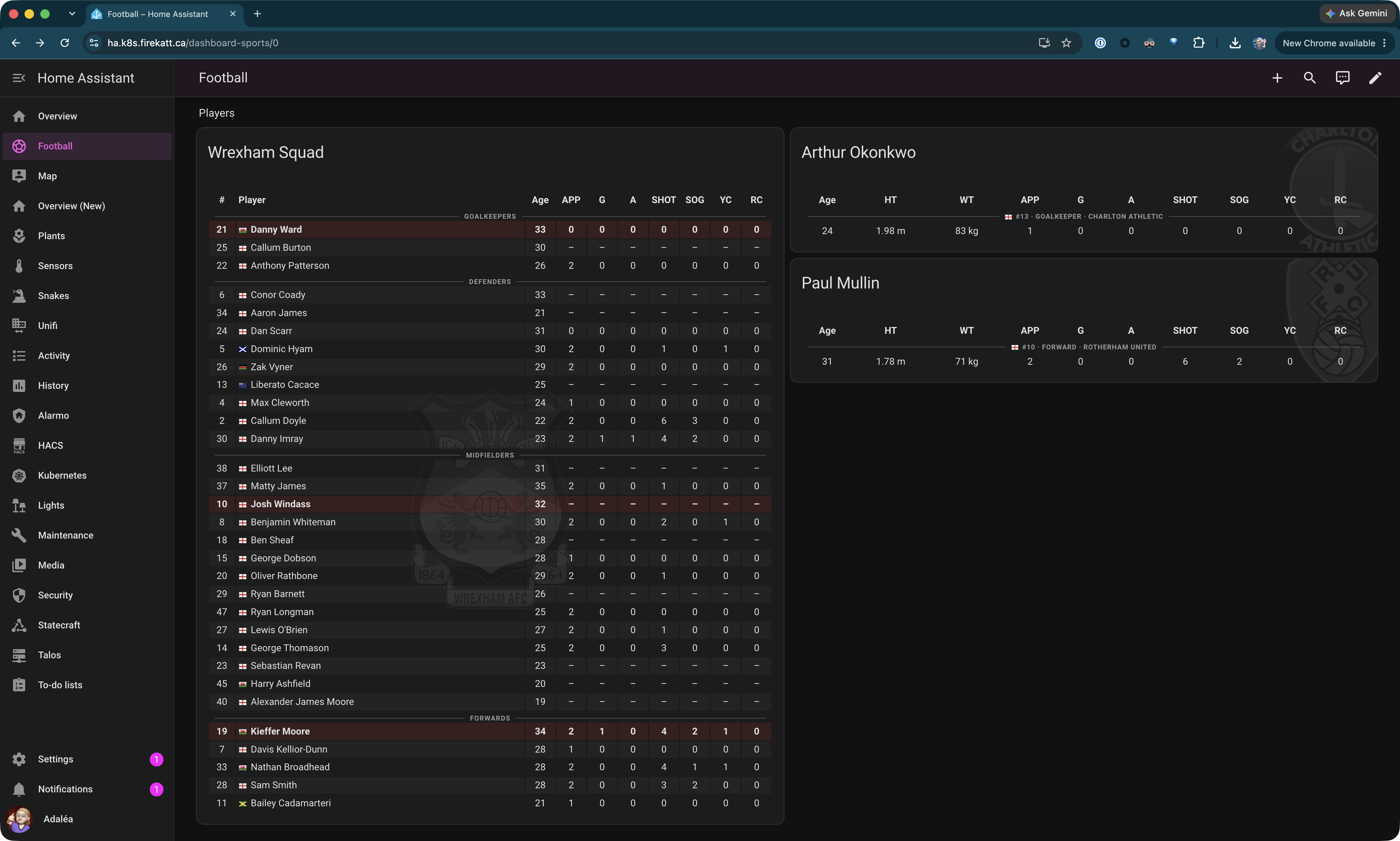

Player tables
cards:
    title: Wrexham Squad

    entities:
      include: sensor.wrexham_squad
    columns:
      - name: "#"
        data: athletes
        align: center
