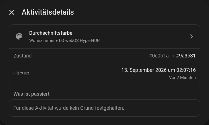

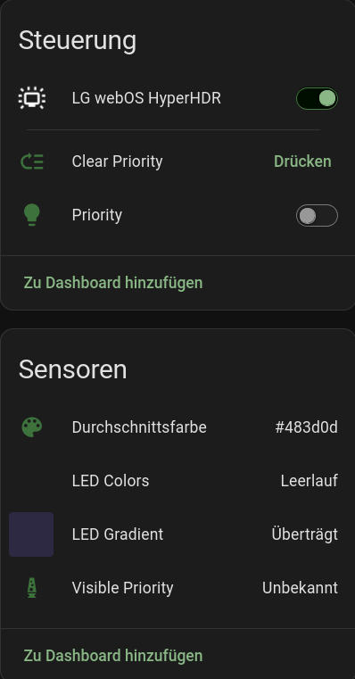

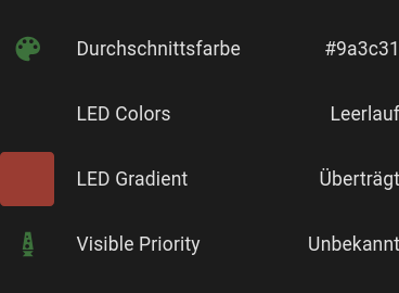

Wait, also, does something in HA “invert” (or average) RGB values (already?). I just noticed when manually testing the colors do not quite fit “togeher”:
Now, this is clearly orange in the stream/gradient and #9a3c31 is also correctly reported as such and also seems to be it.

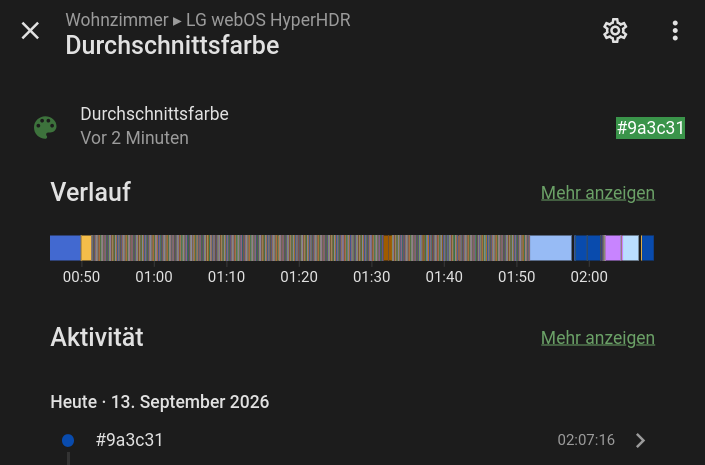

However when you look the the history of the sensor, it s suddenly blue:
I just figured out when clicking on it, you also see the “wrong” color value as the light value:
#0c0b1a is that dark blue.
