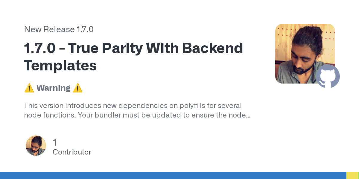

I think I’m the only one using this templating library, but I wanted to announce that as of 1.7.0 every single Home Assistant template extension has been implemented in this package. Other than some minor differences in behavior, this templating system can now do virtually everything the Home Assistant backend templating system can but synchronously and faster.
