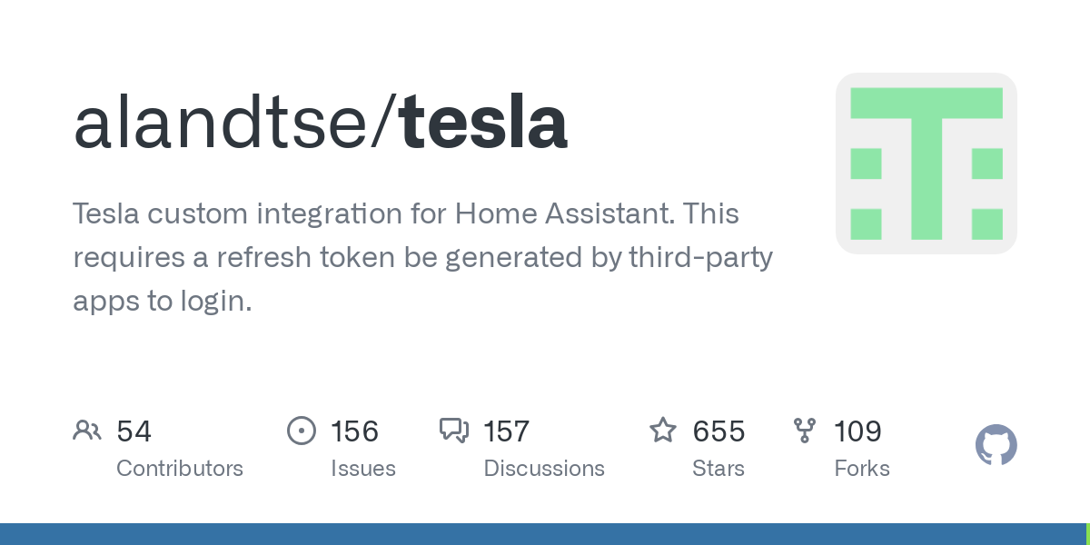

I use this custom integration: GitHub - alandtse/tesla: Tesla custom integration for Home Assistant. This requires a refresh token be generated by third-party apps to login.

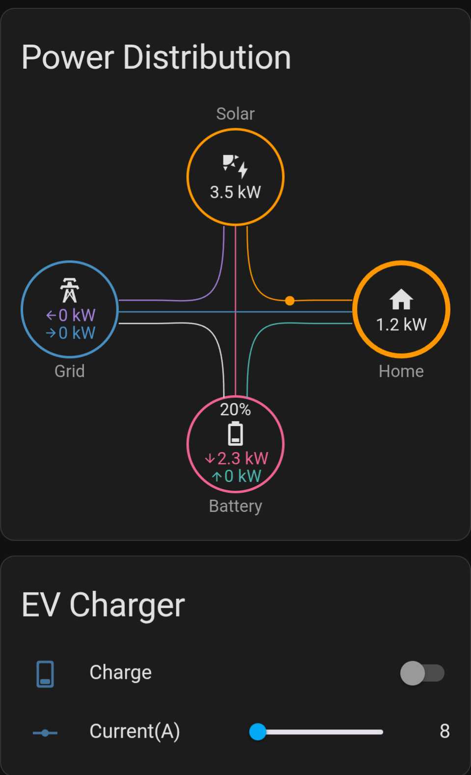

We have a 23kw solar system and I was able to do manage the charging via local tuya using a grecell charger. My automations set charging current to prevent the inverter from exceeding its limit and also limiting charging current so that the solar power is split between the house and car battery instead of having the house battery charge the car battery.

I use it to control solar energy consumption as a means to avoid exporting power. I do this by controling the car locally via Bluetooth using this - GitHub - tesla-local-control/tesla_ble_mqtt_docker but also I run this Blueprint - GitHub - flashg1/evSolarCharger: Home Assistant Blueprint using OCPP and/or EV specific API to charge EV from surplus solar and weather forecast..
