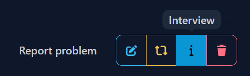

Did you update the thermostat firmware via OTA as soon as you got them by any chance? If so, read this.
Apparently you need to click Interview (the i icon in the picture below) for these devices after a firmware update. According to one post, ideally you should cut/restore power to the thermostat before doing an interview + reconfigure to ensure that it works.
@ShadowFist oh, wow - I totally missed that github thread - thanks!
I had updated all the FW after I noticed the reporting issue (I had also noticed the genOnOff error… but ignored in favor of firmware update…). Anyway, I just power-cycled them all. Reconfigure was failing with the genOnOff error still, but if I did the Interview first, Reconfigure ran without errors. So, fingers-crossed this is all working now!
