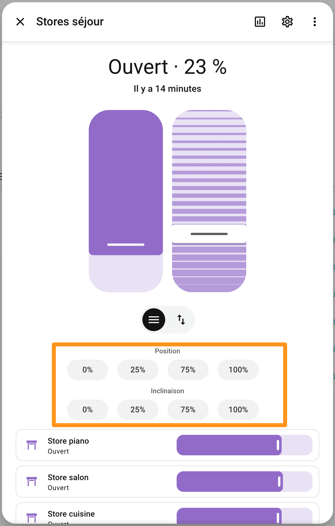

Now my first and most important question: I created a group of devices that has my 3 living room blinds as a whole, allowing me to work on all of them "at once". This shows me nice buttons in the dashboard:
Changing the position of the group works fine since the blinds get their new position and move asynchronously.
Changing the tilt of the group however fails. My dedicated script script.set_cover_position_and_tilt is supposed to take 1 single cover as argument (+position and tilt) and play with 1-3 changes of position until the end state is reached. It does that synchronously and is not configured to be invoked a second time if still running. And that's where the problem lies imho, only 1 out of the 3 blinds is moved to new tilt position.
Q1: Should I allow the script to be run multiple times to fix that issue of the group of covers not working, should I instead rework the script to allow a group of cover to be passed as parameter and then loop over the children? If so, how to detect that's a group and not a single cover? Or is there another way?
Q2: UI question: when I have a group of covers, and just throw the entity into my dashboard, I get name of the group, up/stop/down buttons, just like my (templated) covers. But the more info action shows additional helper buttons to change the position to 0%, 25%, 75% or 100% and the same for the tilt. I miss that for my templated covers. Which setting am I supposed to use?

There's no way customizing the more-info popup, thus my other questions make little sense. Only way I found to get the preset position/tilt would be to create a group out of a single cover, that should logically work. Not that pretty, but would logically work.
But instead I'll go another way and try to get my dashboard show directly those little presets, without having to open the complete more-info popup, as this will be much more UX friendly in the end.
