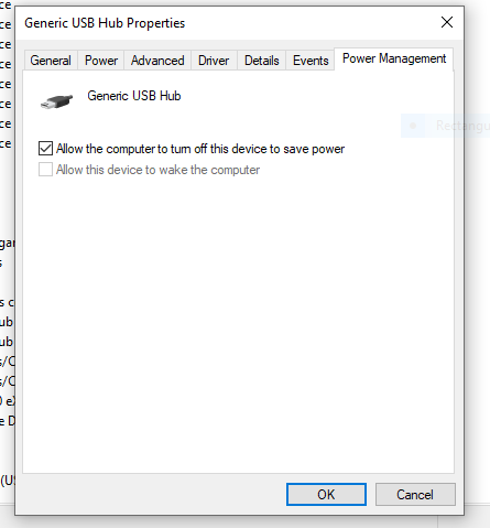

How Familiar are you with windows ?
Do you know Device-Manager ?
What are the “Settings” for the various USB-Ports ?
All Generic Usb Hubs & All USB Root Hubs have this set by Default ! :wink:
NOTE: I don’t say this Is Your Issue, , im just saying Microsoft does what they want with your machine, if you don’t know howto “control” it
