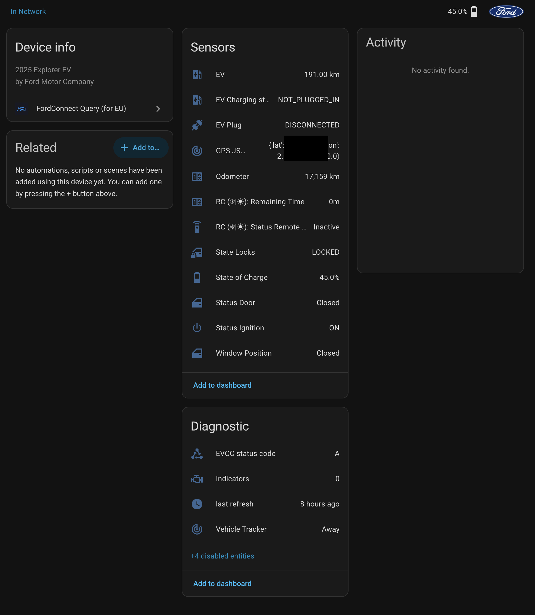

Hello All, first thank you @marq24 for this integration.
i successfully installed and configured this integration. I see some sensors, but it looks like i am missing a lot more, e.g. tire pressure and others mentioned in the github repository. I've attached a screenshot of what i do see. Any suggestions would be greatly appreciated.
cheers
Alon
if you need help/support, create a issue @ github and provide debug log output from the integration - TIA
