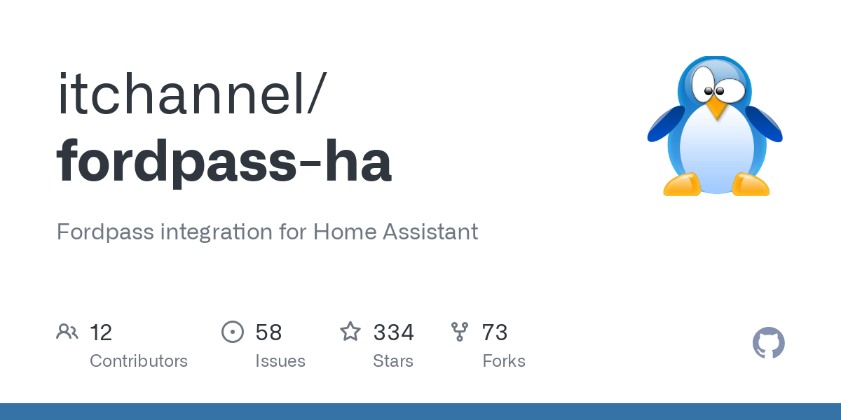

Just making sure: you are installing from this repo: GitHub - itchannel/fordpass-ha: Fordpass integration for Home Assistant
and installed 1.80 beta4 ?
and then followed instruction how to obtain an API token?

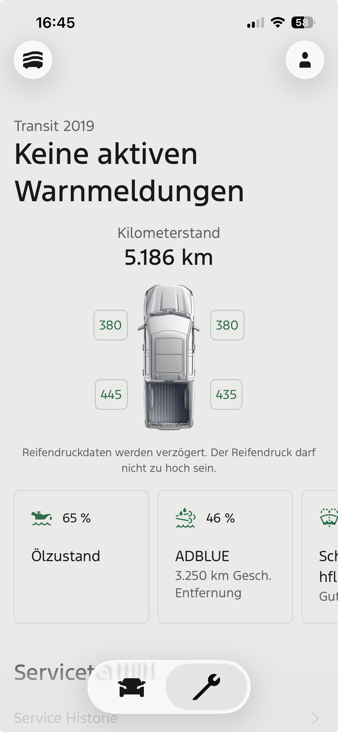

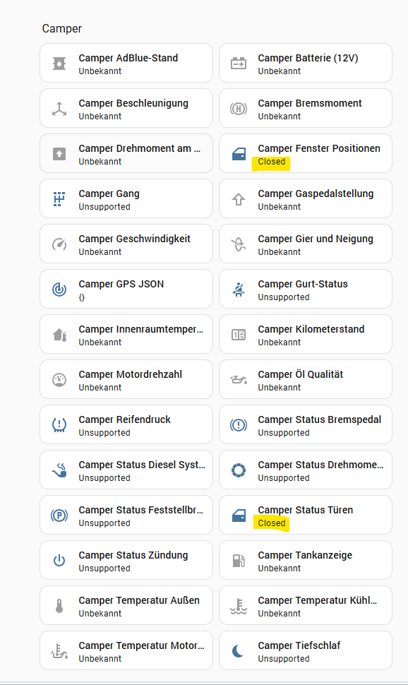

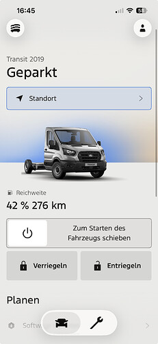

i have a ford Transit 2024, i use the Ford pass Integration, but the only supported features are the Doors and Window, which seems strange, in the Ford Pass app i see more Details. Someone was able to inetgrate a Ford Transit?
Ford Pass App:
Best regards
Philipp
