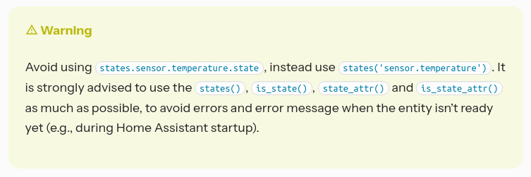

Explanation of how to get the `repeat` variable to work
Use the states() function not the state object method… the following warning has been in the docs for 5+ years:
HA Doc - Building Templates - States
Instead of …
condition: template
value_template: >-
  {{ states.repeat.state ==
  states.input_text.d2_expectedstatestr.state }}
#and
{{ states.repeat.state }}
Use:
condition: template
value_template: >-
  {{ is_state(repeat.item, states('input_text.d2_expectedstatestr')) }}
#and
{{ states(repeat.item) }}
FWIW, if for some reason you needed to use the state object method, you can do so by using bracket notation as follows:
{{ states[repeat.item].state }}
But this is unnecessary and not recommended for your use case.

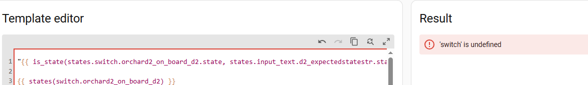

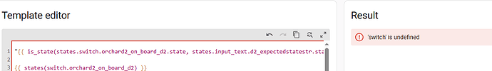

yes I read the warning and before what I had posted I tried using
{{ states(switch.orchard2_on_board_d2) }}
in the developer template this gives undefined switch
where as {{ states.switch.orchard2_on_board_d2.state }} works in the developer template and since its just a warning… I continued on
