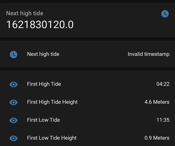

and this displays:
Do you understand why it says invalid timestamp in an entities card?

I can see why you’re confused. The device class of timestamp assumes it’s formatted in the ISO format, not a Unix timestamp as epoch seconds.
Use this:
  • Filter timestamp_utc converts a UNIX timestamp to its string representation representation as date/time in UTC timezone.
Or the _local variant if needed.
Also check the warning in the docs.

{{ ((now()|string)[:11] + firsthigh) | as_timestamp | timestamp_local }}
