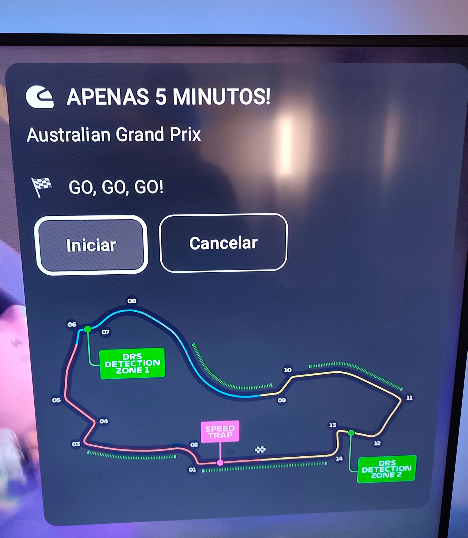

On the TV i set a popup
Strange, any errors?
That’s brilliant, how did you do that?
Agreed, I’d love to know
I use QuickBars for Home Assistant - instant HA controls over any app on Android TV
Never heard about it, need to check it out :smile:

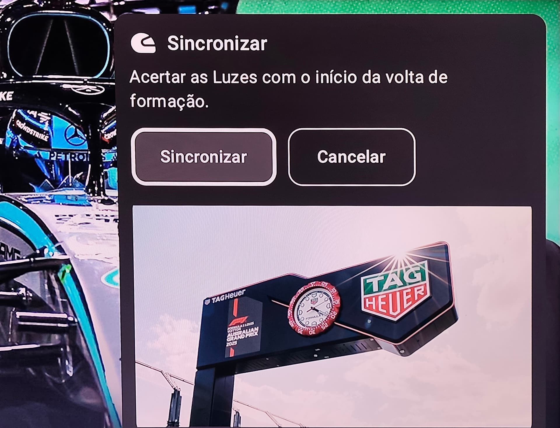

Can you explain how you call the card and how its functionality works (if you can share code, that would be great)?
I haven’t tried this yet, but I’m planning to trigger an automation 30 seconds or less before the race start (using calendar.f1) to call a blueprint that displays a TV popup with a ‘sync’ button
use_blueprint:
  path: Trooped/notification.yaml
  input:
    action_1_action:
      - action: button.press
        metadata: {}
          entity_id: button.f1_match_live_delay
        data: {}
    action_1_id: Sincronizar
    action_1_label: Sincronizar
    action_2_label: Cancelar
    mdi_icon: mdi:racing-helmet
    title: "Sincronizar "
    message: Acertar as Luzes com o início da volta de formação.
    action_2_id: Cancelar
    position: top_right
    length: 300
    image_url: www/server/f1relogio.jpg
    transparency: 0
alias: Sincronizar F1 com as Luzes
description: ""
I have this to
