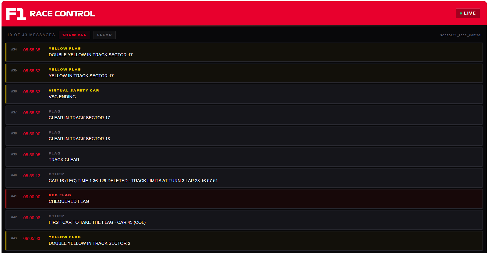

For the team here is my latest and updated “Race Control Message Board” this version will display a default of the last 10 messages, with a counter at the top let stating how many session messages are in total and a toggle to display all session messages if you want to review the post session messages. Added a clear button to clear ONLY the board messages and leaves the sensor history untouched.
I created a new dashboard view and select the “Panel (single card)” option, then add any of the available card options (or add a manual card), select the edit in yaml at the bottom left and then paste in the below code:
type: custom:html-template-card
ignore_line_breaks: true
content: >
  <style>
    @keyframes f1-pulse{0%,100%{opacity:1;transform:scale(1)}50%{opacity:0.3;transform:scale(0.6)}}
    #rc-toggle{display:none;}
    #rc-clear{display:none;}
    #rc-extra-msgs{display:none;flex-direction:column;gap:5px;padding:0 12px 5px 12px;}
    #rc-toggle:checked ~ #rc-card #rc-extra-msgs{display:flex;}
    #rc-toggle:checked ~ #rc-card #rc-btn-show{display:none;}
    #rc-toggle:checked ~ #rc-card #rc-btn-hide{display:inline-block;}
    #rc-btn-hide{display:none;}
    #rc-clear:checked ~ #rc-card #rc-messages{display:none;}
    #rc-clear:checked ~ #rc-card #rc-cleared-msg{display:block;}
    #rc-clear:checked ~ #rc-card #rc-btn-show{display:none;}
    #rc-clear:checked ~ #rc-card #rc-btn-hide{display:none;}
    #rc-clear:checked ~ #rc-card #rc-btn-clear{display:none;}
    #rc-cleared-msg{display:none;}
  </style>
  {% set raw          = states('sensor.f1_race_control') %}
  {% set msgs = state_attr('sensor.f1_race_control', 'history') or [] %}
  {% set session      = states('sensor.f1_session_status') | lower %}
  {% set session_name = states('sensor.f1_current_session') %}
  {% set meeting_name = state_attr('sensor.f1_session_status', 'meeting_name') | default('') %}
  {% set location     = state_attr('sensor.f1_session_status', 'meeting_location') | default('') %}
  {% set country      = state_attr('sensor.f1_session_status', 'meeting_country') | default('') %}
  {% set circuit      = state_attr('sensor.f1_session_status', 'circuit_short_name') | default('') %}
  {% set sorted_msgs  = msgs | sort(attribute='utc') %}
  {% set total        = sorted_msgs | length %}
  {% set limit        = 10 %}
  {% set show_session = session_name not in ['unknown', 'unavailable', 'none', ''] %}
  {% if session == 'live' %}
    {% set badge_color  = '#00FF88' %}
    {% set badge_bg     = 'rgba(0,0,0,0.3)' %}
    {% set badge_border = 'rgba(255,255,255,0.3)' %}
    {% set badge_text   = '#FFFFFF' %}
    {% set badge_label  = 'LIVE' %}
    {% set dot_anim     = 'animation:f1-pulse 1.4s ease-in-out infinite;' %}
    {% set name_opacity = '1' %}
  {% elif session == 'suspended' %}
    {% set badge_color  = '#FFD700' %}
    {% set badge_bg     = 'rgba(255,215,0,0.1)' %}
    {% set badge_border = 'rgba(255,215,0,0.4)' %}
    {% set badge_text   = '#FFD700' %}
    {% set badge_label  = 'SUSPENDED' %}
    {% set dot_anim     = 'animation:f1-pulse 2s ease-in-out infinite;' %}
    {% set name_opacity = '0.6' %}
  {% elif session == 'break' %}
    {% set badge_color  = '#FF8000' %}
    {% set badge_bg     = 'rgba(255,128,0,0.1)' %}
    {% set badge_border = 'rgba(255,128,0,0.4)' %}
    {% set badge_text   = '#FF8000' %}
    {% set badge_label  = 'BREAK' %}
    {% set dot_anim     = '' %}
  {% elif session == 'pre' %}
    {% set badge_color  = '#4488FF' %}
    {% set badge_bg     = 'rgba(68,136,255,0.1)' %}
    {% set badge_border = 'rgba(68,136,255,0.4)' %}
    {% set badge_text   = '#4488FF' %}
    {% set badge_label  = 'PRE-SESSION' %}
  {% elif session in ['finished', 'finalised', 'ended'] %}
    {% set badge_color  = '#444455' %}
    {% set badge_bg     = 'rgba(0,0,0,0.2)' %}
    {% set badge_border = 'rgba(255,255,255,0.1)' %}
    {% set badge_text   = '#606070' %}
    {% set badge_label  = session | upper %}
    {% set name_opacity = '0.4' %}
  {% else %}
    {% set badge_label  = session | upper if session else 'OFFLINE' %}
  {% endif %}
  <input type="checkbox" id="rc-toggle">
  <input type="checkbox" id="rc-clear">
  <div id="rc-card" style="background:#08080A;border-radius:8px;overflow:hidden;padding-bottom:16px;font-family:'F1Regular',sans-serif;">
    <div style="background:#E8002D;display:flex;align-items:center;gap:16px;padding:12px 20px 12px 16px;margin-bottom:0;">
      <div style="display:flex;flex-direction:column;align-items:center;justify-content:center;flex-shrink:0;width:52px;">
        <div style="font-family:'F1Bold',sans-serif;font-size:48px;line-height:1;color:#fff;letter-spacing:-1px;">F<span style="color:#fff;">1</span></div>
      </div>
      <div style="flex:1;display:flex;flex-direction:column;gap:2px;">
        <div style="display:flex;align-items:baseline;gap:10px;">
          <div style="font-family:'F1Bold',sans-serif;font-size:22px;color:#ffffff;line-height:1;text-shadow:0 2px 4px rgba(0,0,0,0.3);">RACE CONTROL</div>
          {% if show_session %}
          <div style="font-family:'F1Bold',sans-serif;font-size:11px;letter-spacing:2px;color:rgba(255,255,255,0.6);text-transform:uppercase;white-space:nowrap;">{{ session_name | upper }}</div>
          {% endif %}
        </div>
        {% if meeting_name %}
        <div style="font-family:'F1Wide',sans-serif;font-size:12px;color:rgba(255,255,255,{{ name_opacity }});line-height:1.3;letter-spacing:0.5px;">{{ meeting_name }}</div>
        {% endif %}
        {% if location or country %}
        <div style="font-family:'F1Regular',sans-serif;font-size:11px;color:rgba(255,255,255,0.65);line-height:1.2;letter-spacing:0.3px;">{{ circuit if circuit else '' }}{% if circuit and (location or country) %} ¡ {% endif %}{{ location if location else country }}</div>
        {% endif %}
      </div>
      <div style="display:flex;align-items:center;gap:6px;background:{{ badge_bg }};border:1px solid {{ badge_border }};border-radius:2px;padding:5px 11px;flex-shrink:0;">
        <div style="width:7px;height:7px;border-radius:50%;background:{{ badge_color }};flex-shrink:0;{{ dot_anim }}"></div>
        <span style="font-family:'F1Bold',sans-serif;font-size:11px;letter-spacing:2px;color:{{ badge_text }};">{{ badge_label }}</span>
      </div>
    </div>
    <div style="height:3px;background:linear-gradient(90deg,#E8002D,rgba(255,107,107,0.27),transparent);margin-bottom:14px;"></div>
    <div style="display:flex;justify-content:space-between;align-items:center;padding:0 16px 10px;">
      <div style="display:flex;align-items:center;gap:10px;">
        <span style="font-family:'F1Regular',sans-serif;font-size:11px;letter-spacing:2px;text-transform:uppercase;color:#606070;">
          {% if raw == 'unavailable' %}LAST SESSION ¡ {% endif %}{{ [total, limit] | min }} of {{ total }} message{% if total != 1 %}s{% endif %}
        </span>
        {% if total > limit %}
        <label id="rc-btn-show" for="rc-toggle" style="font-family:'F1Bold',sans-serif;font-size:9px;letter-spacing:2px;text-transform:uppercase;color:#E8002D;background:rgba(232,0,45,0.08);border:1px solid rgba(232,0,45,0.3);border-radius:2px;padding:4px 10px;cursor:pointer;">SHOW ALL</label>
        <label id="rc-btn-hide" for="rc-toggle" style="font-family:'F1Bold',sans-serif;font-size:9px;letter-spacing:2px;text-transform:uppercase;color:#E8002D;background:rgba(232,0,45,0.08);border:1px solid rgba(232,0,45,0.3);border-radius:2px;padding:4px 10px;cursor:pointer;">SHOW LATEST</label>
        {% endif %}
        {% if total > 0 %}
        <label id="rc-btn-clear" for="rc-clear" style="font-family:'F1Bold',sans-serif;font-size:9px;letter-spacing:2px;text-transform:uppercase;color:#606070;background:rgba(255,255,255,0.04);border:1px solid rgba(255,255,255,0.1);border-radius:2px;padding:4px 10px;cursor:pointer;">CLEAR</label>
        {% endif %}
      </div>
    </div>
    {% if raw == 'unknown' and total == 0 %}
      <div style="margin:12px;background:rgba(232,0,45,0.08);border:1px solid rgba(232,0,45,0.3);border-radius:2px;padding:14px 18px;font-family:'F1Regular',sans-serif;font-size:13px;letter-spacing:1px;color:#FF6B6B;">
        🏁 Awaiting race control transmissions
      </div>
    {% elif total == 0 %}
      <div style="text-align:center;padding:48px 20px;font-family:'F1Regular',sans-serif;letter-spacing:3px;text-transform:uppercase;font-size:14px;color:#2A2A32;">
      </div>
    {% else %}
      <div id="rc-cleared-msg" style="text-align:center;padding:48px 20px;font-family:'F1Regular',sans-serif;letter-spacing:3px;text-transform:uppercase;font-size:14px;color:#2A2A32;">
        🏁 Board cleared
      </div>
      <div id="rc-messages">
        {% macro render_msg(msg, idx) %}
          {% set txt      = msg.message | default('') %}
          {% set ts       = msg.utc | default('') %}
          {% set category = msg.category | default('') %}
          {% set flag     = msg.flag | default('') | upper %}
          {% set tu       = txt | upper %}
          {% if flag == 'RED' or 'RED FLAG' in tu %}
            {% set bcolor = '#FF2222' %} {% set cat_label = 'Red Flag' %} {% set cat_color = '#FF4444' %} {% set bg = 'rgba(255,0,0,0.06)' %}
          {% elif flag == 'YELLOW' or ('YELLOW' in tu and 'GREEN' not in tu) %}
            {% set bcolor = '#FFD700' %} {% set cat_label = 'Yellow Flag' %} {% set cat_color = '#FFD700' %} {% set bg = 'rgba(255,215,0,0.04)' %}
          {% elif flag == 'GREEN' or 'GREEN' in tu %}
            {% set bcolor = '#00D2BE' %} {% set cat_label = 'Green Flag' %} {% set cat_color = '#00D2BE' %} {% set bg = '#15151A' %}
          {% elif 'SAFETY CAR' in tu %}
            {% set bcolor = '#FFD700' %} {% set cat_label = 'Safety Car' %} {% set cat_color = '#FFD700' %} {% set bg = '#15151A' %}
          {% elif 'VIRTUAL SAFETY' in tu or 'VSC' in tu %}
            {% set bcolor = '#FFD700' %} {% set cat_label = 'Virtual Safety Car' %} {% set cat_color = '#FFD700' %} {% set bg = '#15151A' %}
          {% elif 'DRS' in tu %}
            {% set bcolor = '#00D2BE' %} {% set cat_label = 'DRS' %} {% set cat_color = '#00D2BE' %} {% set bg = '#15151A' %}
          {% elif 'PENALTY' in tu or 'DRIVE THROUGH' in tu or 'STOP AND GO' in tu %}
            {% set bcolor = '#FF8000' %} {% set cat_label = 'Penalty' %} {% set cat_color = '#FF8000' %} {% set bg = '#15151A' %}
          {% elif 'INVESTIGATION' in tu or 'STEWARD' in tu or 'NOTED' in tu %}
            {% set bcolor = '#FF8000' %} {% set cat_label = 'Stewards' %} {% set cat_color = '#FF8000' %} {% set bg = '#15151A' %}
          {% elif 'CHEQUERED' in tu or 'SESSION END' in tu or 'RACE END' in tu %}
            {% set bcolor = '#0067FF' %} {% set cat_label = 'Session End' %} {% set cat_color = '#0067FF' %} {% set bg = '#15151A' %}
          {% elif 'OVERTAKE' in tu or 'PIT' in tu or 'RESUME' in tu %}
            {% set bcolor = '#0067FF' %} {% set cat_label = category if category else 'Info' %} {% set cat_color = '#4488FF' %} {% set bg = '#15151A' %}
          {% else %}
            {% set bcolor = '#2A2A32' %} {% set cat_label = category if category else 'Message' %} {% set cat_color = '#606070' %} {% set bg = '#15151A' %}
          {% endif %}
          {% if ts | length >= 19 %}
            {% set time_display = ts[11:19] %}
          {% elif ts | length > 0 %}
            {% set time_display = ts %}
          {% else %}
            {% set time_display = '--:--:--' %}
          {% endif %}
          <div style="background:{{ bg }};border:1px solid #2A2A32;border-left:3px solid {{ bcolor }};border-radius:2px;padding:10px 14px;display:flex;gap:12px;align-items:flex-start;">
            <div style="font-family:'F1Regular',sans-serif;font-weight:700;font-size:10px;color:#606070;min-width:24px;padding-top:2px;">#{{ '%02d' % idx }}</div>
            <div style="font-family:'F1Regular',sans-serif;font-size:13px;color:#E8002D;min-width:64px;white-space:nowrap;padding-top:1px;font-variant-numeric:tabular-nums;">{{ time_display }}</div>
            <div style="flex:1;">
              <div style="font-family:'F1Bold',sans-serif;font-size:9px;letter-spacing:2px;text-transform:uppercase;margin-bottom:2px;color:{{ cat_color }};">{{ cat_label }}</div>
              <div style="font-family:'F1Regular',sans-serif;font-size:13px;color:#FFFFFF;line-height:1.5;">{{ txt }}</div>
            </div>
          </div>
        {% endmacro %}
        <div id="rc-extra-msgs">
          {% for msg in sorted_msgs[:(total - limit)] %}
            {{ render_msg(msg, loop.index) }}
          {% endfor %}
        </div>
        {% endif %}
        <div style="display:flex;flex-direction:column;gap:5px;padding:0 12px;">
          {% for msg in sorted_msgs[-limit:] %}
            {{ render_msg(msg, (total - limit + loop.index) if total > limit else loop.index) }}
          {% endfor %}
        </div>
      </div>
    {% endif %}
  </div>

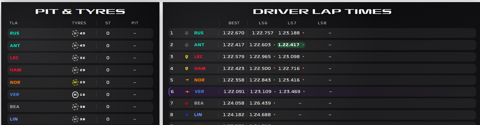

Started making my dashboard. Need to play around with it. I’ve set it up, so it shows slightly different on small (such as mobiles) and larger (tablets, laptops etc) screens to accommodate space. I am using 4.1.0-beta.1 of F1 Sensor, and 1.3.0-beta.1 of F1 Sensor Live Data Card. You also require to have layout-card installed from HACS.
Code is at the bottom
Smaller Screens
Larger Screens
type: custom:layout-card
layout_type: custom:grid-layout
layout:
  grid-template-columns: repeat(12, minmax(0, 1fr))
  grid-template-rows: auto
  grid-gap: 8px
  width: 100%
  max_width: 100%

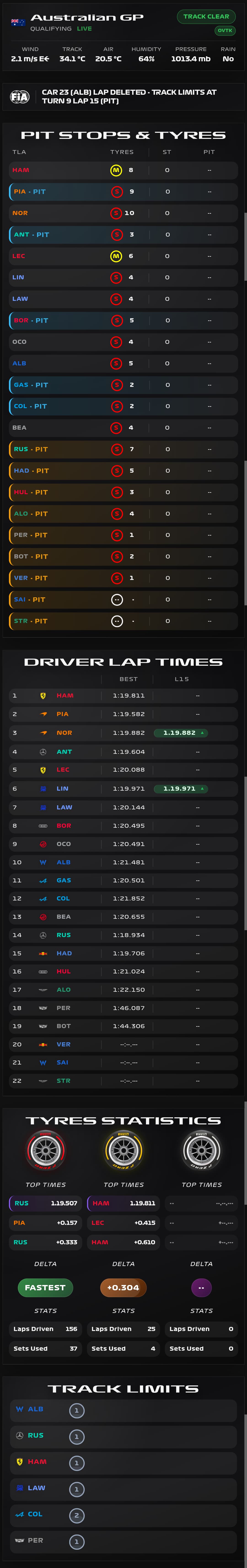

  - show_flag: true
    show_lap_progress: true
    show_track_status: true
    show_weather: true
    show_time_remaining: true
    show_time_elapsed: true
    type: custom:f1-live-session-card
    view_layout:
      grid-area: card1
    session_entity: sensor.f1_current_session
    session_status_entity: sensor.f1_session_status
    formation_start_entity: binary_sensor.f1_formation_start
    lap_count_entity: sensor.f1_race_lap_count
    track_status_entity: sensor.f1_track_status
    next_race_entity: sensor.f1_next_race
    session_time_remaining_entity: sensor.f1_session_session_time_remaining
    session_time_elapsed_entity: sensor.f1_session_session_time_elapsed
    overtake_mode_entity: binary_sensor.f1_session_overtake_mode
    straight_mode_entity: sensor.f1_session_straight_mode
    weather_entity: sensor.f1_track_weather
  - show_fia_logo: true
    min_display_time: 3
    type: custom:f1-race-control-card
    view_layout:
      grid-area: card2
    entity: sensor.f1_race_control
  - type: custom:f1-pitstop-overview-card
    view_layout:
      grid-area: card3
    drivers_entity: sensor.f1_driver_list
    positions_entity: sensor.f1_driver_positions
    tyres_entity: sensor.f1_current_tyres
    pitstops_entity: sensor.f1_pitstops
    title: Pit Stops & Tyres
    show_header: true
    show_table_header: true
    show_tla: true
    show_team_logo: false
    show_status: true
    show_tyre: true
    show_pit_count: true
    show_pit_time: true
    show_pit_lane_time: true
    show_pit_delta: true

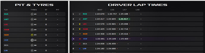

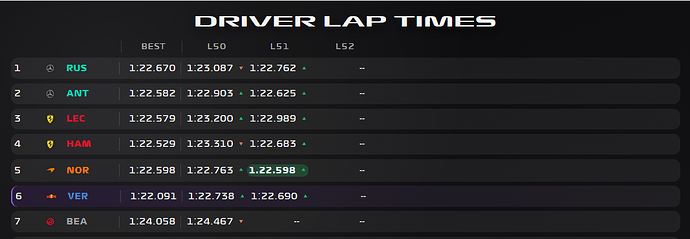

  - type: custom:f1-driver-lap-times-card
    view_layout:
      grid-area: card4
      show:
        mediaquery: "(min-width: 769px)"
    title: Driver Lap Times
    show_lap_history: true
    show_lap_trend: true
    show_best_lap: true
    show_last_lap: false
    show_status: false
    show_tla: true
    show_team_logo: true
    show_header: true
    show_position: true
    lap_history_limit: 3
    view_layout:
      grid-area: card4
      show:
        mediaquery: "(max-width: 768px)"
    show_best_lap: true
    show_status: false
    show_tla: true
    show_header: true
    show_position: true
    lap_history_limit: 1
  - type: custom:f1-sensor-live-data-card
    view_layout:
      grid-area: card5
    entity: sensor.f1_tyre_statistics
    title: Tyres Statistics
    show_tyre_image: true
    show_compound_name: false
    show_best_times: true
    show_stats: true
    show_delta: true
    show_header: true
  - type: custom:f1-track-limits-card
    view_layout:
      grid-area: card6
    track_limits_entity: sensor.f1_track_limits
    title: Track Limits
    show_table_header: false
    show_all_drivers: false

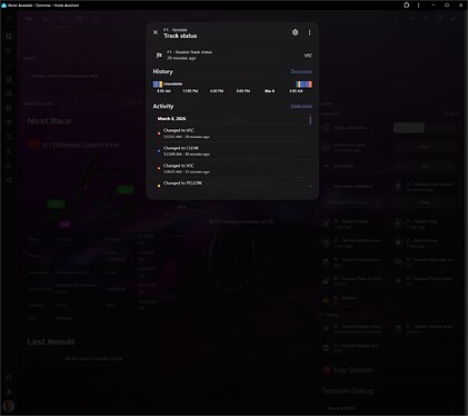

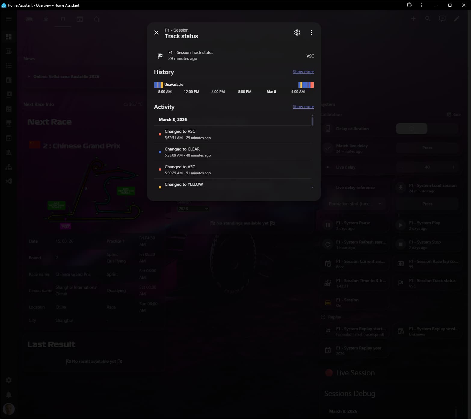

Interesting that track status during quali goes from Red > Clear > Yellow while the session is suspended. Is that just how the data reports from F1?
Probably. The track status is constantly updated during a session which is from the start of Q1 till the end of Q3. If they clear the red flag, but it’s still a yellow, it’ll probably do that. However I don’t know exactly, as I haven’t looked at the API
I dunno why…

here is the same but with a reversed order so the newest message is at the top and the oldeest at the bottom:
content: >
  <style>

C’mon, some feedback - youve got some real time data to work with over the last quarter hour - how is it going?
@Stimo
Great first race!! love the work that you have done to the integration. Coffee has been purchased for your great work.

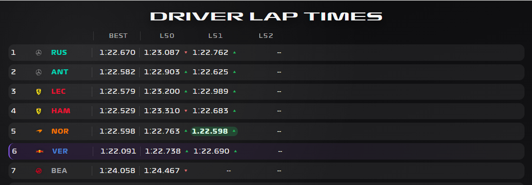

Just one observation on the Driver and Lap card. It currently only shows the lap sector times but not the gap times from each car in front and the leader. Would it be possible to add this to the card? I checked all the F1 sensors for that attribute but couldn’t find it.
Here is the drive card as it appears now:

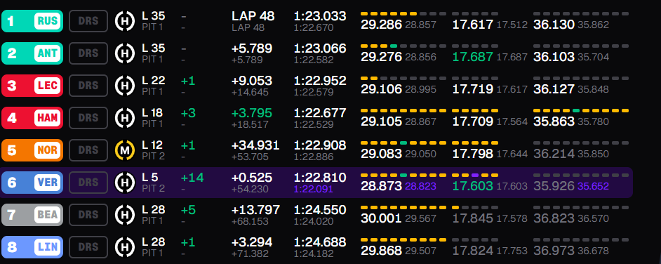

Here is the example from the f1-dash.com/dashboard:

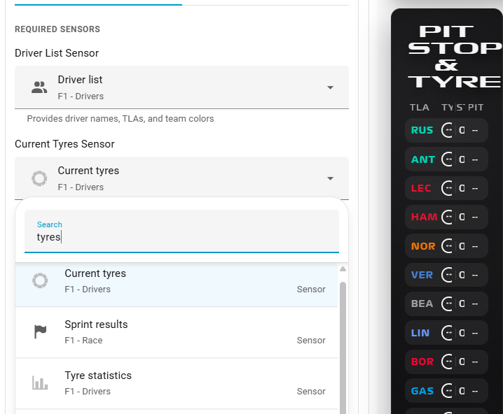

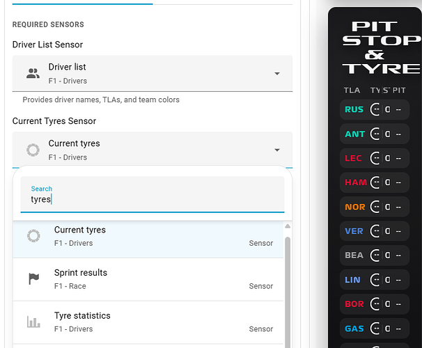

On the tyre statistics, it looks like all the sensors went off line. or is it my set up? I searched for an updated sensor, but couldn’t find any:
I also note that the line height on the Driver & Lap times card is slightly smaller than on the Tyre card, which puts the bottom out of alighment when the two cards are stacked side by side. could you adjust the Driver & Lap times card to be the same line heights so they align?

On that note, would you consider using my Race Control message board to make it in to your integration and match the other F1 integration cards?
First things first, thanks for this awesome integration! I noticed my Session Track status is stuck at VSC since the last VSC.
