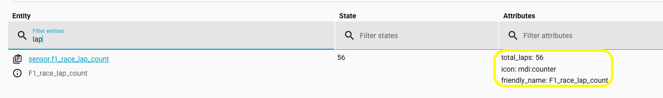

I want to show: Lap [current] of [Total laps] but if I use “F1_race_lap_count” I get the current lap correctly but attribute “Total laps” is “unknown”. Is this a bug or am I doing something wrong? Or is there another sensor I should use?
The integration worked absolutely perfectly for the lighting at our Austin GP watch party today, thank you again for all the work on this.
This isn’t something I can reproduce. What version are you on, and has it always been like this?
I’m on v2.2.2. But don’t get me wrong, let me rephrase my question: F1_race_lap_count provides me with correct “current lap”, but where/how can I get total laps so I can construct e.g. “Lap 12 of 56”?
It is an attribute to the sensor
OK, sorry for the confusion. I thought I used that but something went wrong. I will monitor it next race :slight_smile:

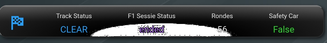

Yesterday i made this tiny f1 card for in overview mode er where ever ya want it
Here it is…

The look depends ofcourse on what themes ya use…
The colors and names changes when states changes…
Example…
Ya see in the code …
