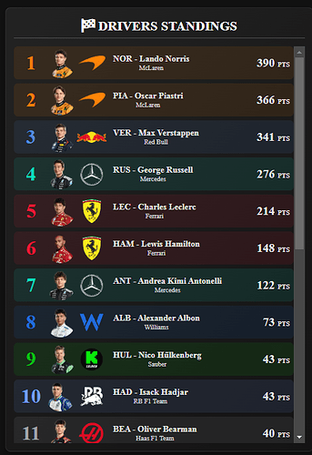

I decided to change the font file’s name to match the existing code, but I’m not certain if I executed these steps properly.
But the font/characters didn’t show up on the card, not on my PC, tablet, or smartphone, even after clearing the cache:
this is from pc:
from smartphone the caractere is different, but not the f1 font
Can anyone tell me where I went wrong?
Thanks
Have you completed steps 4, 5 & 6 from the instructions you quoted (as you don’t mention that in your post)?
Also the font name vs the code in the card may be case sensitive (can’t remember 100%) so you might look at that too as they are different in your code snippets…
Yes, I attempted to add it twice because I was unsure whether to define it as a JavaScript or Stylesheet resource. I have since removed the duplicate entry and only kept the Stylesheet type, and it appears to be working on my phone now. :heart:

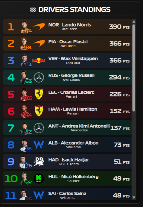

Update on my cards. I made them responsive to phone/tablet use. On my phone the info displayed was incomplete or very crowded. You can adjust it to your liking by modifying the sizes in the //Responsive sizing section.
Also, added driver’s racing number before the team name (way too much info on this card to place it elsewhere, on my opinion)
Drivers standings

Or… I got another crazy idea… Drivers standings with driver’s racing number as a badge on the driver’s headshot…
type: custom:button-card
entity: sensor.f1_driver_standings
show_name: false
show_state: false
show_icon: false
layout: custom
styles:
  grid:
    - grid-template-areas: |
        "header"
        "results"
    - row-gap: 12px
  card:
    - padding: 12px
    - border-radius: 8px
    - background: linear-gradient(135deg, rgba(30, 30, 30, 0.8), rgba(10, 10, 10, 0.8))
    - color: white
    - box-shadow: 0px 4px 10px rgba(0,0,0,0.3)
  custom_fields:
    header:
      - font-size: 20px
      - font-weight: 600
      - text-align: center
      - padding-bottom: 6px
      - border-bottom: 1px solid rgba(255,255,255,0.2)
      - cursor: default
      - font-family: f1regular
    results:
      - font-size: 14px
      - line-height: 1.6
      - display: flex
      - flex-direction: column
      - gap: 6px
      - overflow-y: auto
      - max-height: 600px
custom_fields:
  header: |
      return `
        <div style="width: 100%; text-align: center;">
          <div style="display: inline-flex; align-items: center; gap: 8px;">
            <span style="font-weight: 600; font-family: 'f1regular';">🏁 DRIVERS STANDINGS</span>
          </div>
        </div>
  results: |
      const results = entity.attributes?.driver_standings || [];
      const displayResults = results.slice(0, 25);
      const getDriverData = () => {
        const driverList = states['sensor.f1_driver_list']?.attributes?.drivers || [];
        const dataMap = {};
        driverList.forEach(d => {
          if (d.tla) {
            dataMap[d.tla] = {
              color: d.team_color,
              headshot: d.headshot_small,
              racing_number: d.racing_number
        return dataMap;
      const teamLogos = {
        "Red Bull": "https://media.formula1.com/image/upload/c_lfill,w_48/q_auto/v1740000000/common/f1/2025/redbullracing/2025redbullracinglogo.webp",
        "Ferrari": "https://media.formula1.com/image/upload/c_fit,h_64/q_auto/v1740000000/common/f1/2025/ferrari/2025ferrarilogo.webp",
        "Mercedes": "https://media.formula1.com/image/upload/c_lfill,w_48/q_auto/v1740000000/common/f1/2025/mercedes/2025mercedeslogowhite.webp",
        "McLaren": "https://media.formula1.com/image/upload/c_lfill,w_48/q_auto/v1740000000/common/f1/2025/mclaren/2025mclarenlogo.webp",
        "Aston Martin": "https://media.formula1.com/image/upload/c_fit,h_64/q_auto/v1740000000/common/f1/2025/astonmartin/2025astonmartinlogowhite.webp",
        "Alpine F1 Team": "https://media.formula1.com/image/upload/c_fit,h_64/q_auto/v1740000000/common/f1/2025/alpine/2025alpinelogo.webp",
        "RB F1 Team": "https://media.formula1.com/image/upload/c_fit,h_64/q_auto/v1740000000/common/f1/2025/racingbulls/2025racingbullslogowhite.webp",
        "Haas F1 Team": "https://media.formula1.com/image/upload/c_fit,h_64/q_auto/v1740000000/common/f1/2025/haas/2025haaslogo.webp",
        "Williams": "https://media.formula1.com/image/upload/c_fit,h_64/q_auto/v1740000000/common/f1/2025/williams/2025williamslogo.webp",
        "Sauber": "https://media.formula1.com/image/upload/c_fit,h_64/q_auto/v1740000000/common/f1/2025/kicksauber/2025kicksauberlogo.webp",
      const driverData = getDriverData();
      const FALLBACK_COLOR = '#888';
      const FALLBACK_ICON = 'mdi:racing-helmet';
      const FONT_STYLE = "font-family: 'f1regular';";
      // Detect mobile screen
      const isMobile = window.innerWidth <= 768;
      // Responsive sizing
      const IMG_SIZE = isMobile ? '35px' : '45px';
      const ICON_SIZE = isMobile ? '35px' : '45px';
      const POS_FONT = isMobile ? '24px' : '30px';
      const NAME_FONT = isMobile ? '11px' : '13px';
      const TEAM_FONT = isMobile ? '9px' : '10px';
      const PTS_FONT = isMobile ? '14px' : '18px';
      const PTS_LABEL_FONT = isMobile ? '8px' : '10px';
      const GAP = isMobile ? '4px' : '8px';
      const PADDING = isMobile ? '1px 4px' : '1px 6px';
      const POS_WIDTH = isMobile ? '30px' : '40px';
      const BADGE_FONT = isMobile ? '12px' : '15px';
      return displayResults.map((r, idx) => {
        const pos = r.position;
        const code = r.Driver?.code;
        const name = `${r.Driver?.givenName || ''} ${r.Driver?.familyName || ''}`.trim();
        const team = r.Constructors?.[0]?.name || '';
        const points = r.points || '0';
        const driverSpecificData = driverData[code] || {};
        const color = driverSpecificData.color || FALLBACK_COLOR;
        const teamLogoUrl = teamLogos[team] || '';
        const headshotUrl = driverSpecificData.headshot;
        const racingNumber = driverSpecificData.racing_number || '';
        const bgColor = color.length === 7 ? color + '1A' : color;
        const posTextColor = color === FALLBACK_COLOR ? 'white' : color;
        let headshotTag;
        if (headshotUrl) {
          headshotTag = `
            <div style="position: relative; width: ${IMG_SIZE}; height: ${IMG_SIZE};">
              <img src="${headshotUrl}" style="width: 100%; height: 100%; border-radius: 50%; object-fit: cover;">
              ${racingNumber ? `
                <div style="
                  position: absolute;
                  bottom: -2px;
                  right: -2px;
                  color: ${color};
                  font-size: ${BADGE_FONT};
                  font-weight: 900;
                  text-shadow:
                    -1px -1px 0 #000,
                    1px -1px 0 #000,
                    -1px 1px 0 #000,
                    1px 1px 0 #000,
                    0 0 3px rgba(0,0,0,0.8);
                ">${racingNumber}</div>
            </div>
        } else {
          headshotTag = `
            <div style="
              display: flex;
              justify-content: center;
              width: ${IMG_SIZE};
              border-radius: 50%;
              background: rgba(255, 255, 255, 0);
              line-height: 1;
              <ha-icon icon="${FALLBACK_ICON}" style="--mdc-icon-size: ${ICON_SIZE}; color: ${posTextColor};"></ha-icon>
            </div>
        const logoTag = teamLogoUrl
            ? `<img src="${teamLogoUrl}" style="width: ${IMG_SIZE}; height: auto; max-height: ${ICON_SIZE};">`
        return `
          <div style="
            display: grid;
            grid-template-columns: ${POS_WIDTH} 1fr auto;
            column-gap: 2px;
            background: ${bgColor};
            padding: ${PADDING};
            border-radius: 6px;
            ${FONT_STYLE}
            <div style="
              font-size: ${POS_FONT};
              font-weight: 900;
              text-align: center;
              ${FONT_STYLE}
              ${pos}
            </div>
            <div style="display: flex; align-items: center; gap: ${GAP};">
              <div style="
                display: flex;
                height: 30px;
                gap: 2px;
                padding-right: 2px;
                ${headshotTag}
                ${logoTag}
              </div>
              <div style="display: flex; flex-direction: column; line-height: 1.2;">
                <div style="color: var(--primary-text-color); font-weight: 600; font-size: ${NAME_FONT};">${code} - ${name}</div>
                <div style="font-size: ${TEAM_FONT}; color: rgba(255, 255, 255, 0.8);">${team}</div>
              </div>
            </div>
            <div style="
              font-size: ${PTS_FONT};
              font-weight: 900;
              text-align: right;
              ${FONT_STYLE}
              ${points} <span style="font-size: ${PTS_LABEL_FONT}; font-weight: 600;">PTS</span>
            </div>
          </div>
      }).join('');
I really love your card, amazing job!
This is a great example for the documentation of what you can do with the integration.
If you are up for it, let me know in a PM and we can take it from there.

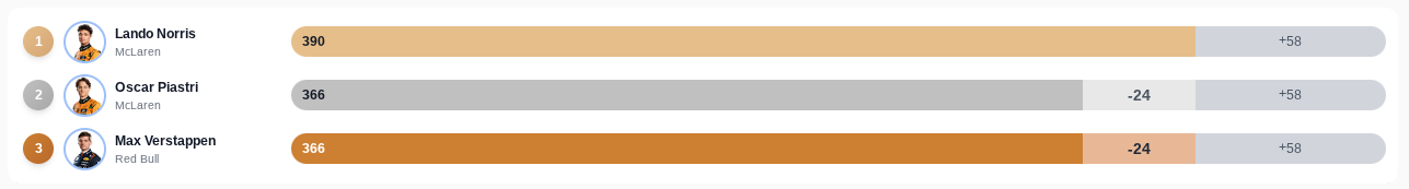

Nice,
Can wait to get realtime track positions and gaps.
This is a card i use on my dashboard, the rest of the F1 dash uses the F1 card.
content: >
  {% set standings = state_attr('sensor.f1_driver_standings',
  'driver_standings') %} {% set p1 = standings[0] %} {% set p2 = standings[1] %}
  {% set p3 = standings[2] %} {% set p1_points = p1.points | int %} {% set
  p2_points = p2.points | int %} {% set p3_points = p3.points | int %}
  {% set current_round = state_attr('sensor.f1_driver_standings', 'round') | int
  %} {% set all_races = state_attr('sensor.f1_current_season', 'races') %}
  {# Bereken nog te behalen punten #} {% set remaining_points =
  namespace(total=0) %} {% for race in all_races %}
    {% if race.round | int > current_round %}
      {% set remaining_points.total = remaining_points.total + 25 %}
      {% if race.Sprint is defined %}
        {% set remaining_points.total = remaining_points.total + 8 %}
      {% endif %}
    {% endif %}
  {% endfor %}
  {% set gap_p2 = p1_points - p2_points %} {% set gap_p3 = p1_points - p3_points
  {# Vaste minimum breedte voor leesbaarheid (4 karakters + spacing) #} {% set
  min_width = 60 %} {% set total_width = 1000 %}
  {# P1 berekening - basis voor alle anderen #} {% set p1_total = p1_points +
  remaining_points.total %} {% set available_p1 = total_width - (2 * min_width)
  %} {% set p1_progress_pct = (p1_points / p1_total * 100) if p1_total > 0 else
  100 %} {% set p1_remaining_pct = (remaining_points.total / p1_total * 100) if
  p1_total > 0 else 0 %}
  {% set p1_progress_width = min_width + ((p1_progress_pct / 100) *
  available_p1) | round(0) %} {% set p1_remaining_width = min_width +
  ((p1_remaining_pct / 100) * available_p1) | round(0) %}
  {# P2 berekening - relatief aan P1 #} {% set p2_remaining_width =
  p1_remaining_width %} {% set available_p2 = total_width - p2_remaining_width
  %} {% set to_distribute_p2 = available_p2 - (2 * min_width) %} {% set p2_ratio
  = (p2_points / p1_points) if p1_points > 0 else 1 %} {% set p2_progress_extra
  = (p2_ratio * to_distribute_p2) | round(0) %} {% set p2_gap_extra =
  to_distribute_p2 - p2_progress_extra %} {% set p2_progress_width = min_width +
  p2_progress_extra %} {% set p2_gap_width = min_width + p2_gap_extra %}
  {# P3 berekening - relatief aan P1 #} {% set p3_remaining_width =
  p1_remaining_width %} {% set available_p3 = total_width - p3_remaining_width
  %} {% set to_distribute_p3 = available_p3 - (2 * min_width) %} {% set p3_ratio
  = (p3_points / p1_points) if p1_points > 0 else 1 %} {% set p3_progress_extra
  = (p3_ratio * to_distribute_p3) | round(0) %} {% set p3_gap_extra =
  to_distribute_p3 - p3_progress_extra %} {% set p3_progress_width = min_width +
  p3_progress_extra %} {% set p3_gap_width = min_width + p3_gap_extra %}
  <div class="bg-white rounded-lg shadow-md overflow-hidden p-4">
    <!-- P1 - Gold -->
    <div class="mb-4">
      <div class="flex items-center gap-3">
        <div class="flex items-center justify-center w-8 h-8 rounded-full text-white font-bold shadow-md text-sm flex-shrink-0" style="background: linear-gradient(135deg, #E6BE8A 0%, #D4A574 100%);">
          1
        </div>
        <img src="{{ state_attr('image.f1_ch1', 'entity_picture') }}"
             class="w-10 h-10 rounded-full object-cover ring-2 flex-shrink-0" style="border-color: #E6BE8A;">
        <div class="flex-shrink-0" style="min-width: 150px;">
          <div class="font-bold text-gray-900 text-sm">{{ p1.Driver.givenName }} {{ p1.Driver.familyName }}</div>
          <div class="text-xs text-gray-500">{{ p1.Constructors[0].name }}</div>
        </div>
        <div class="flex items-center h-8">
          <div class="h-full flex items-center px-3 {% if remaining_points.total == 0 %}rounded-full{% else %}rounded-l-full{% endif %}" style="background-color: #E6BE8A; width: {{ p1_progress_width }}px;">
            <span class="text-gray-900 font-bold text-sm">{{ p1_points }}</span>
          </div>
          {% if remaining_points.total > 0 %}
            <div class="bg-gray-300 h-full flex items-center justify-center rounded-r-full" style="width: {{ p1_remaining_width }}px;">
              <span class="text-gray-600 font-medium text-sm">+{{ remaining_points.total }}</span>
            </div>
          {% endif %}
        </div>
      </div>
    </div>
    <!-- P2 - Silver -->
    <div class="mb-4">
        <div class="flex items-center justify-center w-8 h-8 rounded-full text-white font-bold shadow-md text-sm flex-shrink-0" style="background: linear-gradient(135deg, #C0C0C0 0%, #A8A8A8 100%);">
          2
        </div>
        <img src="{{ state_attr('image.f1_ch2', 'entity_picture') }}"
             class="w-10 h-10 rounded-full object-cover ring-2 flex-shrink-0" style="border-color: #C0C0C0;">
          <div class="font-bold text-gray-900 text-sm">{{ p2.Driver.givenName }} {{ p2.Driver.familyName }}</div>
          <div class="text-xs text-gray-500">{{ p2.Constructors[0].name }}</div>
        </div>
          <div class="h-full flex items-center px-3 rounded-l-full" style="background-color: #C0C0C0; width: {{ p2_progress_width }}px;">
            <span class="text-gray-900 font-bold text-sm">{{ p2_points }}</span>
          </div>
          {% if gap_p2 > 0 %}
            <div class="h-full flex items-center justify-center {% if remaining_points.total == 0 %}rounded-r-full{% endif %}" style="background-color: #E8E8E8; width: {{ p2_gap_width }}px;">
              <span class="text-gray-600 font-bold text-base">-{{ gap_p2 }}</span>
            </div>
          {% endif %}
            <div class="bg-gray-300 h-full flex items-center justify-center rounded-r-full" style="width: {{ p2_remaining_width }}px;">
            </div>
          {% endif %}
        </div>
      </div>
    </div>
    <!-- P3 - Bronze -->
    <div>
        <div class="flex items-center justify-center w-8 h-8 rounded-full text-white font-bold shadow-md text-sm flex-shrink-0" style="background: linear-gradient(135deg, #CD7F32 0%, #B8692A 100%);">
          3
        </div>
        <img src="{{ state_attr('image.f1_ch3', 'entity_picture') }}"
             class="w-10 h-10 rounded-full object-cover ring-2 flex-shrink-0" style="border-color: #CD7F32;">
          <div class="font-bold text-gray-900 text-sm">{{ p3.Driver.givenName }} {{ p3.Driver.familyName }}</div>
          <div class="text-xs text-gray-500">{{ p3.Constructors[0].name }}</div>
        </div>
          <div class="h-full flex items-center px-3 rounded-l-full" style="background-color: #CD7F32; width: {{ p3_progress_width }}px;">
            <span class="text-white font-bold text-sm">{{ p3_points }}</span>
          </div>
          {% if gap_p3 > 0 %}
            <div class="h-full flex items-center justify-center {% if remaining_points.total == 0 %}rounded-r-full{% endif %}" style="background-color: #E8B896; width: {{ p3_gap_width }}px;">
              <span class="text-gray-800 font-bold text-base">-{{ gap_p3 }}</span>
            </div>
          {% endif %}
            <div class="bg-gray-300 h-full flex items-center justify-center rounded-r-full" style="width: {{ p3_remaining_width }}px;">
            </div>
          {% endif %}
        </div>
      </div>
    </div>
  </div>
ignore_line_breaks: true
always_update: false
parse_jinja: true
code_editor: Ace
entities: []
bindings: []
actions: []
debounceChangePeriod: 100
plugins:
  daisyui:
    enabled: true
    url: https://cdn.jsdelivr.net/npm/daisyui@latest/dist/full.css
    theme: dark - dark
    overrideCardBackground: false
  tailwindElements:
    enabled: false
type: custom:tailwindcss-template-card
grid_options:
  columns: full
It’s made with claude so not perfect but works good enough.
