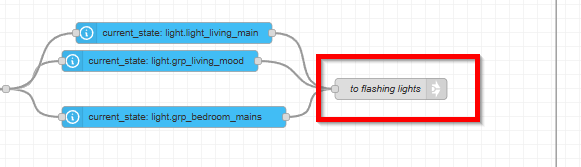

Usage:
  • you have to have a “current state” node for the light you want to target
  • for your settings, you need a “change node” to define the messages for brightness, loop, color and delay

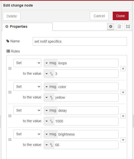

Example of change node:
[{"id":"61606816fabfa160","type":"change","z":"520ea6df5c7e3826","g":"dd05c61da726fb2c","name":"set notif specifics","rules":[{"t":"set","p":"loops","pt":"msg","to":"3","tot":"num"},{"t":"set","p":"color","pt":"msg","to":"yellow","tot":"str"},{"t":"set","p":"delay","pt":"msg","to":"1000","tot":"num"},{"t":"set","p":"brightness","pt":"msg","to":"66","tot":"str"}],"action":"","property":"","from":"","to":"","reg":false,"x":430,"y":2380,"wires":[["ee0ac9f830805ed9"]]}]

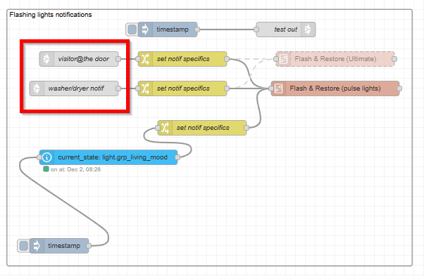

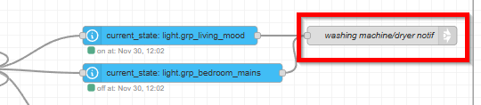

Example of how I have it for multiple notifications (washer/dryer done - flash blue 5 times 250 ms delay, Doorbell - flash orange 5 times 100ms delay etc). Flows that trigger the behavior are across multiple flows (tabs), connected with “link in” and “link out” nodes.
