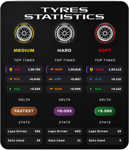

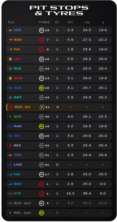

I made a thing…
CleanShot 2026-01-22 at 17.30.46
What do you tink @millercentral , something like this?
Yes. ABSOLUTELY Yes. Amazing.

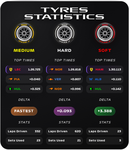

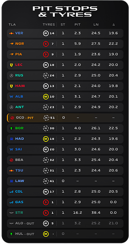

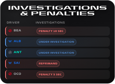

I’d love something clean and modern that shows both the automation side and the new live dashboard cards I’m working on.
I’ve attached a screenshot just to show the upcoming cards and features (not released yet), not as a design reference.
If anyone here enjoys design and would like to contribute a banner, feel free to send me a PM. Any help is really appreciated :slightly_smiling_face:
