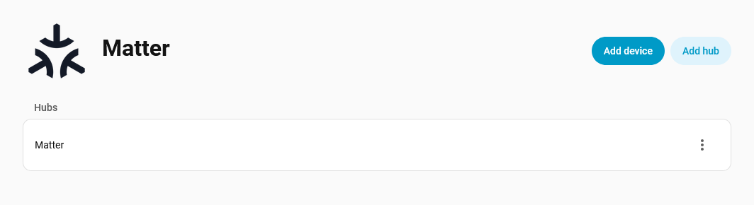

I just wanted to let you know, that the aqara hub is able to expose connected aqara zigbee devices as Matter devices to HA. I just added an aqara mini switch (zigbee only) to the aqara app and it is visible within the HA Matter-Integration:

Assuming you already have the hub connected to HA, these are the steps…
  • In the Aqara app, go the device you want to add
  • Click the 3 dots top right to open settings
  • Under General Gettings click on Hub (should be the M100 hub it is paired with)
  • Scroll down to General Settings, Click “Third-Party Matter Ecosystems”
  • Under Allow Matter Pairing, click “Matter Pairing Code”
  • Copy the pairing code
In the HA App on your phone
  • Go to Matter integration
  • Click Add device
  • Click “No. It’s new”
  • Click “Set up without QR code”
  • Paste in the pairing code you copied from the Aqara app
Thank you, this helped me connect my A100 door lock. It's connected to my hub M3 through Zigbee, but once I connected the hub M3 to home assistant through its matter pairing code, the A100 showed up as a connected device.
