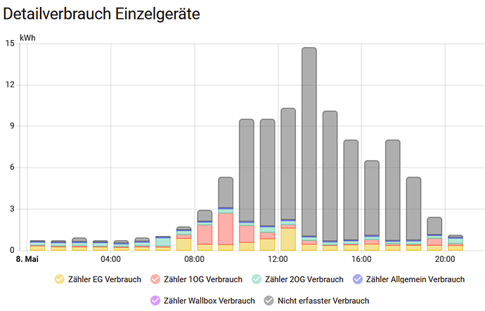

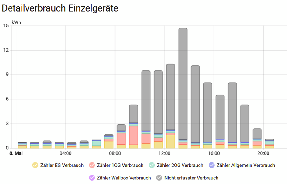

First Problem
Since updating to version 2026.5.0, I no longer see any feed-in. It is displayed as "unrecorded consumption".
The update to 2026.5.1 hasn't solve the problem. Now, i even don't see the "unrecorded consumption" at every hour, sometimes the whole feed in consumption is shown at one hour a day, at different times.

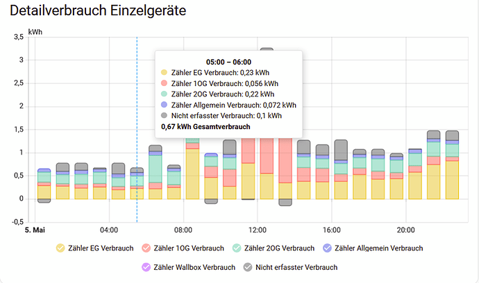

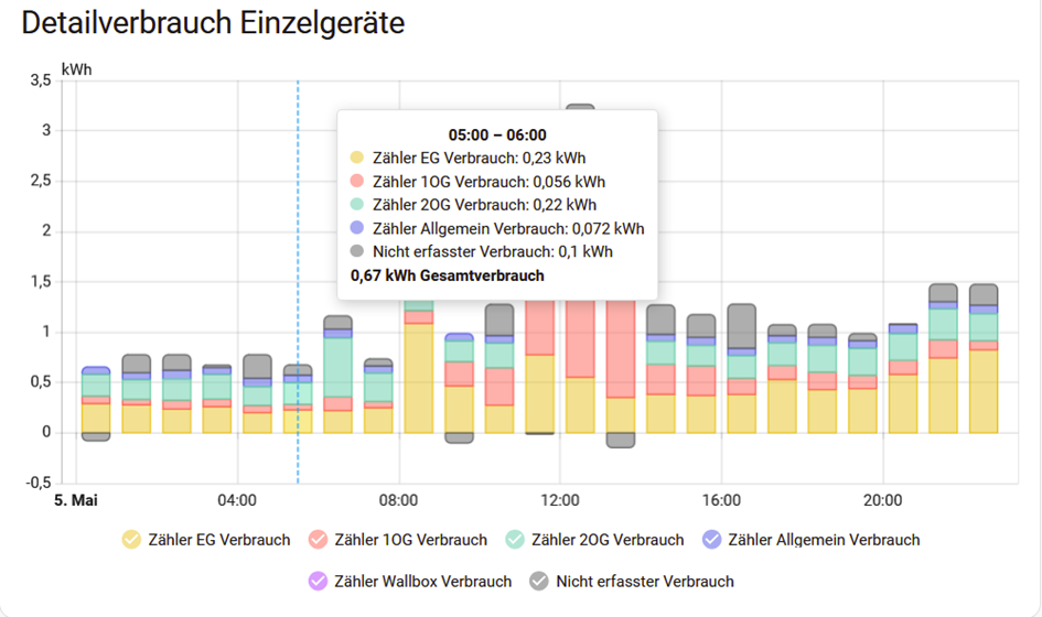

Second Problem
Before the update, I could see the feed-in data, but there was also "unrecorded consumption" listed there, sometimes even with negative values. If the consumption were only positive, I would assume it was consumption by the inverters. But when the values are negative, I have no idea what it could be, other than measurement errors. Does anyone have a better explanation?

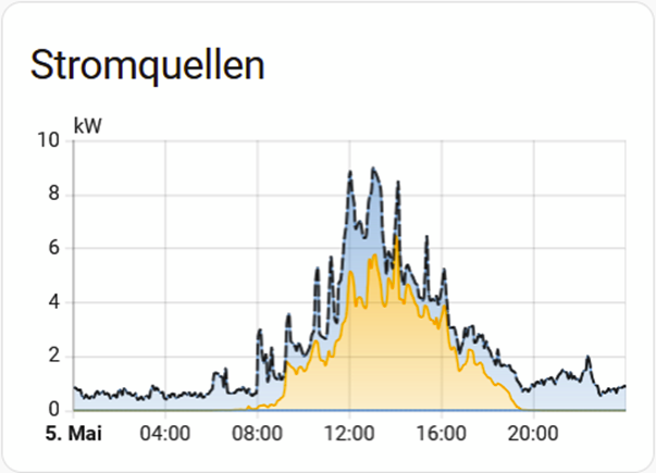

Third Problem
I'm still having trouble getting the current consumption displayed correctly. It's shown "on top" of my PV generation:
As long as there is no PV generation, the values are correct based on consumption. I used the consumption value from the backup port (sensor.total_backup_power_inv2) as the sensor. The Sensor Data ar correct (proofed).
