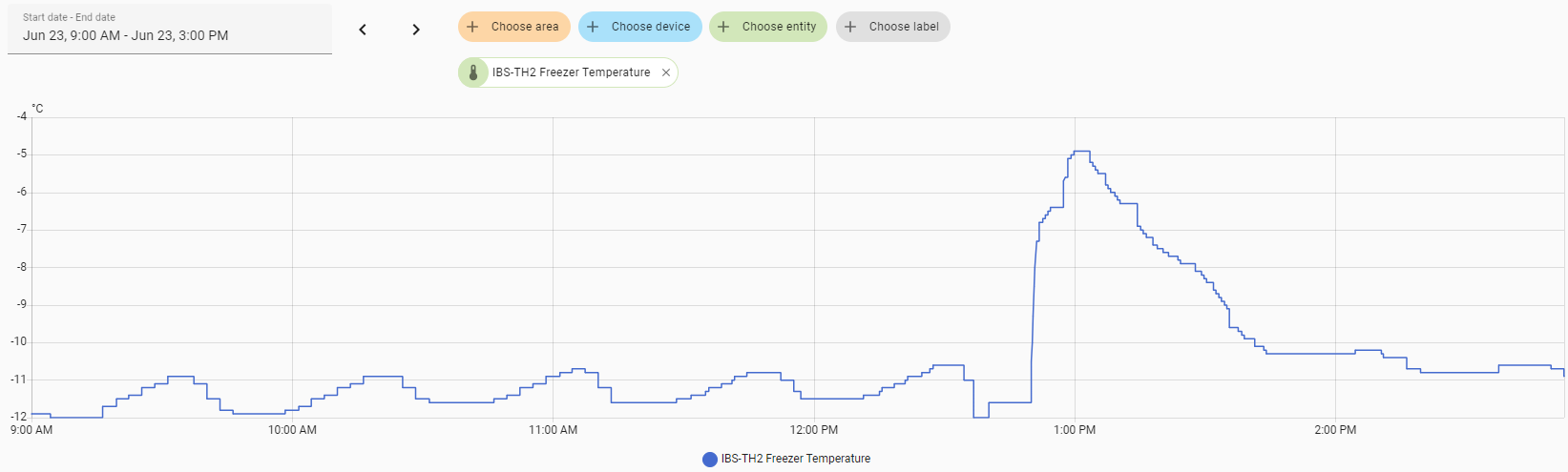

This is an example of some innocuous freezer access.
You can see that it takes nearly an hour to return to fully cold - but everything is ok here, and as soon as it started dropping again I could condition it as not passing on to the alert.

I was thinking a trend sensor, but at the time the sensor crossed -6° the temperature was still increasing, so a trend sensor will not help.

it looks like the trend on the temp was only going up for 10 minutes before it started to recover so the trend sensors should work for that.
