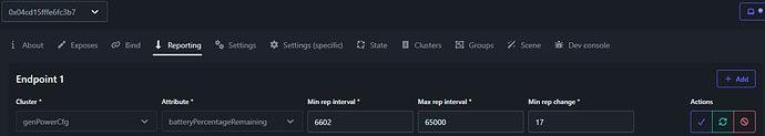

IKEA E1743 was connected recently, I tried changing the Min rep interval, Min rep change parameters on the Reporting tab and Debounces on the Settings tab, updating the firmware of the IKEA button, but this does not affect the device polling frequency.

Some firmware of devices are quirky and despite z2m providing the capability to alter reporting, it’s ultimately up to the device’s firmware. There are a plethora of devices, like IKEA and TuYa, that fall in this category. The good news is that there are several developers on GitHub that have created custom firmware for devices that might address these issues and more, like adding new features. Not all of them are OTA, though. Some require flashing a .bin directly to the board. Here are a few repo’s to check -
