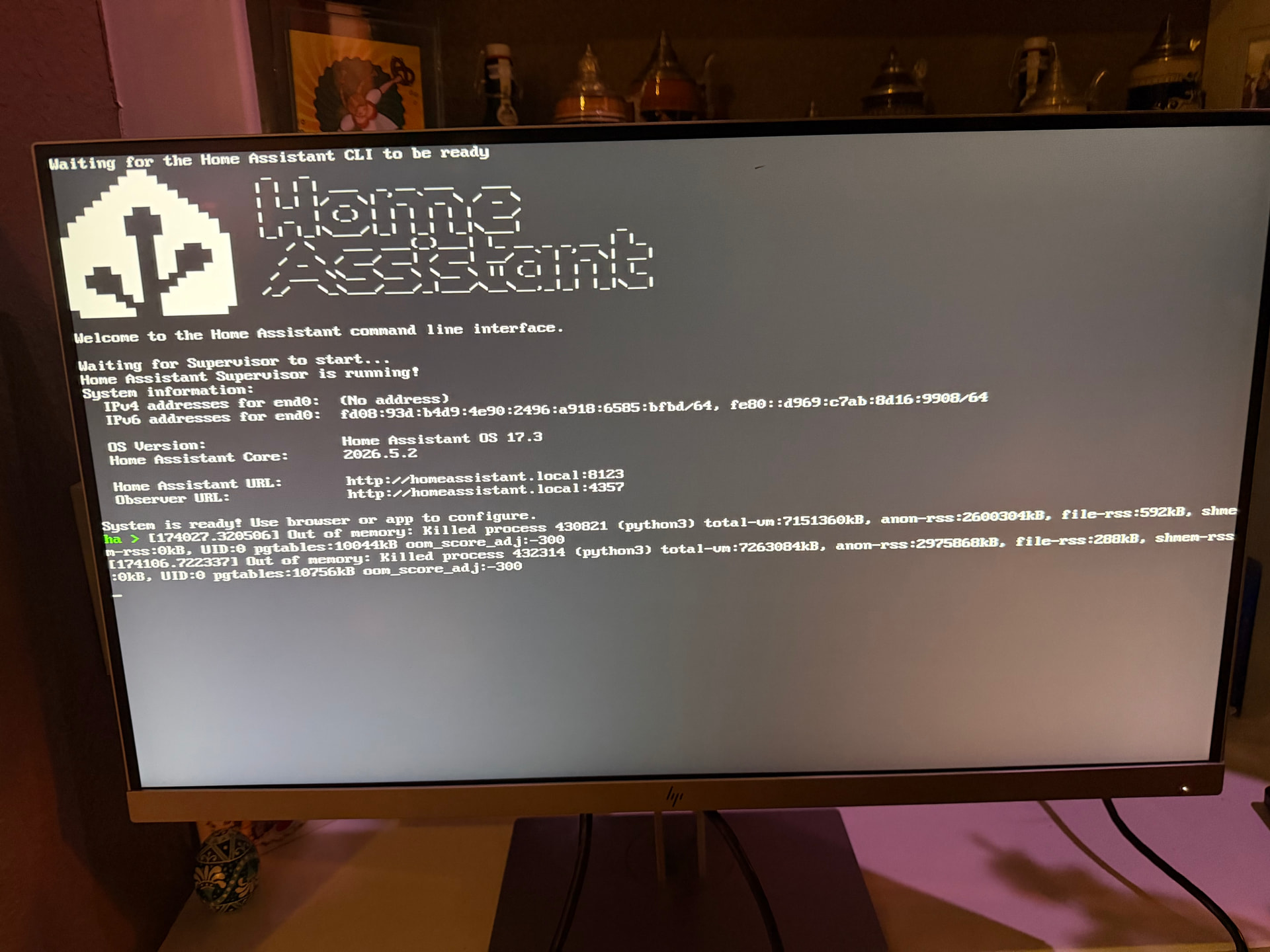

I tried to install the latest update today and I was experiencing repeated reboots immediately.
I clicked to apply 2026.5.4. The update page looked normal and the system rebooted. My system console says I still have 2026.5.2
I had to hard reboot it several times. It seems stable now. I just took a manual backup in case it is a hardware failure. This is a Home Assistant Blue.

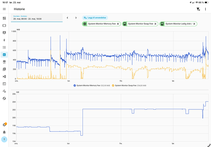

Free RAM has always seemed to be around 20 % as you point out, whereas free swap has been close to zero. In the evening of Wednesday («ons.» in Norwegian) this week, I stopped/removed a few add-ons that weren’t used or useful and both free RAM and free swap increased. I haven’t had an unexpected reboot since.
What I see is that during back-up, free swap drops to (close to) zero, while free RAM increases (somewhat).

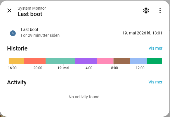

In the plot below you can actually spot the (unexpected) reboots around 5 am, 3 pm and 7 pm (free RAM and free swap spike) on Wednesday. The last spike around 10 pm is a reboot that I initiated after I had thrown out the add-ons I mentioned. (There are another couple of (expected) reboots towards the end of the plot - today on Saturday («lør.») - after I updated core to 2026.5.4 and OS to 17.3.)
So at this point, I’m relatively sure that the culprit was lack of free «memory» (RAM/swap) in some form.
As mentioned, I’m not a Linux wizard, but I have not been able to find anything that raises my eyebrows in the logs (can be due to lack of knowledge what to look for, but still) other than sudden «start-up» type log entries without anything suspicious earlier than that. The lack of any complaints in the log - wouldn’t that also support the hypothesis that the reboot could be caused by the sudden exhaustion of some resource (so sudden that there would not be time to log anything)? I do agree that it could have been the power supply, but since the RPi stopped acting up after I removed some add-ons, I’m inclined to think the power supply is ok.
