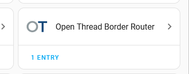

Maybe I should have done a simple question before starting. If the sonoff dongle is correctly flashed and otbr plugin is correctly configured should I see something here? (Sorry for the non english language in the screenshot)
And on another attempt to get something I got another Sonoff Zigbee dongle, just to be sure that it wasn’t something on the hw. Same result also with a new dongle. I am definitely missing something here.

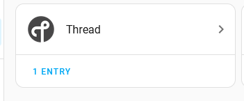

3 parts are needed
1 add-on
2 integrations:
Thank you. All of those are installed and apparently configured (after add-on installation, otbr integrations was already there and thread was discovered and suggested). But I noticed one weird thing during today’s attempts to pair the smartlock. The error message I get on the smartphone always refers to ha-thread-864b. But that’s not my thread network, or at least not now. I’ve restored thread network a couple of times and made the new one my favourite each time. Currently this is the configuration page of thread integration:
I’m more confused than before…
