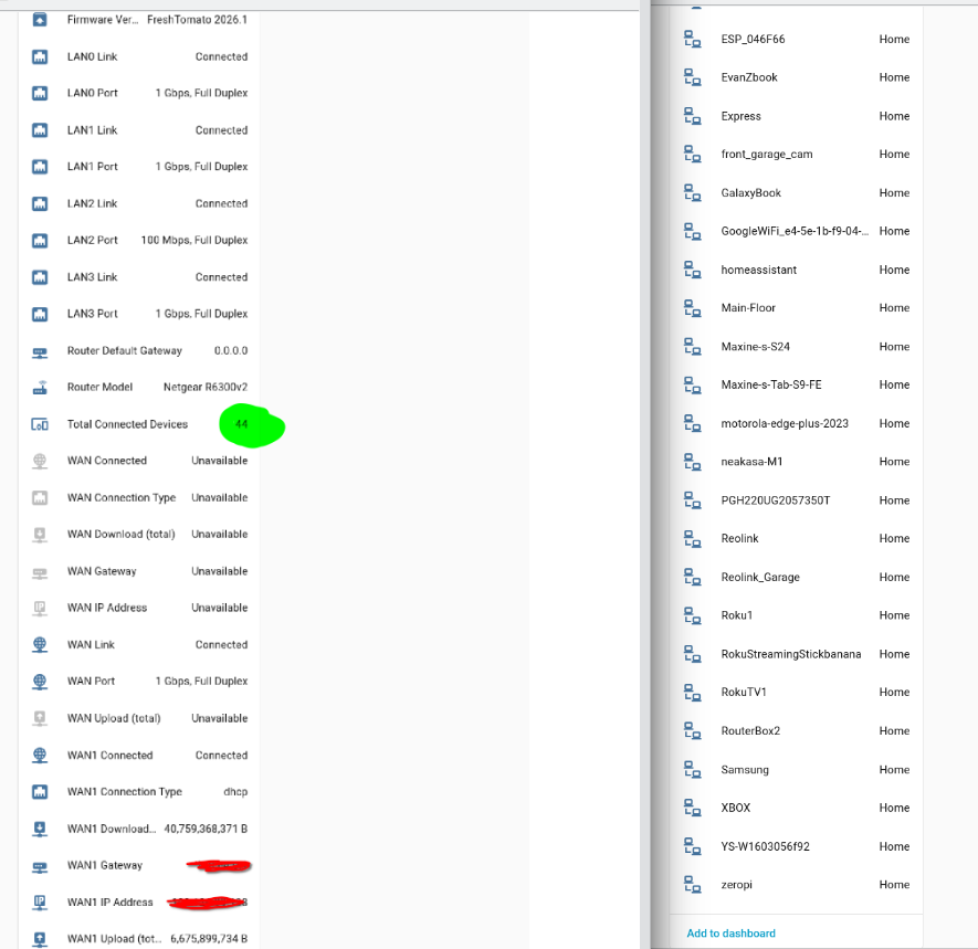

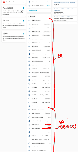

I noticed after playing more, it was reporting less than I thought it was for functioning entities. Things that do work: WiFi SSIDs show correct, IP addresses for br0 and br1 are correct, firmare displays correct, lan port link speeds and connect status is correct, and router model are correct.
Then when it comes to showing total connected devices, as well as wired and wireless connected devices, it shows 0 for all.
Another oddity is that toggling the switches to enable/disable wifi, they don’t actually change wifi state and they toggle back to the state they were at.
I got bold, and just updated my Freshtomato firmware to 2026.1. That did not resolve anything, it is semi functional just as it was before on 2024.5, with no changes.
I believe I captured debug output from the integration, but nothing is showing as any issues in the log.

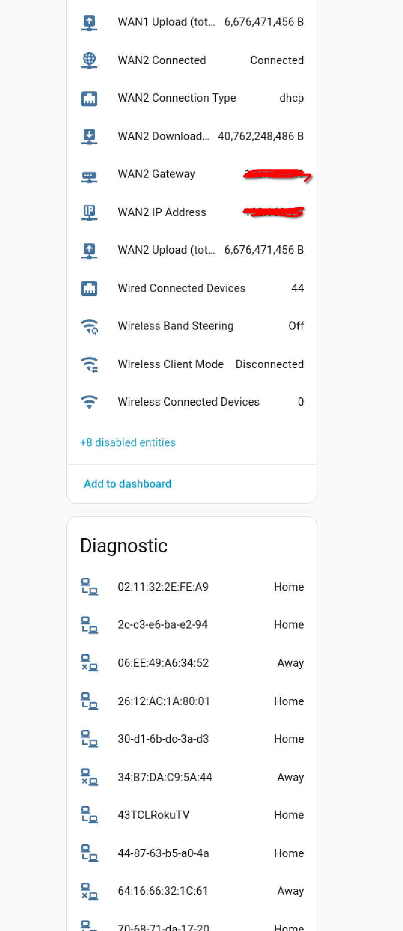

Thanks for the awesome support on your integration! I installed the update, restarted HomeAssistant with logging on, and it is working much better now.
Both Wan1 and Wan2 are captured, and all my network clients are found/shown (before, nothing was found). I use the Freshtomato router in front of a mesh wifi network in access point mode, so FreshTomato assigns all the IPs for everything on network by dhcp, but all clients show as connected by wired connection. It finds clients from a few different vlans and IP address blocks, so no issues there.

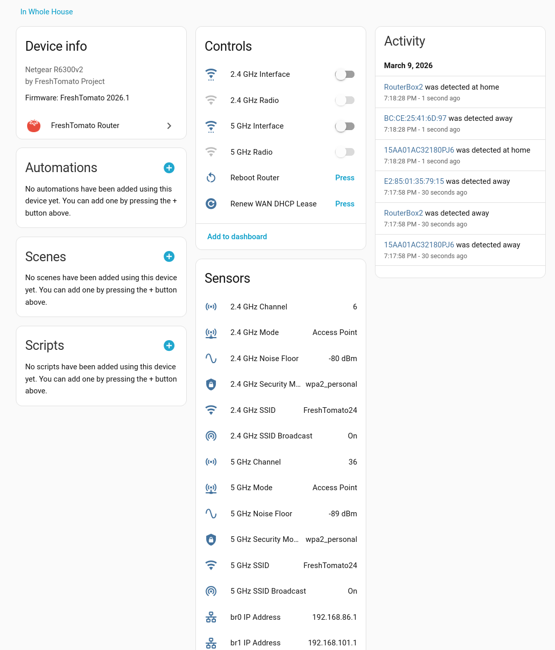

I did enable wireless on the FT router and connect directly wirelessly, and confirm it does properly show wireless client count.
The control of the radios turning on/off isn’t quite working right for me, but it isn’t a functionality I need, as I leave the FT router wireless off all the time and use separate wireless access point controlled separately. When flipping the switches on radios, I get an ‘unable to ssh’ sort of error.
I’m going to play with it a while before uploading the logs, so I can better figure out what does and doesn’t work yet. You are correct, it generates a ton of log data now! If there is a specific function or snip of log data you want me to provide, just let me know. But at this point, it is mostly working perfect for what I’d want out of it.
Here are some updated integration screenshots showing the functionality:
Thanks again!

Another screenshot (as new user I can’t attach multiple):
One more screenshot:

As for the radio buttons, I mentioned that an “alternative” method was pursued, however I did not give more explanation… As turning the WiFi interfaces & radios on/off via API is not fully supported by Fresh Tomato, I followed what is described here, which requires SSH access of HA to the FT router → toggle_radio [FreshTomato Wiki]
In order for the integration to control Radios, SSH access should be enabled on the router and HA should be able to connect to it, using the credentials supplied when setting up the integration (if the port is not forbidden by an intermediate firewall).
The integration currently displays a local message, if this connectivity is not established (there are relevant checks in the code). Furthermore, when toggling the WiFi interface switches, a minimum stale time of 30 sec is set before toggling again, as the router’s wireless driver is restarted in the meantime. If you use WiFi to connect to the router, this driver restart will (temporarily) disconnect SSH as well (since the wireless link will be re-established).
Last but not least (from your screenshots), you can safely delete unavailable/not provided entities shown, as they are leftovers from the previous integration version.

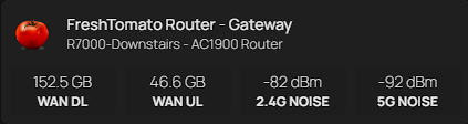

Nice one, thank you - this is all working perfectly now! Appreciate the effort you've put into this, cheers.
Homepage widget pulling nicely:
