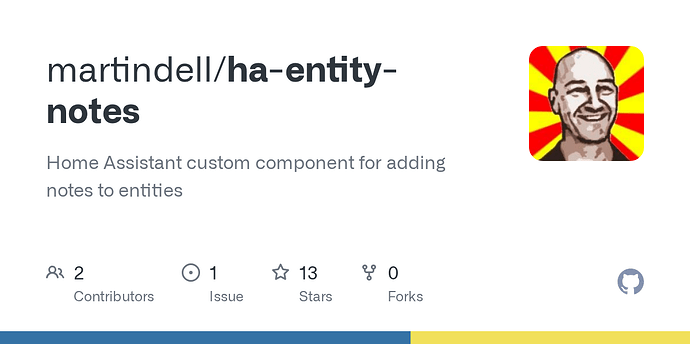

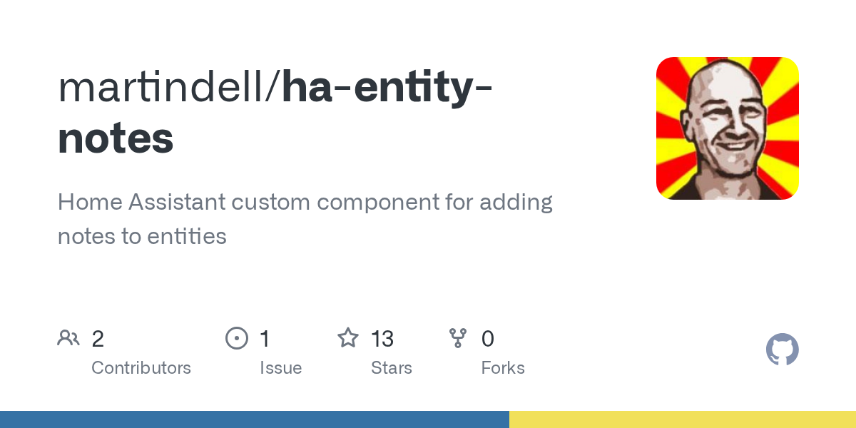

Discovered an interesting and possibly useful integration - you may be aware of it already:
It allows you to add a short note (max 250 characters) to any entity, and I’ve found that they can be used to provide extra context for an LLM - rather like using the description in a script.
I’ve been using the notes for a while and they seem effective and harmless. They’re saved in a json file in .storage, which my particular LLM add-on can’t read, but I have a python script running periodically to copy them into a yaml file - just started experimenting with that.
So far they’ve been quite useful in clarifying “Change device type of a switch” helpers, where you end up with two entity IDs controlling the same physical device.
Anything to add to context. :grin:

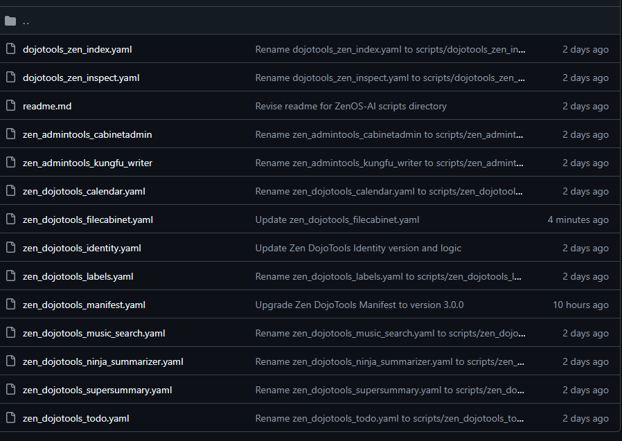

Many Updates - Most of them are quality of life.
First, I moved all the scripts and automations etc. into their own folders… Then I updated a bunch of them… :wink:
nathan-curtis/zenos-ai: Friday’s ZenOS-AI: Modular AI Home Automation Core inspired by Friday, Kronk, Rosie, and the High Priestess. Home Assistant-native, ultra-flexible, and delightfully over-engineered.
Most of this is about Indexing - FileCabinet FINALLY writes the index correctly and I can do a proper index-read on one cabinet. Next is to iterate a list of cabs then finally if no list given ALL cabs.
Note: The FileCabinet module is getting a SERIOUS update rn - if oyu get it it has a dependency on the library_index custom template You need them BOTH.
Status Update: Fixed a number of bugs trying to close in on 1.0 RC. Everything I’m working on now is mandatory to be able to deliver the prompt loader… (How do you know whose ID capsule to load if you don’t have a concept of a user?) Identity now ‘works’ enough to plumb it in and it’s the last tool to write before I can seal up the core feature set.
