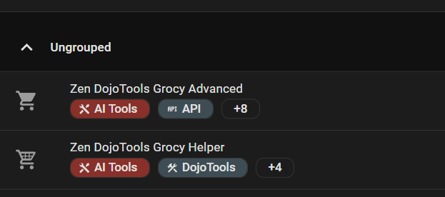

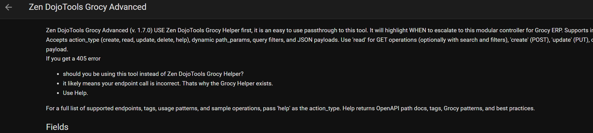

Peace offering. I had to get good at packages… (see plan for cabs…) Not optional. So, I decided to start with something easier. Somewhere WAAAAAY up there is a Grocy script where we prototyped accessing a RESTFul service through calling REST command via a tool.
The experiment worked - but we have to provide a rather robust set of docs for the LLM to be successful. I think you also see from that point (I about mid feb last year) we’ve learned we can provide really good docs inside the tool script and it REALLY helps the LLM. We also know we want to be conservative with scripts (count of tools) because of the OAI 128 tool count limit…
…But if I sub out Tool A for Tool B in exposing said tool to the LLM and Tool B completely supersedes Tool A in function but and ease of use by interpreting tool A - I don’t lose anything by having both in the system - having B rely on A and only exposing Tool B to the LLM. It also helps me from a serviceability perspective, more modular testable code.
I mentioned the new tool here Using Ollama to run a script in Home Assistant - #4 by NathanCu
So the advanced script is now the old pipe to the REST command interface:
Where the ‘Helper’ gets exposed to the LLM -
alias: Zen DojoTools Grocy Helper
description: >-
  Zen DojoTools Grocy Helper (v2.11.0) is a deterministic, construct-safe
  command router for Grocy. It converts explicit, human-readable household
  intents into governed Grocy API operations with strict preflight validation
  and guarded execution.
  All names are resolved to canonical Grocy IDs before use. Required inputs are
  enforced per case. Ambiguous matches, unsupported actions, and unsafe writes
  are blocked with corrective coaching. No implicit inference, background
  mutation, fuzzy guessing, or raw REST payloads are permitted.
  Supported operations include catalog inspection, inventory reads, governed
  purchasing, consumption, reconciliation, stock transfers, shopping list
  generation, chores, tasks, and semantic location management with Home
  Assistant metadata binding.
  Inventory integrity is preserved by design: stock movement must prefer
  transfer and reconciliation operations over delete-and-readd patterns.
  Destructive actions are deliberately constrained to prevent silent data loss.
  READ HELP BEFORE USE. Mode=help documents every case, constraints, and failure
  modes. If something is blocked, help already told you why.
mode: single
icon: mdi:cart-variant
and does the heavy lifting…
But for me they need to stay in sync… and are the perfect test for the package. So, we’re pulling in the REST Command YAML, the two scripts and I’ll add a comment about where to drop your API key and server URL for Grocy.
Suddenly the LLM becomes a damn quartermaster. No joke. Enough context window and speed and you’ll never do inventory the old way again.
It does NOT need a Grocy Integration and if you have one - great. This is designed as a direct pipe for the LLM to get access to Inventory.
