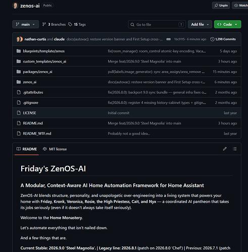

Steel Magnolia is on Main.
Spent some time reconciling some conflicts, pushed up 8.1 and parked it on a feat branch, set it as main for a moment, created a release then immediately replaced it with 9. (This gives me a permanent anchor no matter what happens)
Aaaaand I’m also done now with all the minor reconciliation pushes after syncing 3 branches… :wink:
Yes 3, I’ve been fast forwarding everything I found this week on to 2026.10.0

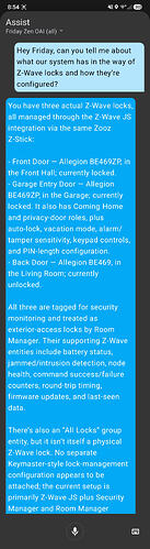

BTW T I’m pulling a bunch of KM support into next build now that I can block activities… Just thought you might be interested to see how Friday controls locks… Gimme a month.
Oh I’m interested. I just haven’t hooked any LLM into any of my HA systems (yet). I’m following this because I find it something I want to do in the future and I would rather have a good idea of the whole setup before I actually stick my fingers in it :smiley:
Looking at it I should be able to drive a ‘locks console’ modeled (mentally anyway) on the KM. Lock dashboard. Rn I’m trying to make sure tthe agent chases parent/child correctly. I THINK it’s currently working in 9… It can see and manipulate the locks but I’m reserving settings and control for v.next.
Not to cause you to go switching lock managers, but unless you’re needing Rental Control management as well, have you considered Lock Control Manager? The model there might work better for an LLM, especially the latest changes that I’ve seen that are driving more towards the persona has N unlock options vs KM that is very “slot” oriented given the origin of being a Zwave only system at first.
That’s next. They’re a scaffolding action from the perspective of running agents.
I have to think about it like teaching a 9yo.
First can we ID locks.
Now can we manipulate locks.
In context
Now do it safely
Handle the contra cases
Now security.
Now do it all again with lock codes.
Now do it all again setting temp codes and deleting them..
Now fold it all into one activity I line with guest stays…
Im at… The security step. You’ll probably see the rest in by 2026.11. 0
And the cool part. Is the way I’m doing it. It should detect what solution you’re using and just use it.

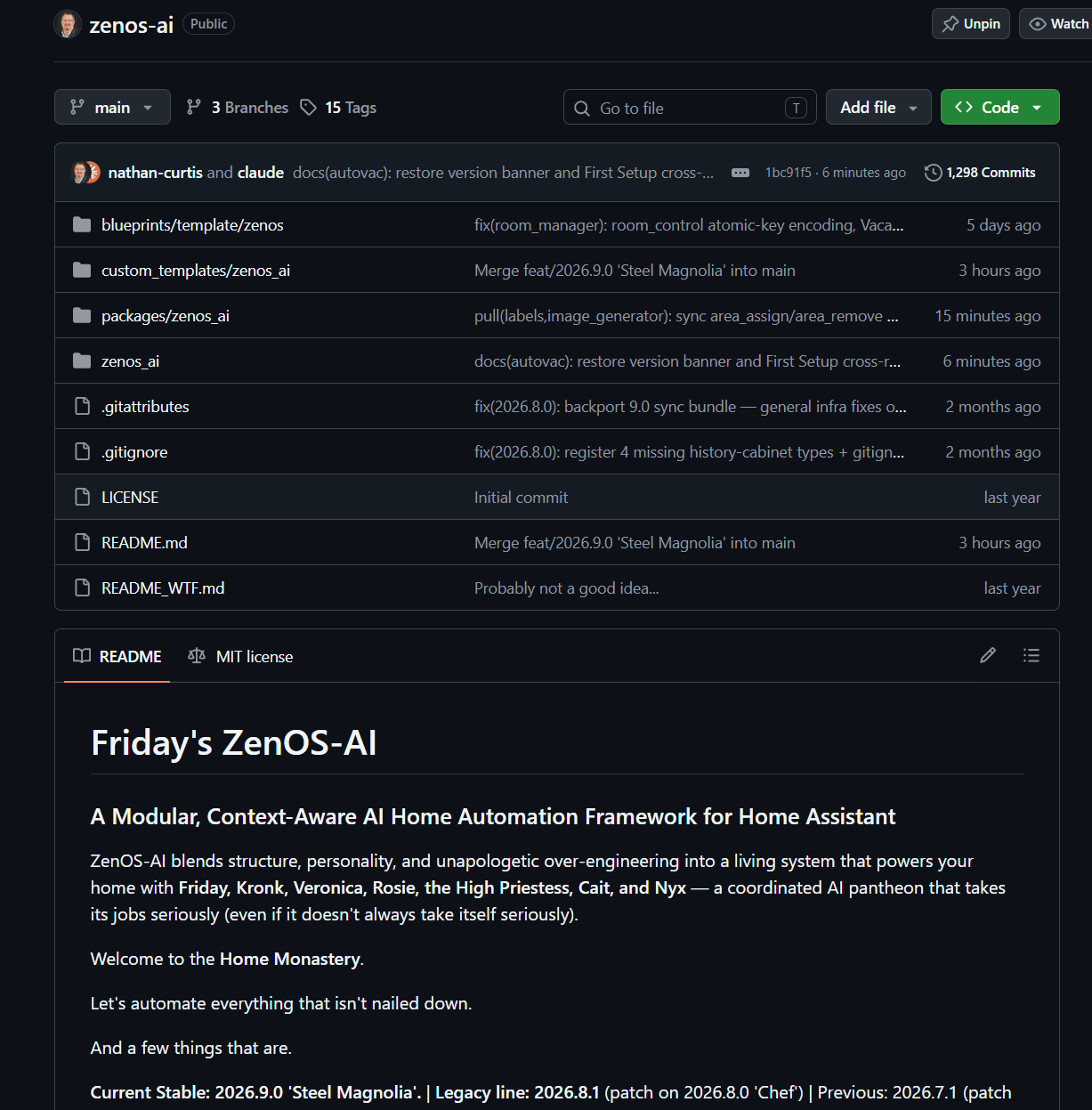

9.1 Patch is up on RC before I move it to main this weekend.
Someone …Zach was busy reporting bugs. You also get the egregious “who wrote this stuff?” fixes from my 10.0 stabilization work. :wink:
Seriously, report buggers - get buggers squashed. Zach, thanks man. Put 9 hashmarks on that armor my friend.
No showstoppers moves it to main on Saturday.
nathan-curtis/zenos-ai at feat/2026.9.1
