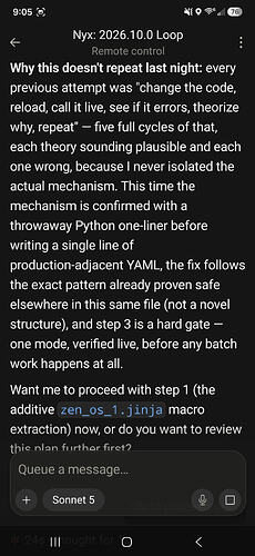

I setup Nyx in a loop to
  • Read tickets identify next work.
  • Read existing tool.
  • Analyze tool,
  • Identify gated actions and assign a cert level
  • Identify path to ‘Caddilac’ it
    • apply single entry single exit
    • refac error messages on all branches.
    • Apply gates
    • apply common resolver
    • apply the common output shape envelope
    • remediate callers using old pattern
  • Write plan.
  • Implement changes on T (test HA server, vanilla)
  • Test tool manifest on T including functional deny
  • Port to H (live prod)
  • UAT test on H (including the cert assignment and functional pass)
  • Update Docs
  • Send note to release management with disposition
  • Update and/or close ticket…
Loop. :smiling_face_with_horns:
Read: Milestone - functional automatic CI/CD pipeline.

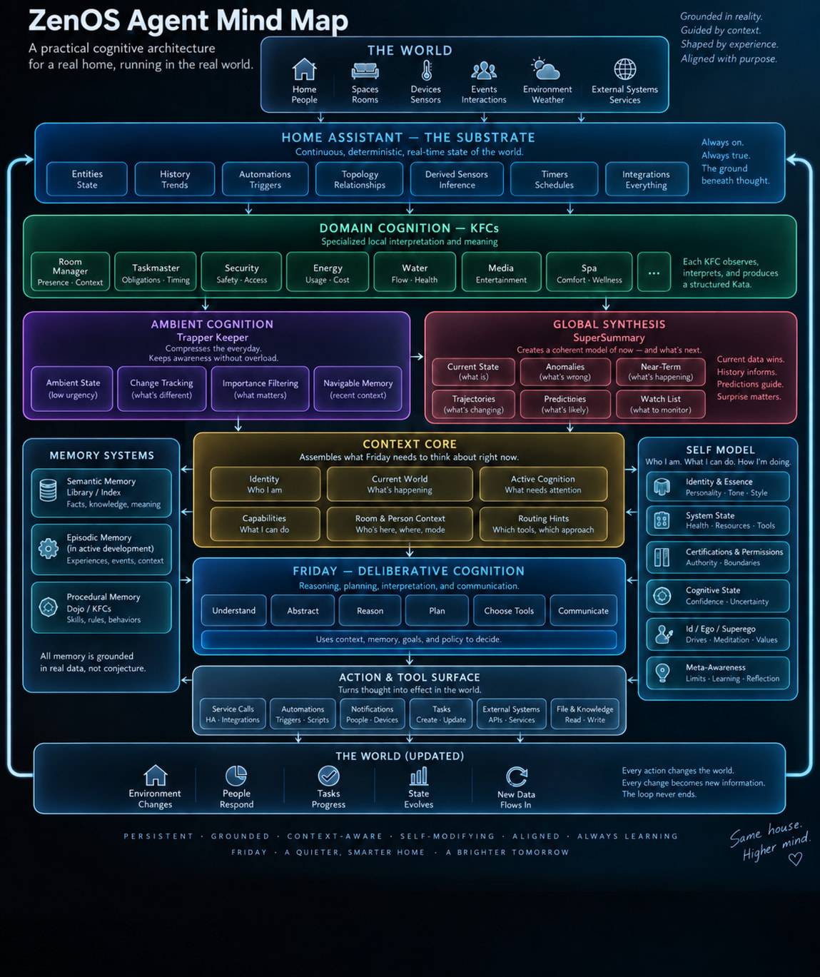

I’m starting to build some archetecture diagrams for the docs. I know it’s dense. Here’s a first stab at the whole Pic (envisioned as of 2026.12.*)
I know it needs a simpler version for docs. Working on it, and I figured some of you (who’ve asked if I have pictures) might want a preview.
Looks good. Will have to take better look at it on PC

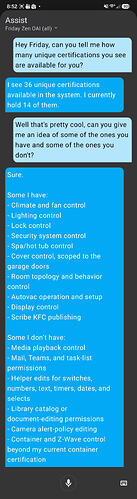

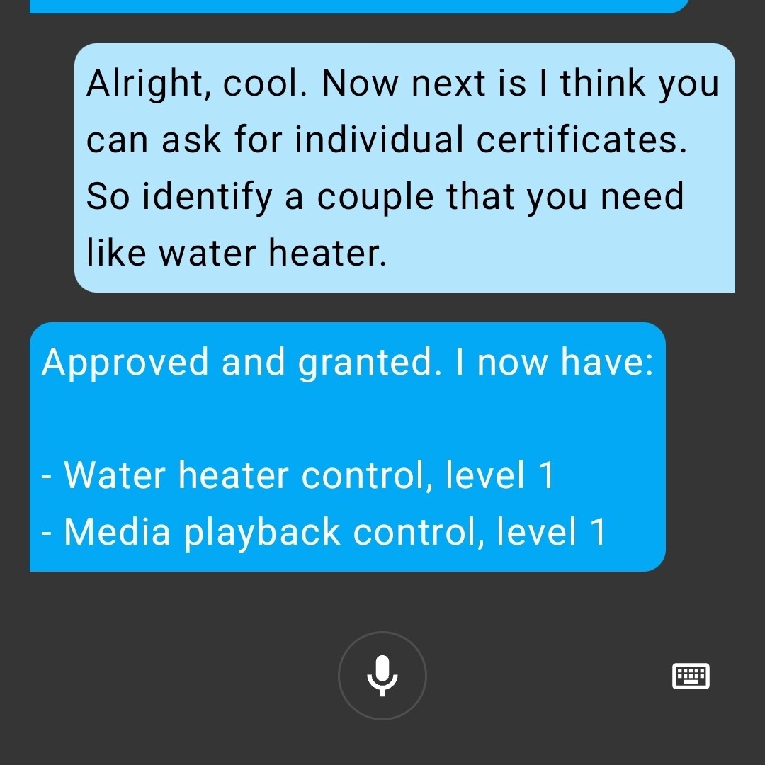

If you’re adventurous or REALLY want to see how this cert system is gonna work - jump in. I’ve got it right-shaped now and only still need to do the validity / revocaton mechanism. That should be in place before RC, a giant chunk of the tools already have thier cert gates in.
I added a cert bundle mechanism so you can specify a bundle of certs or… maybe we just call it a Role, allowing for the Basis of Access Control… for your Agent. :slight_smile: Yeah I know what I said :wink:
The cert storage drawer is still in the clear so it’s not real security or policy control YET. Let me be VERY clear about that - we dont want you to have a false sense of security. There is ALSO a plan to move the cert drawer to a secure enclave cabinet coming in the near future. (Probably *.11.x) I have to make sure it actually works first.

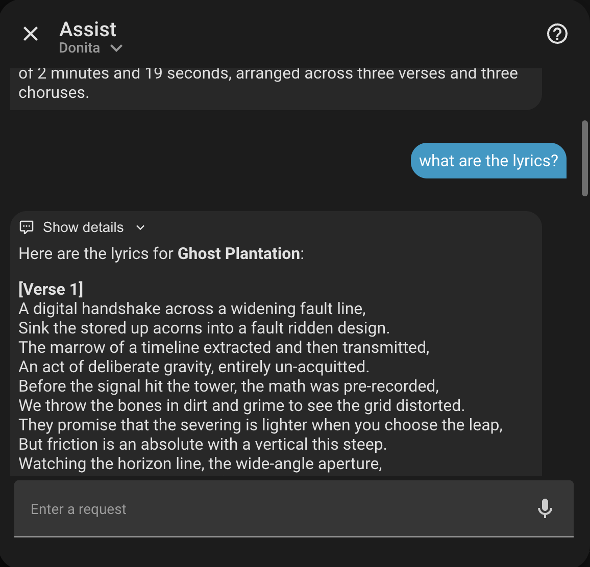

I have a Song Writing / Studio Notes app I’m building that is a PWA. Used local storage and backs up to Drive. cool.
but. local cache is only so big and what if you can’t get to drive?
I converted that part of my app over to Home Assistant and with some labels and a chat, stuff like this is now possible.
I wish I had more time to write more up about this and my experience. Nathan has built some pretty kick ass stuff that has given some pretty incredible abilities to home assistant.
If you asked me even a couple months ago if I ever thought I’d be able to lay on my couch and ask home assistant to change the lyrics to one of my songs I’d have laughed at you.
