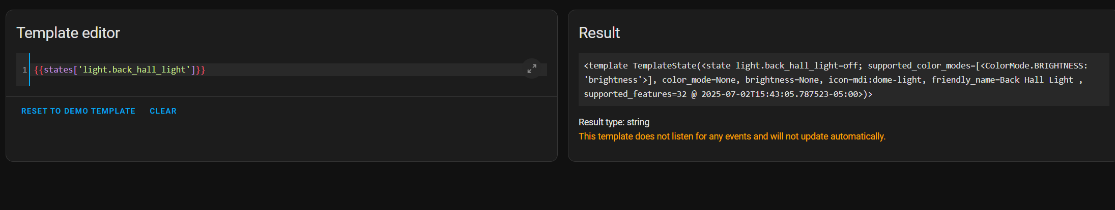

Essentially what this means, HA’s default context does include name, alias, and entity_id but does NOT include device_id.
Given context crafting rules that means
until I create context for her to understand device ID IT DOES NOT EXIST in the Assist context space…
…therefore targeting by device ID without building your own resolution process for an LLM won’t work in most cases.
I believe it’s deliberately not possible to control via device_ID through Assist. In fact, it seems that they don’t want us doing it that way at all, but haven’t yet removed the ability to do so.

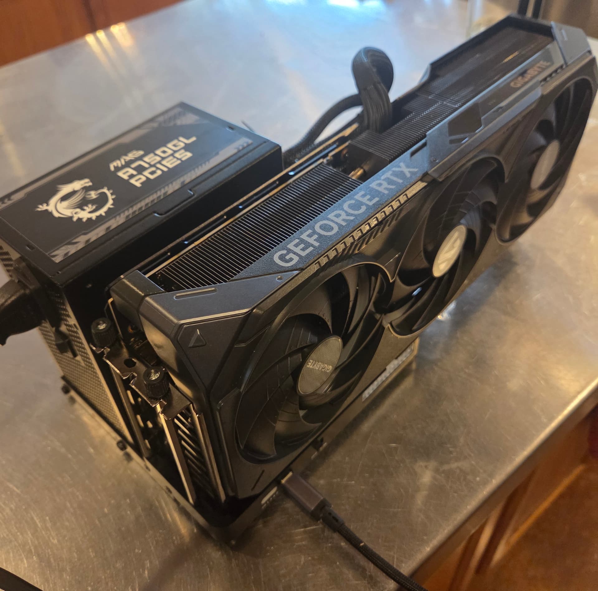

lol, what are we looking at here?
Nvidia RTX 5070ti 16G on an EGPU setup. It started with looking for a card to train my wake word… Then. Well…
You learn something new every day. What’s the data bandwidth of that cable?
TB4 - 40gbps if your machine can do it. Another option is occulink! Direct PCIe (my machine doesn’t have it) the card will absolutely outperform the link.
Bonus the link also doubles as an atx header and a USB PD link. :rofl:
Also haven’t heard about EGPU so far. Pretty cool. :upside_down_face:
Remember I had that Digits pre-order? :smiling_imp: I took the money I’d saved so far and dumped it into this rig the price kept going up and. This was realistic and with the new model… :sunglasses: I put power to it 30 minutes ago and so far… No magic smoke.
