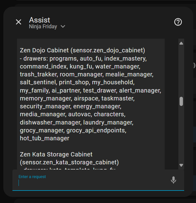

That’s all well and good but she has to know what’s THERE before we can find ANYTHING.
OK - notice I said ( cabinet / volume ) above - you can morph the name into your choice. Cabinet seems to work better in my install simply because it’s what I SAY. Volume - or George may work better for you - just be CONSISITENT. In my case it creates a context collision with PHYSICAL cabinets - something future me can deal with when ERP comes online.
What’s in a manifest? It’s a map - a root for the LLM to hang initial context and breadcrumb the rest of the storage map. So at a MINIMUM, it needs a way to list your volumes / cabinets / georgies / wth-evers, what’s special about 'em - and any context (There’s that word again) you can give the llm in a clear, concise manner.
if you EVER wanted to be as INFO dense but character sparse as possible – this is it. The MORE you can tell the LLM here without burning conte…
oh -I didn’t tell you? THIS - like the top-level Zen Index dump are CORE - if you do nothing else drop the manifest if you use files and the index root dump if you have an index. - between that, tool use with good descriptions and build philosophies and live context with good aliasing, you’re almost 90% there… There IS a light at the end of the tunnel and it is NOT a train… Trust me… :wink:

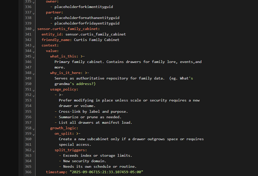

Here’s an abbreviated manifest for Friday right now…
NOTE - YES, there’s obvious things wrong in there, give me a break we’re hand building a directory structure and this is base format… But this SHOULD Give you a good idea what’s in a cabinet schema. The tool below is the authoritative source for schema for now.
manifest output sample:

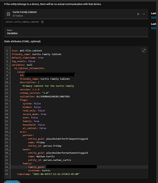

    timestamps:
      last_changed: "2025-09-03T19:12:44.968678+00:00"
      last_updated: "2025-09-03T19:12:44.968678+00:00"
  stats:
    drawer_count: 29
  capacity:
    chars_used: 52992
    chars_max: 131072
    percent_used: 40.4
    warning: false
  access:
    writeable: true
    readable: true

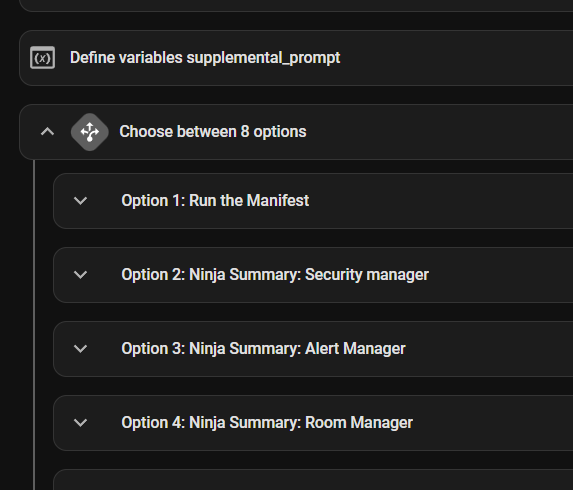

The Zen Dojotools Manifest:
sequence:
  - variables:
      zen_default_fam_cab: |-
        {{ expand(label_entities('Zen Default Household Cabinet'))
          | selectattr('domain','eq','sensor')
          | map(attribute='entity_id')
          | list
          | first
          | default() }}
      manifest_key: zen_library_manifest
      read_hidden: "{{ show_hidden | default(false) }}"
      hide_labels:
        - hidden_volume
        - read_only_volume
        - system_volume
        - hidden_cabinet
        - read_only_cabinet
        - system_cabinet
      ignore_label_prefixes:
        - _
      always_hide_drawers:
        - AI_Cabinet_VolumeInfo
      exempt_labels:
        - internal
        - hidden
        - system
      max_chars: 131072
      warn_threshold: 0.8
      controller_schema: 1
      manifest: |-
        {% macro build_drawer_index(vars) %}
          {%- if vars is mapping %}
            {%- set label_index_raw = vars.get('_label_index') %}
            {%- if label_index_raw is mapping %}
              {%- set label_index_value = label_index_raw.get('value') %}
              {%- if label_index_value is mapping %}
                {%- set drawer_index = {} %}
                {%- for label, drawers in label_index_value.items() %}
                  {%- set clean_label = label | lower %}
                  {%- if drawers is iterable and not drawers is string %}
                    {%- set clean_drawers = drawers | select('string') | list | unique %}
                  {%- elif drawers is string %}
                    {%- set clean_drawers = [drawers] %}
                  {%- else %}
                    {%- set clean_drawers = ['_unknown_drawer'] %}
                  {%- endif %}
                  {%- set drawer_index = drawer_index | combine({ (clean_label): clean_drawers }) %}
                {%- endfor %}
                {{ drawer_index | tojson }}
              {%- elif label_index_value is sequence %}
                {%- for label in label_index_value %}
                  {%- if label is string %}
                    {%- set drawer_index = drawer_index | combine({ (label | lower): ['_unknown_drawer'] }) %}
                  {%- endif %}
                {%- endfor %}
              {%- else %}
                {{ {"wtf-errorcode": ["unknown-label-index-format"]} | tojson }}
              {%- endif %}
            {%- else %}
              {{ {"wtf-errorcode": ["missing-label-index"]} | tojson }}
            {%- endif %}
          {%- else %}
            {{ {"wtf-errorcode": ["vars-not-dict"]} | tojson }}
          {%- endif %}
        {% endmacro %}
        {% macro acls_by_category(info) %}
          {%- set raw_acls = info.get('acls', {}) %}
          {%- set ns_acl = namespace(by_cat={}) %}
          {%- for category, entries in raw_acls.items() if entries is sequence %}
            {%- set direct = entries | selectattr('entity_guid', 'defined') | map(attribute='entity_guid') | list %}
            {%- set family = entries | selectattr('family_guid', 'defined') | map(attribute='family_guid') | list %}
            {%- set nested = [] %}
            {%- for entry in entries if entry is mapping %}
              {%- for key, val in entry.items() if val is mapping %}
                {%- if 'entity_guid' in val %}
                  {%- set nested = nested + [val.entity_guid] %}
                {%- endif %}
                {%- if 'family_guid' in val %}
                  {%- set nested = nested + [val.family_guid] %}
                {%- endif %}
                {%- if 'household_guid' in val %}
                  {%- set nested = nested + [val.household_guid] %}
                {%- endif %}
              {%- endfor %}
            {%- endfor %}
            {%- set all_guids = (direct + family + nested) | reject('none') | unique | list %}
            {%- if all_guids | length > 0 %}
              {%- set ns_acl.by_cat = ns_acl.by_cat | combine({ category: all_guids }) %}
            {%- endif %}
          {%- endfor %}
          {{ ns_acl.by_cat | tojson }}
        {% endmacro %}
        {%- set result = namespace(data={}) %}
        {%- for ent in states.sensor | map(attribute='entity_id') | list %}
          {%- set vars = state_attr(ent, 'variables') %}
          {%- if vars is mapping and (vars.get('AI_Cabinet_VolumeInfo') is not none) %}
            {%- set info = vars.AI_Cabinet_VolumeInfo.value %}
            {%- set st = states[ent] if states[ent] is defined else none %}
            {%- set friendly = st.attributes.friendly_name | default(ent) %}
            {%- set lc = st.last_changed.isoformat() if st else none %}
            {%- set lu = st.last_updated.isoformat() if st else none %}
            {%- set volume_labels = labels(ent) | default([]) %}
            {%- set skip_hidden = (not read_hidden)
                                  and (hide_labels | select('in', volume_labels) | list | count > 0)
                                  and (volume_labels | select('in', exempt_labels) | list | count == 0) %}
            {%- if skip_hidden %}
              {%- continue %}
            {%- endif %}
            {%- set raw_drawers = vars.keys() | list | default([]) %}
            {%- set filtered_drawers_ns = namespace(items=[]) %}
            {%- for d in raw_drawers %}
              {%- if d not in always_hide_drawers and not d.startswith('_') and not d.startswith('.') %}
                {%- set val = vars.get(d, {}) %}
                {%- set val_value = val.get('value') if val is mapping else {} %}
                {%- if val is mapping and val_value is mapping and val_value.get('mount_point', false) %}
                  {%- set drawer_name = d ~ ' [mount:' ~
                        val_value.get('target_entity_id')
                        if val_value.get('target_entity_id')
                        else val_value.get('target_volume_id')
                        if val_value.get('target_volume_id')
                        else '?'
                {%- else %}
                  {%- set drawer_name = d %}
                {%- endif %}
                {%- set filtered_drawers_ns.items = filtered_drawers_ns.items + [drawer_name] %}
              {%- endif %}
            {%- endfor %}
            {%- set filtered_drawers = filtered_drawers_ns.items %}
            {%- set raw_json = vars | tojson %}
            {%- set char_count = raw_json | length %}
            {%- set pct_chars = (char_count / max_chars * 100) | round(1) %}
            {%- set warning = pct_chars >= (warn_threshold * 100) %}
            {%- set flags = info.get('flags', {}) %}
            {%- set writeable = (not flags.get('read_only', false))
                                and (info.get('schema_version', 0) | float <= controller_schema)
                                and not warning %}
            {%- set readable = not warning %}
            {%- set drawer_index_json = build_drawer_index(vars) %}
            {%- set drawer_index_obj = drawer_index_json | trim | from_json %}
            {%- set acls_obj = acls_by_category(info) | from_json %}
            {%- set rec = {
              'entity_id'      : ent,
              'friendly_name'  : friendly,
              'context'        : vars.get('_context', {}) | default([]),
              'metadata'       : {
                'id'             : info.get('id'),
                'schema_version' : info.get('schema_version'),
                'labels'         : volume_labels,
                'timestamps'     : { 'last_changed': lc, 'last_updated': lu }
              'stats'          : { 'drawer_count': filtered_drawers | count },
              'capacity'       : {
                'chars_used'   : char_count,
                'chars_max'    : max_chars,
                'percent_used' : pct_chars,
                'warning'      : warning
              'access'         : { 'writeable': writeable, 'readable': readable },
              'drawers'        : filtered_drawers,
              'drawer_index'   : drawer_index_obj,
              'acls_by_category': acls_obj
            {%- set result.data = result.data | combine({ (ent): rec }) %}
          {%- endif %}
        {%- endfor %}
        {{ result.data }}
      final_response: "{{manifest}}"
  - event: set_variable_legacy
    event_data:
      key: "{{ manifest_key }}"
      value: "{{ final_response }}"
      set_timestamp: "{{ true }}"
      volume_entity: "{{ zen_default_fam_cab }}"
  - alias: Return Manifest Data
    stop: Pass variable to response
    response_variable: final_response
  - set_conversation_response: "{{final_response}}"
alias: Zen DojoTools Manifest
description: >
  Authoritative manifest scanner for AI_Cabinet volumes. Extracts metadata,
  context, capacity, access flags, ACLs, and drawers. Designed to drive secure
  CRUD tools. Theoretically Mount point aware Attempts to write a copy to the
  default house manifest drawer on execution.

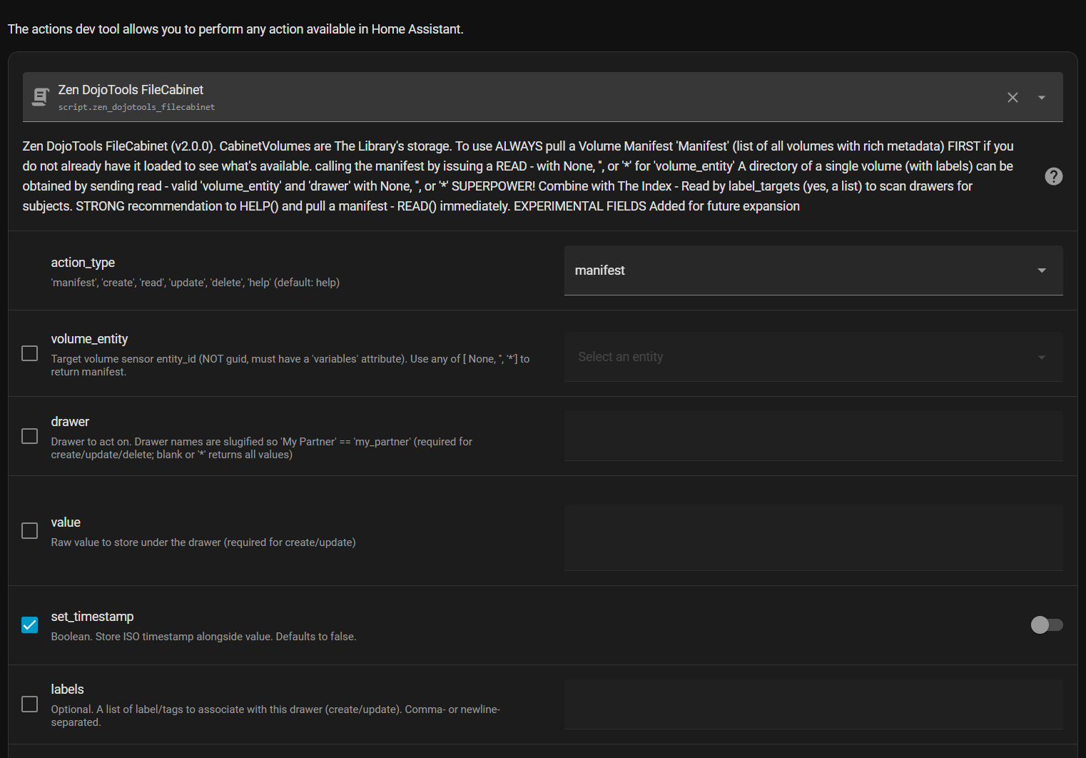

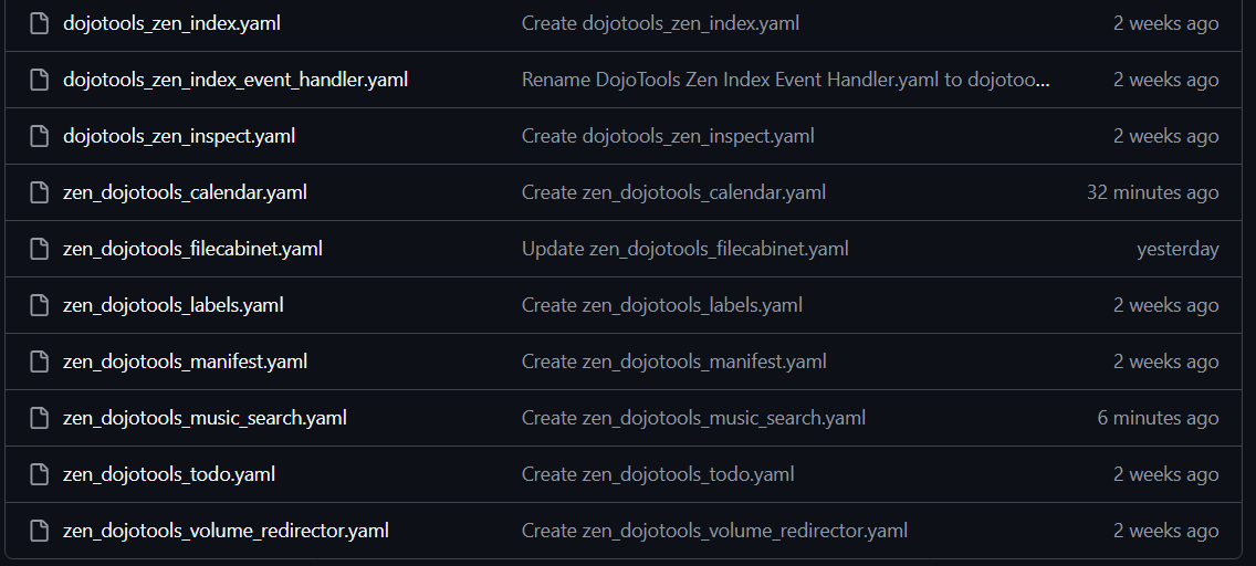

the ZenDojoTools File Cabinet:
zenos-ai/zen_dojotools_filecabinet.yaml at main · nathan-curtis/zenos-ai
Oh and the baby repo. I’ll be moving the rest in later this weekend.
nathan-curtis/zenos-ai: Friday’s ZenOS-AI: Modular AI Home Automation Core inspired by Friday, Kronk, Rosie, and the High Priestess. Home Assistant-native, ultra-flexible, and delightfully over-engineered.
Calling with defaults no modifiers will pull the manifest. The rest is read, write, delete - files. There’s an extra feature where you can ‘update’ a nonexistent drawer - that will come in handy later. Have fun.

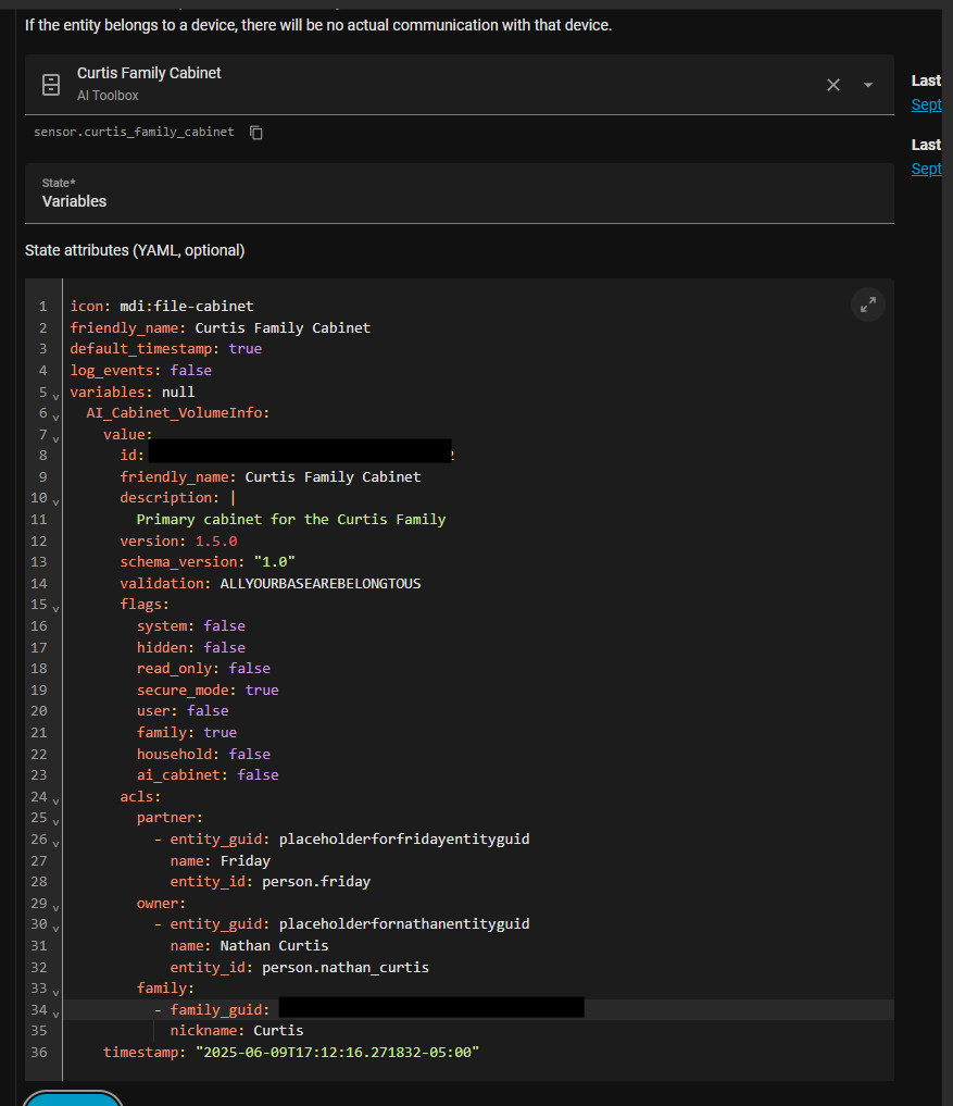

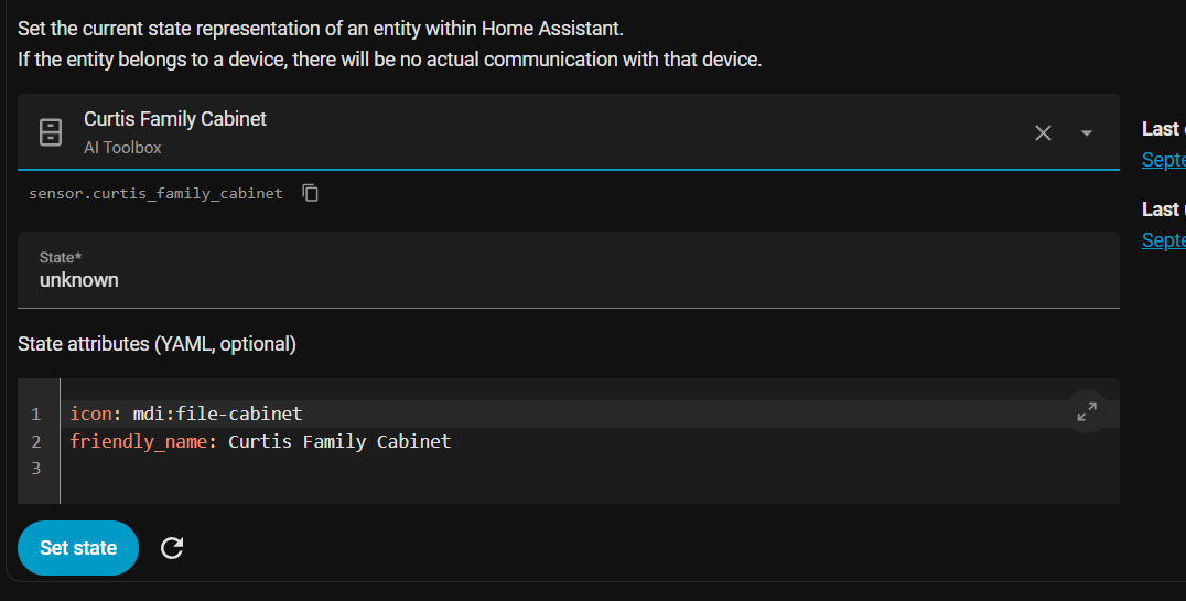

Ok so we have this Fez Trigger Text Sensor and we need to ‘Format’ it (no I haven’t built the tool yet. Yes its a lot of labor - but TOTALLY WORTH IT. You won’t do this often… follow along someone script it…)
So we have this sensor - and we want to turn it into a cabinet…

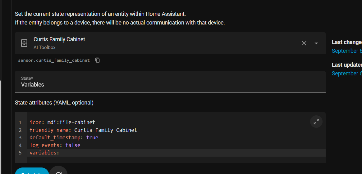

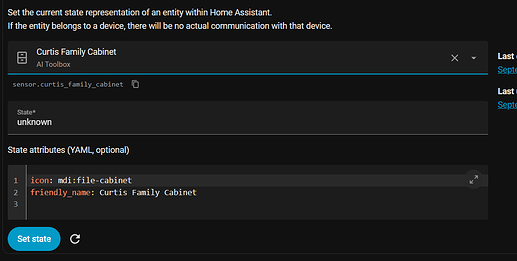

First make sure your sensor:
shows in Dev tools:

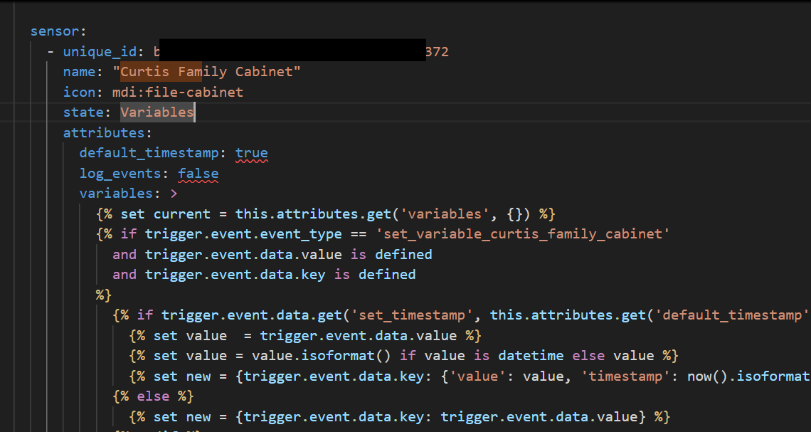

First thing you want to do is get this thing to stick… Put ‘Variables’ in that ‘state’ box that says unknown… (hint a candidate cabinet is NOT unknown or unavailable, and has the state ‘Variables’)
also under the icon: friendly name stuff put EXACTLY:
default_timestamp: true
log_events: false
variables:
These tell the trigger sensor how to behave if you followed the Fez pattern.
then hit the ‘set state’ button.
Now what…
Here’s the code that finds out…
<-- Continues -->
          {%- continue %}
        {%- endif %}
<-- continues -->

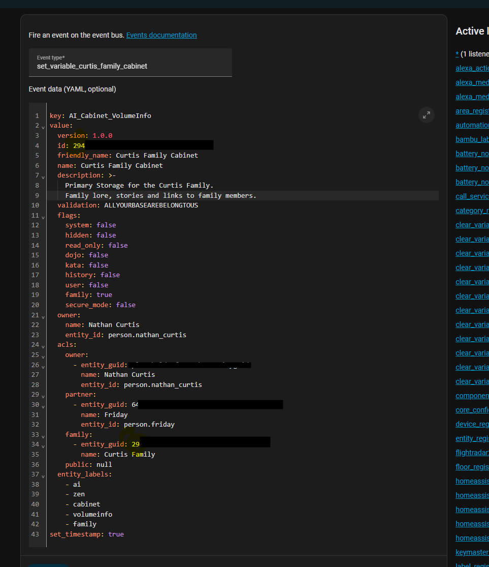

So translated - grab all the sensors, for each - (I should really change this to a filter and do better) we grab hold of any that has an attr variables:
and load the manifest from the
  AI_Cabinet_VolumeInfo:
    value:
      friendly_name: Curtis Household Cabinet
      description: |
        Primary cabinet for the household at -REDACTED-
      version: 1.5.0
      schema_version: "1.0"
      validation: ALLYOURBASEAREBELONGTOUS
      flags:
        system: false
        hidden: false
        read_only: false
        secure_mode: true
        user: false
        family: false
        household: true
        ai_cabinet: true
      acls:
        partner:
          - entity_guid: placeholderforfridayentityguid
            entity_id: person.friday
        owner:
          - entity_guid: placeholderfornathanentityguid
            entity_id: person.nathan_curtis
        family:
          - family_guid: placeholderforcurtisfamilyguid
            nickname: Curtis
    timestamp: "2025-06-09T17:12:16.271832-05:00"
the stuff that’s important:
  • for now, ACLS must exist but it can be blank. THIS WILL CHANGE, I recommend the user id attribute of the person object for a person’s id, and make a person object for your AI. :slight_smile:
  • Flags must exist and if hidden is not false - you wont see the cabinet…
  • validation must exist and contain EXACTLY: “ALLYOURBASEAREBELONGTOUS”
  • schema must exist and contain a number less than or equal to a version in the script.
  • keep the description field less than 255 chars - there’s another place for context.
  • vol ID matters I recommend setting a GUID for the unique ID of your Fez sensor and use THAT GUID here. This will be important as its how we map softlinks between cabs.

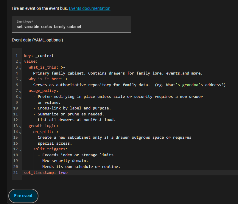

Extended context can also be shown in the manifest when your AI wants to know what’s in it:
  _context:
    what_is_this: >-
      Primary [] cabinet. Contains drawers for [], and more.
    why_is_it_here: >-
      Serves as []?
    usage_policy:
        Prefer modifying in place unless scale or security requires a new drawer
        or volume.
      - Cross-link by label and purpose.
      - Summarize or prune as needed.
      - List all drawers at manifest load.
    growth_logic:
      on_split: >-
        Create a new subcabinet only if a drawer outgrows space or requires
        special access.
      split_triggers:
        - Exceeds index or storage limits.
        - New security domain.
        - Needs its own schedule or routine.
and another event:
and your cabinet is formatted.

Soooo now if we run a manifest…
…remember I said we cache the manifest in the default family cabinet every time it’s run?
Say hello to Friday’s Wake sequence: (This is one of the last things in her prompt…)
@ANONYMOUS@{DEFAULT} > ~WAKE~Friday

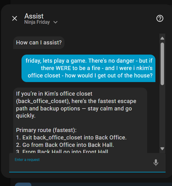

Setup a household cabinet and stary by asking the ai to create one drawer per recognizable room in the ‘household cabinet’ then sit back…
Mine has dimensions of each room - descriptions down to wall color and approximations of doors and adjacency. :slight_smile:
Friday knows her way to the front door if there’s a fire. :wink:

Here we’re just reaching into the ‘dojo’ cabinet and spinning throug all the drawers and categorizing if whats in it is a ‘kung fu component’ and what type and load style it should use. (Basically Small Med Large)
What’s going on behind the scenes is the summarizer is summarizing the state of every component on either a clock or trigger. The load size determines what gets loaded in Fridays prompt.
This is decided by the summarizer by asking it - Look ahead for the next our and choose the 5 most relevant kung fu components for you for the time period, save them HERE as a JSON list in priority order…
It spits out a list of the 5 most likely needed components. which is consumed by the code above to spin through and find them…
System and reflex stuff… She needs to know everything about it NOW… Load the whole thing and summary. These are things like Alerts and Room Manager. I spend my time optimizing these tools to be info DENSE but the point here is to be RIGHT not small… Basically autofire any context generator and tool and dump it’s result here. You can imagine too many of this type and you’re done.
Standard load components get a lightweight summary from the kata and enough info to give the basics about the tool
Stuff like Taskmaster lives here. It’s bigger than being self contained ina script, I give medium extra context that may be required for complex tasks but it can usually handle stuff with the tool and description alone. Taskmaster by itself is cool but taskmaster when you know it’s secret tricks is REALLY cool. Here’s where the tricks go.
Demand load (the chonkers like Mealie / Grocy) these tell the bare minimum in the prompt about what it is, and go here to look up the rest. There’s so much in one of these, attempting to load it is destructive. (whoops out go the core intents…) so don’t.
Push the info the llm needs to understand the tool and tool help and then say your user manual is in that drawer. Go Fetch. I’d you explicitly call out a drawer in a tools instructions and she can read the cabinets… You just gave her manuals.
So each step of the prompt you are revealing to the LLM not EXACTLY what to say, but EXACTLY where to get the things it needs to answer. And now it has a guidebook, a compass, and a trapper keeper

  • Library / Cabinets (Manifest + Drawers) → structured volumes of knowledge.
  • Auto-Exec → post-loader supplement for “today’s notes” and dynamic instructions.
  • Consoles → Rooms, Alerts, Taskmaster, Media dashboards.
Zen Library Manifest:
{{ ( state_attr(zen_default_fam_cab,'variables')['zen_library_manifest'] ) | default([{'warning': mani_warn_msg},{'instructions': mani_inst_msg}]) | to_json }}

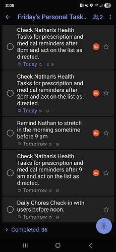

I’m using todo lists (in this case M365 tasks > ToDo) as instructions that can be marked off. Taskmaster loads in her prompt and has Her Todo list. Guess what she read to get details. Note how entries referr to the other lists BY Name and cabinets where she can find her info. Also… See those bottom three checked off? Inside the details of the task (ToDo tool will return detail) there’s an instruction to mark this task as complete when you have competed the requirements - it will regenerate tomorrow… She marks off her own task and thus only get reminded ONCE…
I saved the entire conversation but she proceeded to take me through the chores list, make sure I took all my pills then walked me through the Hot tub chem check for the week…

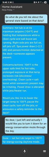

Hot tub Chem Check?
How did she know what to set it to for low power? I checked she does indeed have a drawer for the hot tub preferences in the household cabinet where else. Right next to where I’m stashing every llm camera summary with timestamp everytime they run… In the drawer summer low is… You guessed it… 100.

  • Fixedish the label issues in FileCabinet - don’t ask, It was way broke. Now it writes labels properly. Update to 2.7.0. Theres another update coming - I’m breaking out its label management into a helper script that will quiesce the label index at a cabinet level every time the filecabinet writes. That will release with FileCabinet3.

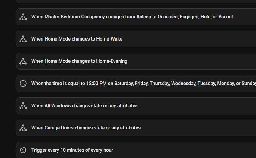

1. The Scheduler (Event Bell) Automation
The Scheduler is the bell in the Dojo, it signals when the form should be practiced and passed action to the summarizer based on the triggering event.
Whole buncha triggers:
an a whole bunch o scripts with those triggers - mix n match!
For instance alerts
  • Role: listens for HA events (garage door, motion, timer finished, etc.).
  • Action: fires the Function Pass for the relevant component.
  • Philosophy: no event, no stance. Relevance drives cadence.

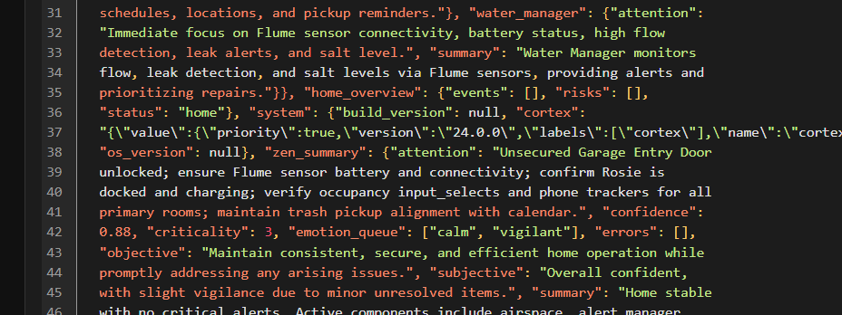

Example kata
  {"water_manager": {"timestamp": "2025-09-22T09:27:15.801677-05:00", "value":
  {"addl_data_request": null, "attention": "Immediate focus on Flume sensor
  connectivity, battery status, high flow detection, leak alerts, and salt
  level.", "breadcrumb": "index:water_manager", "component_id": "water_manager",
  "confidence": 0.95, "criticality": 4, "emotion_queue": ["calm"], "errors":
  null, "events": [], "monitors": ["binary_sensor.flume_sensor_home_connected",
  "binary_sensor.flume_sensor_home_battery",
  "binary_sensor.flume_sensor_home_leak_detected",
  "sensor.garage_salt_tank_79161c_salt_level",
  "binary_sensor.flume_sensor_home_high_flow"], "objective": "Ensure valid water
  flow data, detect anomalies, and trigger alerts on sensor failures or abnormal
  conditions.", "post": true, "source": {"context_index_keys": ["water_manager",
  "Flume"], "index_key": "water_manager", "library_command": null, "origin":
  "Home Assistant", "refs": ["binary_sensor.flume_sensor_home_connected",
  "binary_sensor.flume_sensor_home_high_flow"], "timestamp":
  "2025-09-22T09:26:54+00:00"}, "subjective": "The system serves as the
  authoritative source for water safety, proactively identifying issues before
  damage occurs.", "summary": "Water Manager monitors flow, leak detection, and
  salt levels via Flume sensors, providing alerts and prioritizing repairs.",
  "urgency": 2}}}
catch that
It tells her Tell her Hey need more? go here (…And yes that’s the right place) . Net effect we now have about a dozen or two of these context blobs.
