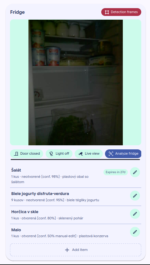

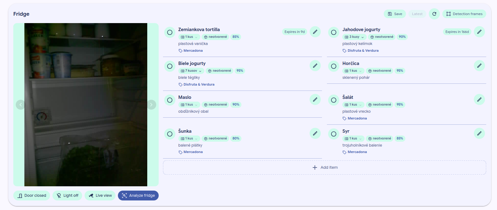

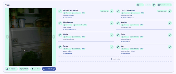

Custom card (installable via HACS as a custom repository) that:
  • Shows the latest photo, with a configurable rotation (for a crooked camera mount) and height.

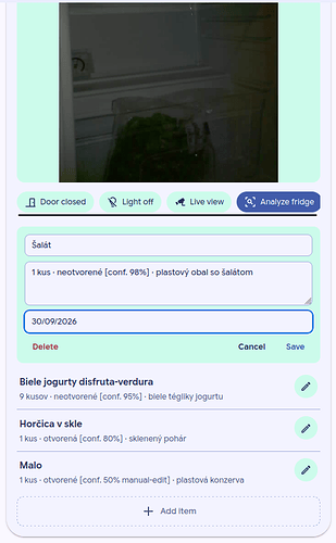

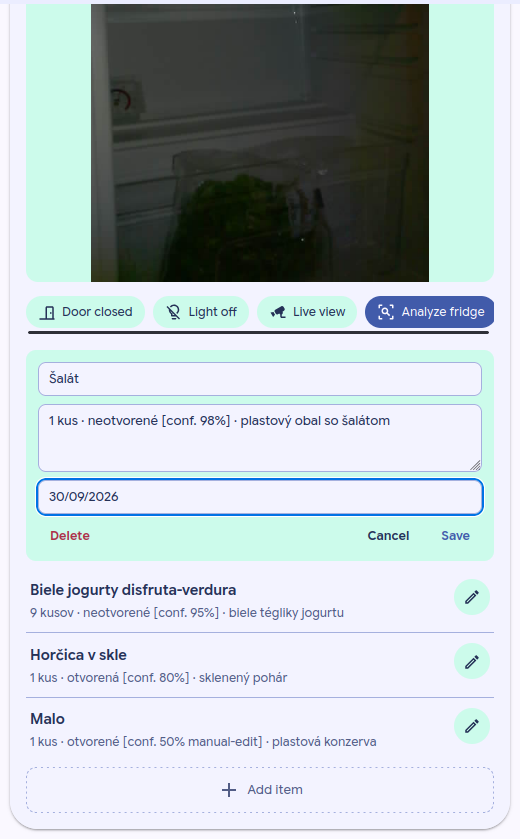

  • Lists the AI-recognized items as a plain, editable list — name, description, expiration date — no checkboxes, since this isn’t really a to-do list.
  • New in v1.1.0: an optional “Detection frames” toggle that overlays each item’s AI-estimated bounding box on the photo.
  • Quick controls: light toggle, door status, a button to open the live camera view, and a button to re-trigger the analysis.
  • Fully configurable from the Lovelace UI editor, no YAML needed.
