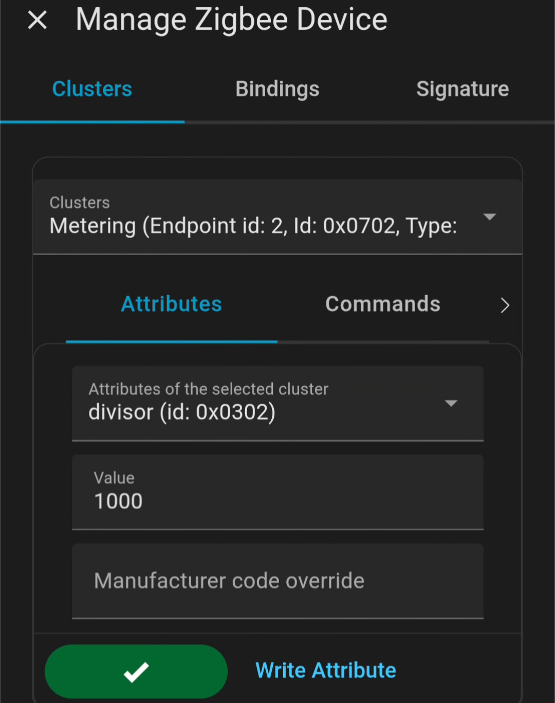

I found the cluster 0x0702, but I’m not sure which attribute that I need to change.
There is one called “divisor”, but when I try to change from 1000 to 4000, it returns always 1000.

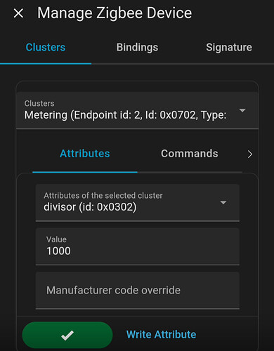

Read:

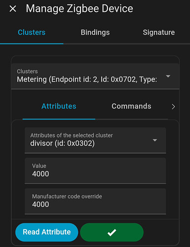

Write:

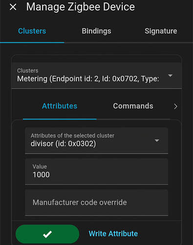

Read again:
