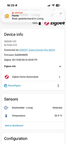

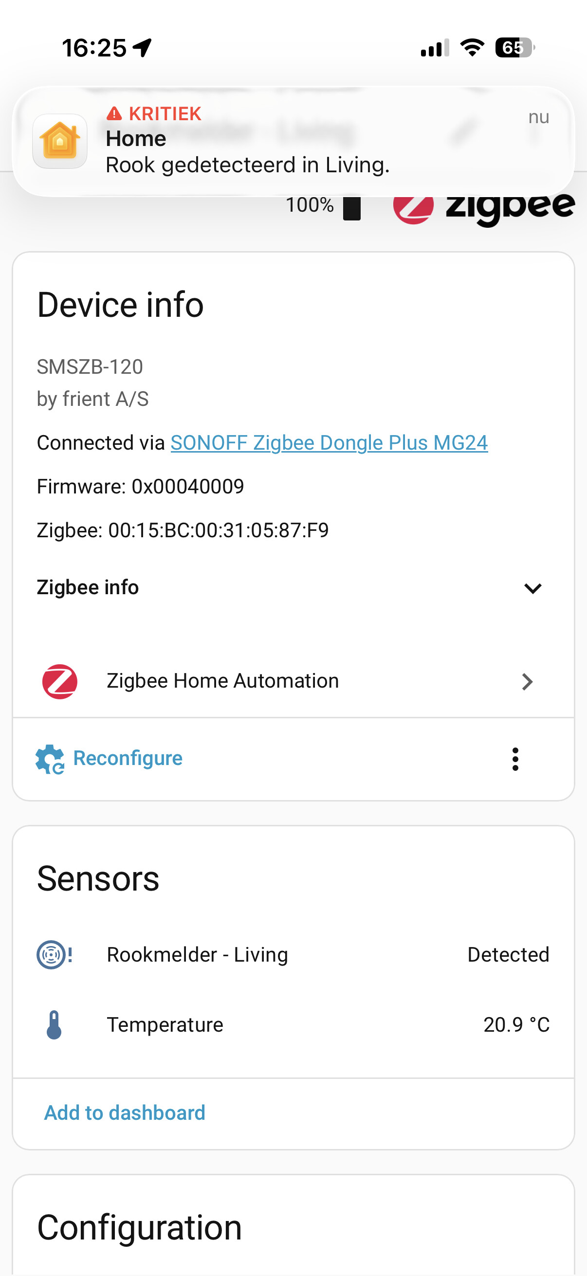

As suggested by @RedKing I picked up a detector test spray from the local DIY and sure enough, when spraying the detector the alarm comes through just fine in Home Assistant (and HomeKit if you have HomeKit Bridge set up).

Yes the smoke/heat detectors trigger a alarm when actually sensing real smoke or heat.
It's just the zigbee test event that seems to be broken/not implemented correctly when integrating the detectors via Zigbee Home Automation and running the current latest firmware 0x00040009.
