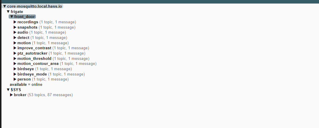

And I see that my automation never gets triggered. Even when there is a detection which I can see. I’ve installed MQTT Explorer addon as well and it shows frigate (see image) but still no trigger. When I try to publish frigate/events or frigate/reviews the automation is also not triggered.
No clue what’s going wrong, can you help?

Also if you are using the mosquitto addon, don’t create users in the addon settings. Create a home assistant user, and that user will have access to mosquitto by default.
Thank you! Apparently just using the default user, so removing the login and adding my home assistant user name and password to the frigate.yml for mqtt works
