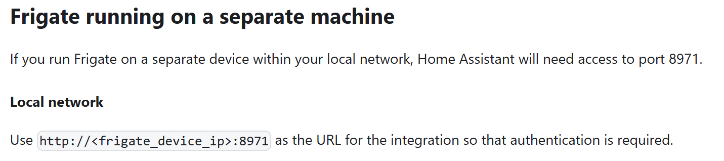

You have read the docs?
https://docs.frigate.video/integrations/home-assistant
Mine uses this format
https://192.168.1.117:8971
I have looked at that doc page several times

Finally sorted it, needed to add Port 5000 to my docker-compose.yml file.
You then connect in the integration using http://192.168.1.78:5000
All the chatgpt and videos show you connection via 5000 but the Frigate documentation says 8971
