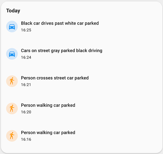

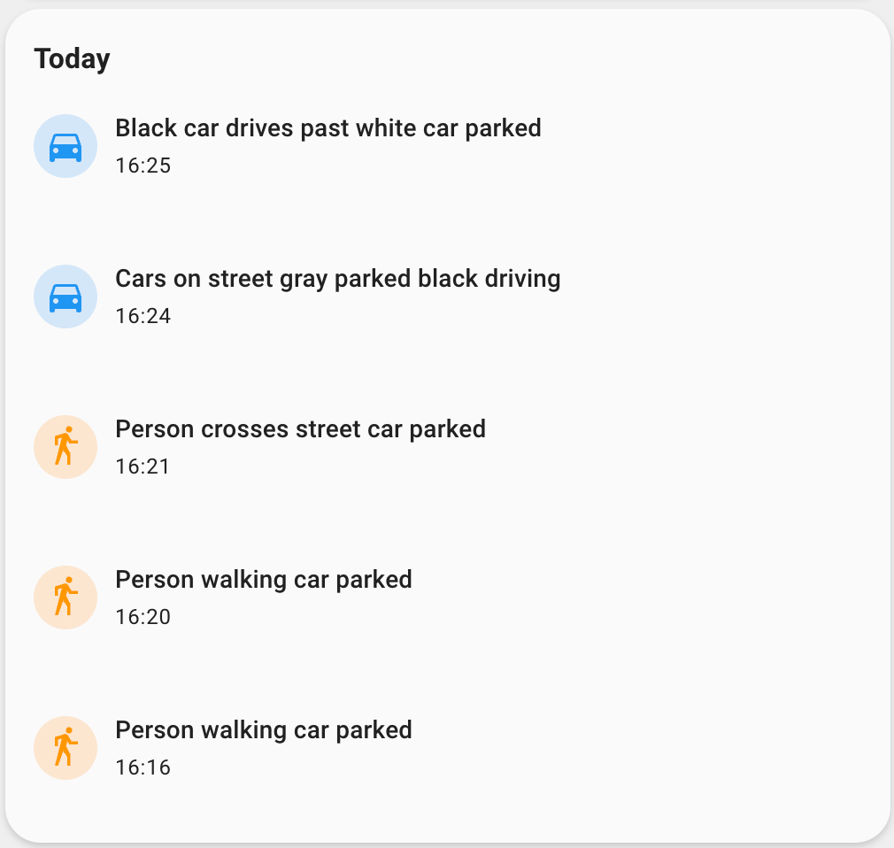

And this is what my timeline looks like:
Amazing work with this though, excited to follow this!

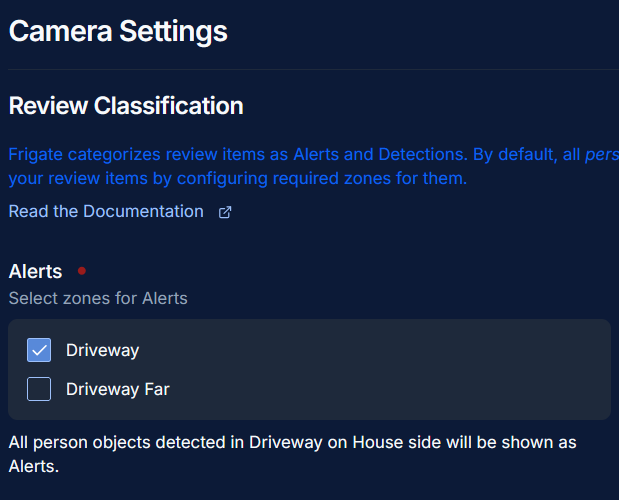

Hi there, i can see there is no zones in the payload from the trace you supplied so that would explain this behaviour.
"objects": ["car"], "sub_labels": [], "zones":
    [], "audio": []}}, "after": {"id": "1748552094.598771-bwvofu",
so if you had a zone input then you would not receive a notification, i would assume your frigate config needs altered to include “driveway” in alerts.

Regarding the timeline images i know this happens because i have not included the LLM Vision expose images which the timeline needs to show the image, if i add this you will be saving the image twice in different locations. I dont personally need this but iam happy to add this option in the next update/fix.
In my BP you also need to enable the ‘‘Use Remember’’ input under images and clips if required.
Note: When configuring the timeline in LLM Vision you can set the auto delete days so you not storing these images in downlaoder,LLM and frigate for any longer than needed.

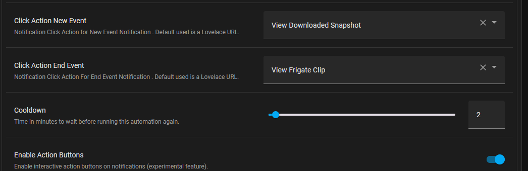

Try this modified blueprint, not thoroughly tested tbh, I have got images in the timeline.
  • expose images options added.
  • notification click actions
  • optional custom actions/service calls
PUSHED TO LATEST!

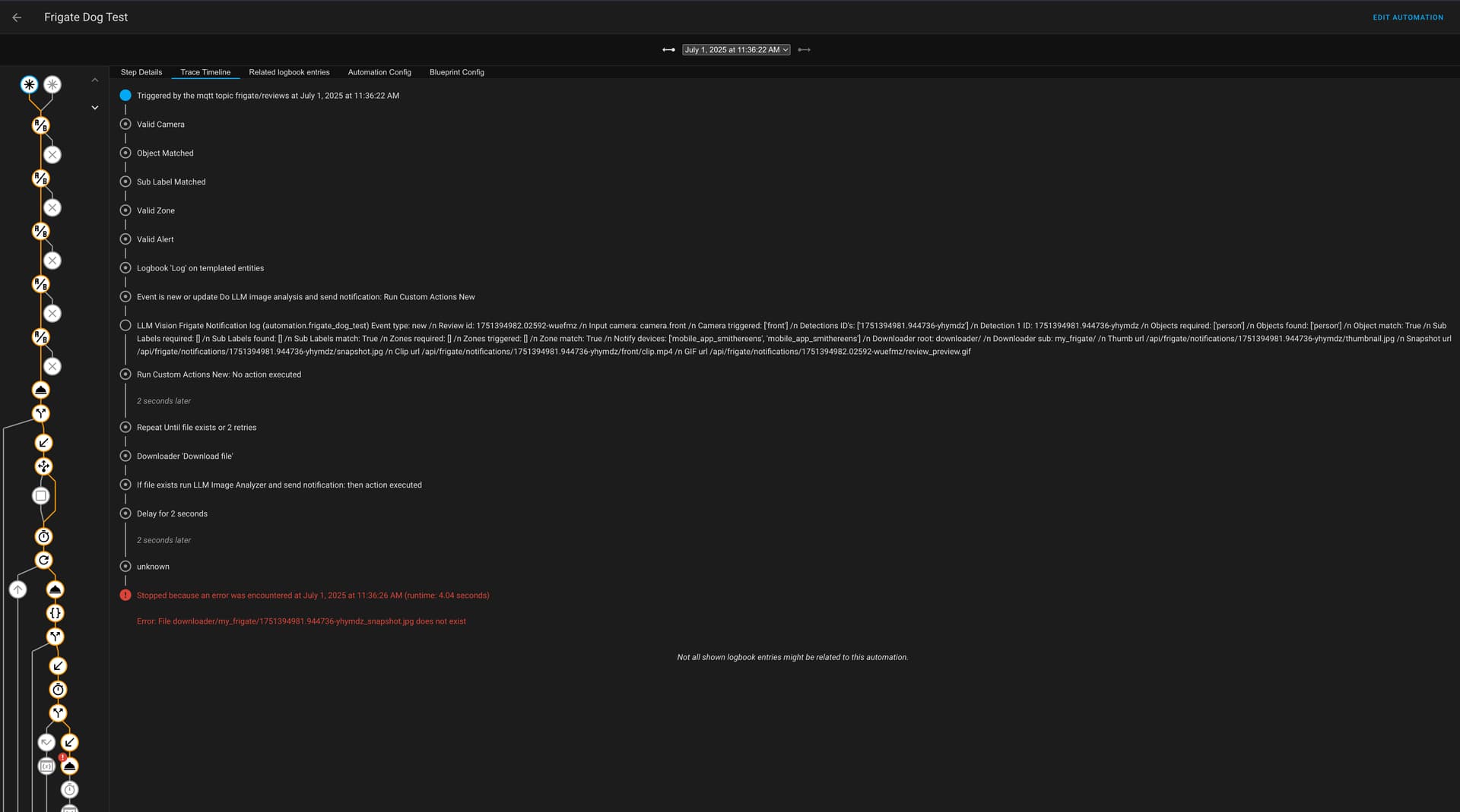

I’m having trouble with this blueprint, the traces show that the analyzers error out with no files existing: "Error: Error: File downloader/my_frigate/1751393446.971977-mn39d9_snapshot.jpg does not exist
However, when I go to manually check for these files, they DO exist and I can access them.
Any suggestions???
Hi there so you can access the files from config/downloader/my_frigate/ or are you checking the frigate URL directly?
Just to confirm there is also no sub folders, after my_frigate.
On the trace does it continue after the error and then fail a second time after retrying the download.
Can you add a longer delay in say 30 seconds for the clip and maybe 10 seconds for the image to see if you get the automation to flow. If that works then dial back the delays until your happy with it.
Failing all that post your automation config or debug.
I am checking the files exist in the HA filesystem with terminal, and can access them at http://192.168.1.239:8123/api/frigate/notifications/1751393036.023949-uj3oia/snapshot.jpg where .1.239 is my HA machine (raspberry pi).
The downloader is putting the files in /config/downloader/my_frigate/ and there are no subfolder after that.
Here is a snapshot of the trace:
I tried to extend the maximum timeout, but that doesn’t seem to be the issue. The automation seems to figure out when the file is done downloading, but it just cannot access it.
Please let me know what to try next, I really want this to work.
OKay looking at the trace, first thing I notice is the file has been downloaded and acknowledged.
They the downloader download action had no error and the event has been received to say the download is complete. The failure appears to be on the actual notification action.
First thing go check your JPG image is available in config/downloader/my_frigate folder and ensure the file is present.
Second thing to check if you can is copy the trace details,click the trigger when viewing the trace go to Changed variables and copy it all and paste here.
It exists, but the directory is /config/my_download_folder/my_frigate
Do I need to change “my_download_folder” to “downloader” ?
Or can I change something in the Blueprint to point to my_download_folder?
Edit: Oh duh… Okay, I changed the “downloader” name to my custom name and its working now :slight_smile: :slight_smile: :slight_smile: THANKS!!!
Yes it should be what ever you set in your downloader integration.
Excellent.Thanks for the update.

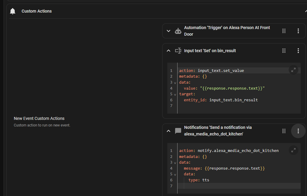

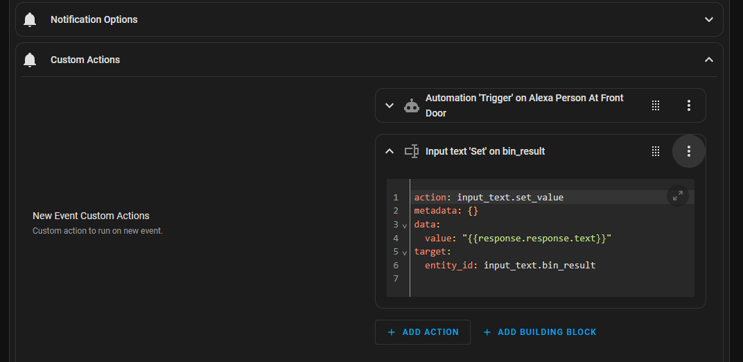

Okay just looking over your requests
Under click actions you should already have options for the frigate clip directly or the downloaded image/clip.
Regarding your edit:
As the BP sits atm it can do this with the custom actions and just do what you need i.e.
action: input_text.set_value
metadata: {}
  value: "{{response.response.text}}"
  entity_id: input_text.bin_result
you could send the response to a media player tts for example.
the next update will include alot more options for the notification actions and optional action buttons etc.
