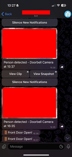

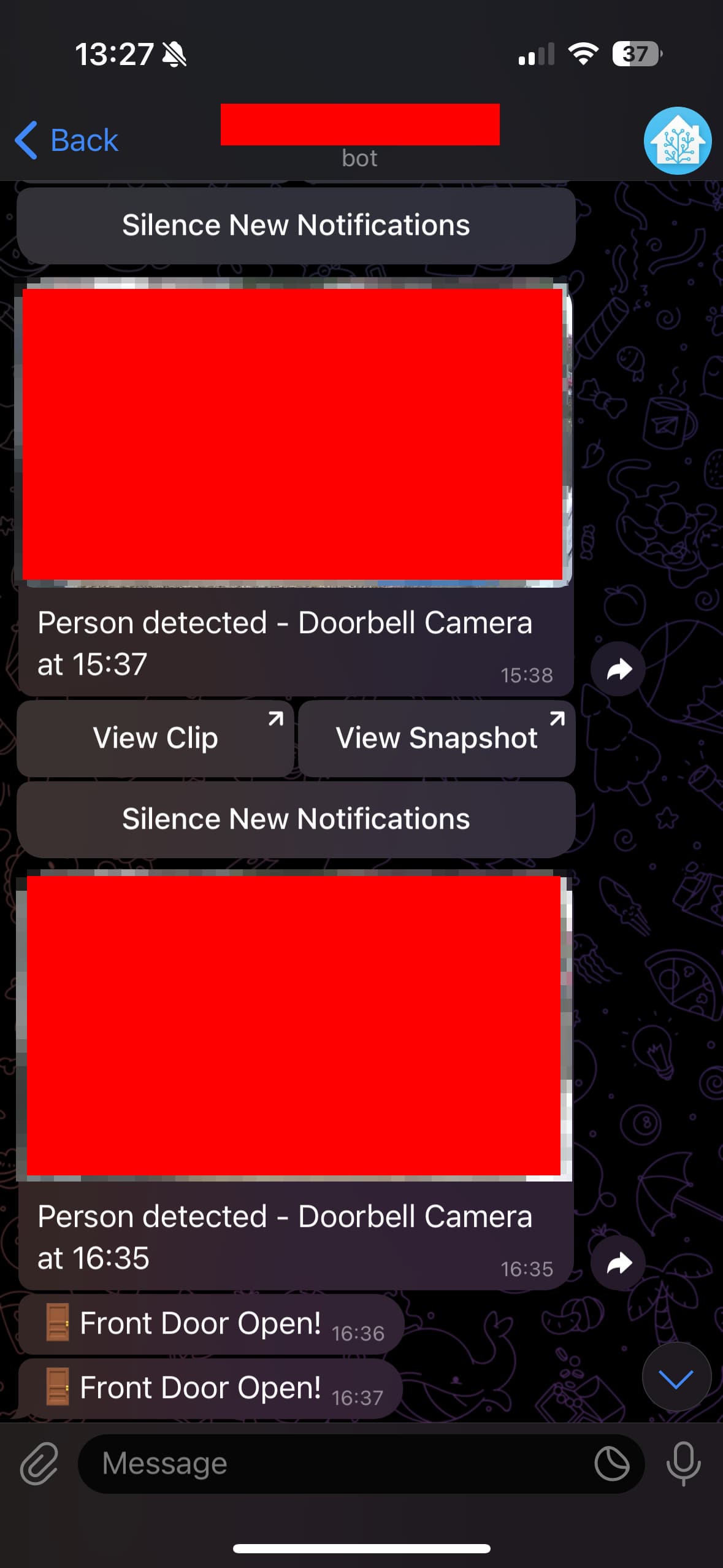

Question for the Telegram users - sometimes on notification I get the action button’s and sometimes I don’t… I can’t seem to pin down the behaviour, does this happen for anyone else?
