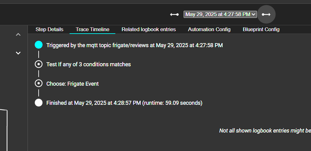

I’m needing some help, have had this running for years now, and it stopped reporting notifications on 2 of my cameras. just to make sure updates didn’t cause it, I updated to the most recent blueprint.
It didn’t correct the issue. I just had a car pull in my driveway, and while the automation fired, it doesnt go any farther than this point. I have the same issue with my doorbell camera.
Any thoughts?

There is a pinned guide on the GitHub on how to read the traces. It will tell you exactly what is stopping it from running further.
This is for the two previous posters also

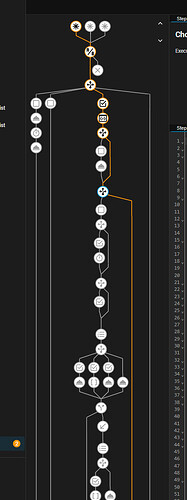

Looking at the Github guide and then my traces, they seem to go around the bell, so not sure how to check this?
Any thoughts?

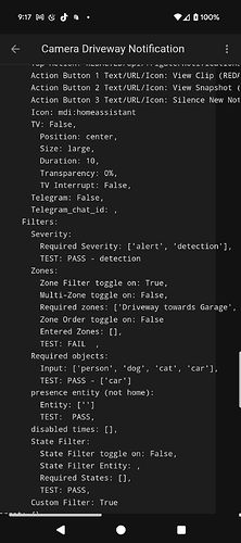

You don’t have debug enabled
But you can click on the empty square one below where it branches to the right away from the main tree and that shows the results of the condition checks.

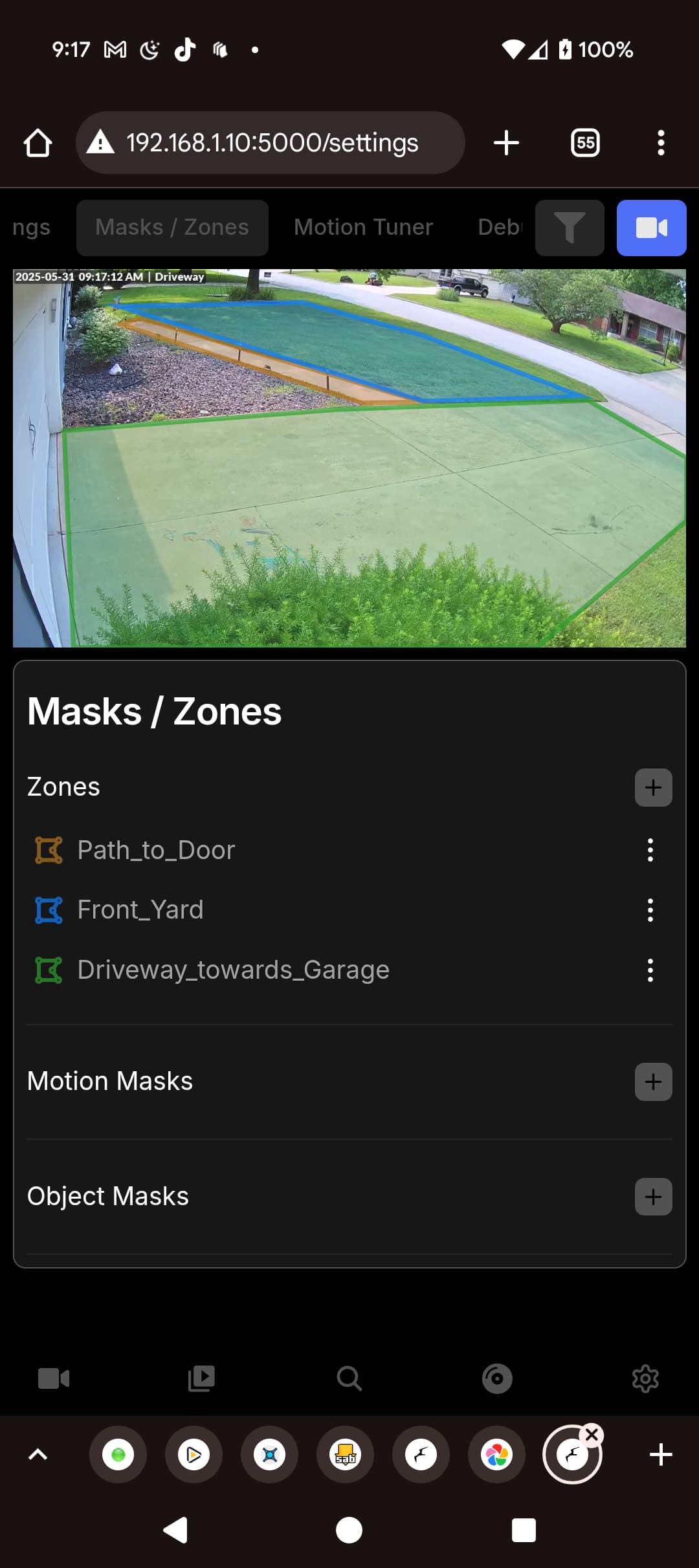

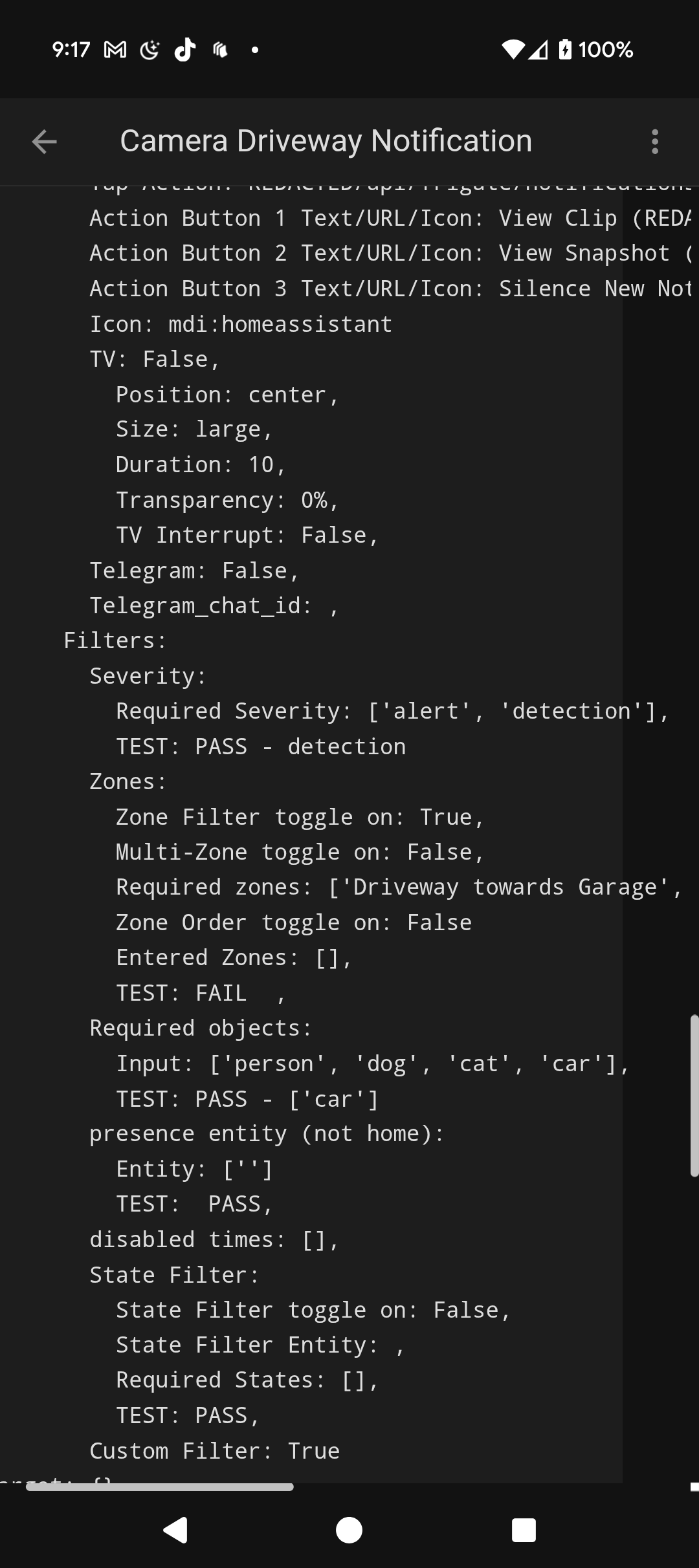

Thanks for your help here. I enabled debug and found the issue on one at least, but I dont understand why it’s not working.

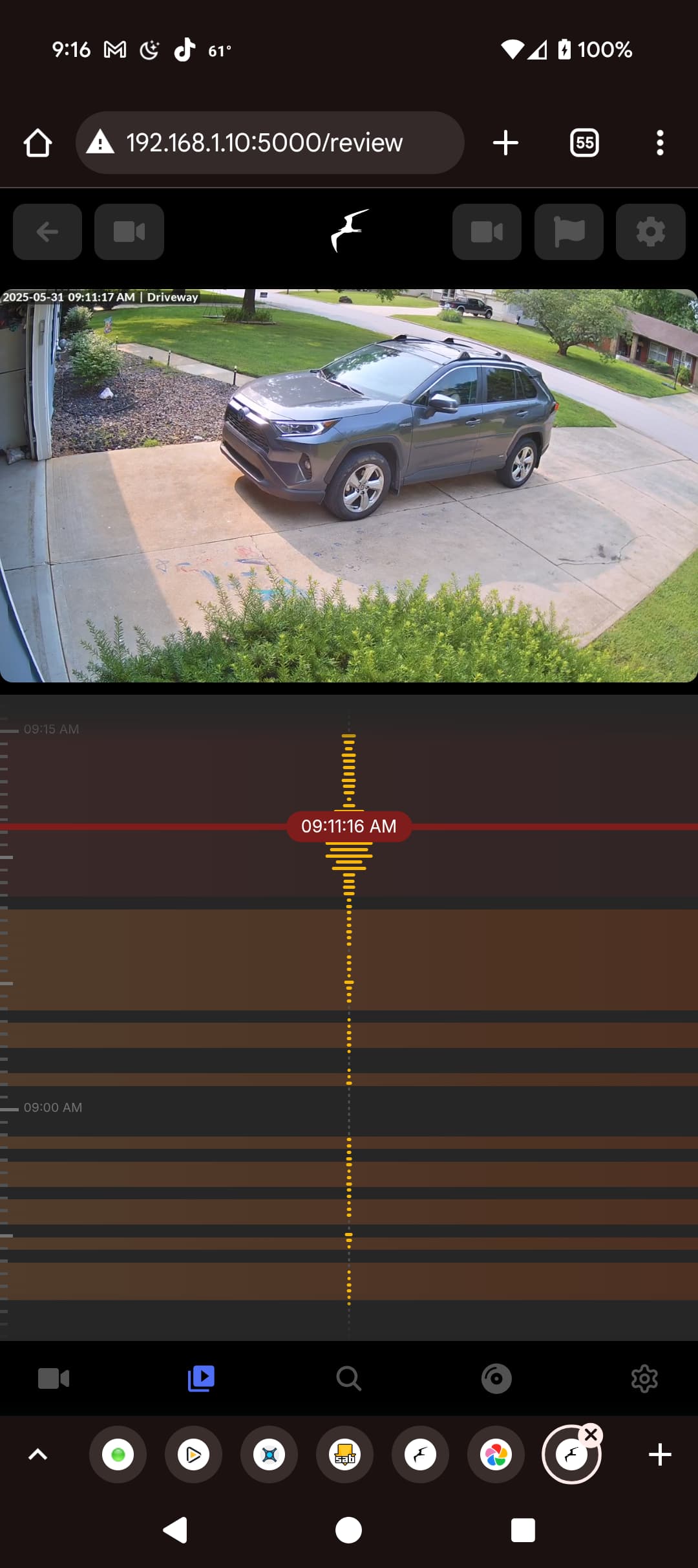

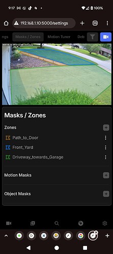

My mapping of zones haven’t changed, and as you can see in my Pic the car is in the zone.
Any thoughts?
Make the zone a required zone for reviews within frigate and don’t use the zone filter in the blueprint. Review mqtt messages don’t get updated because of zone changes
That fixed it! I’m going to your github and sending you money for a beer! Thanks for all your work on this.

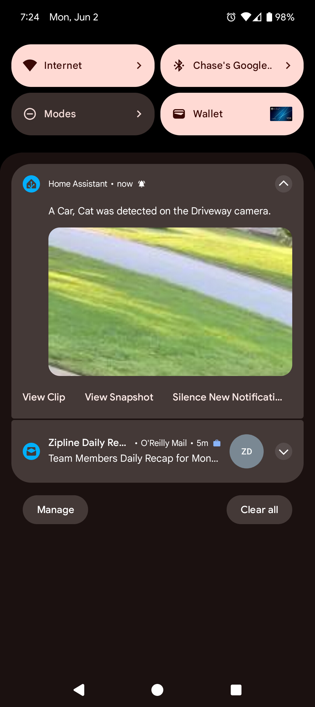

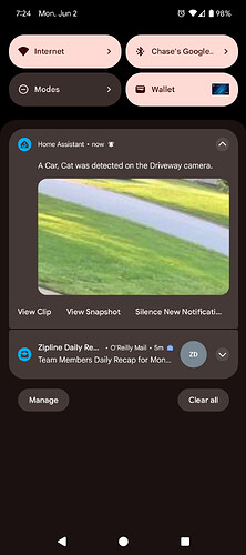

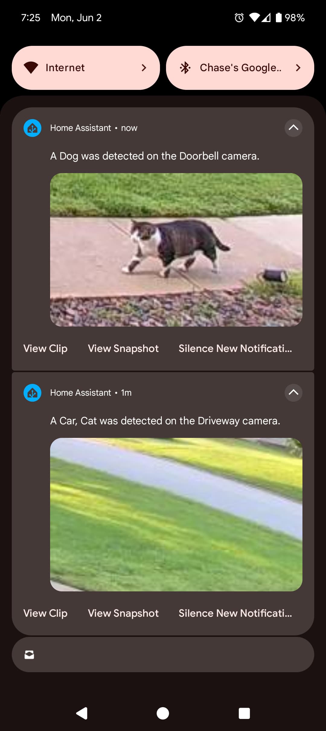

First when I receive an image it will either be zoomed in strangely, like my daughter is outside, and the notification will be a picture of her torso, or nothing at all like in screenahot below. It’s really the neighbors cat it was wanting to show me.
The next image showed it correctly

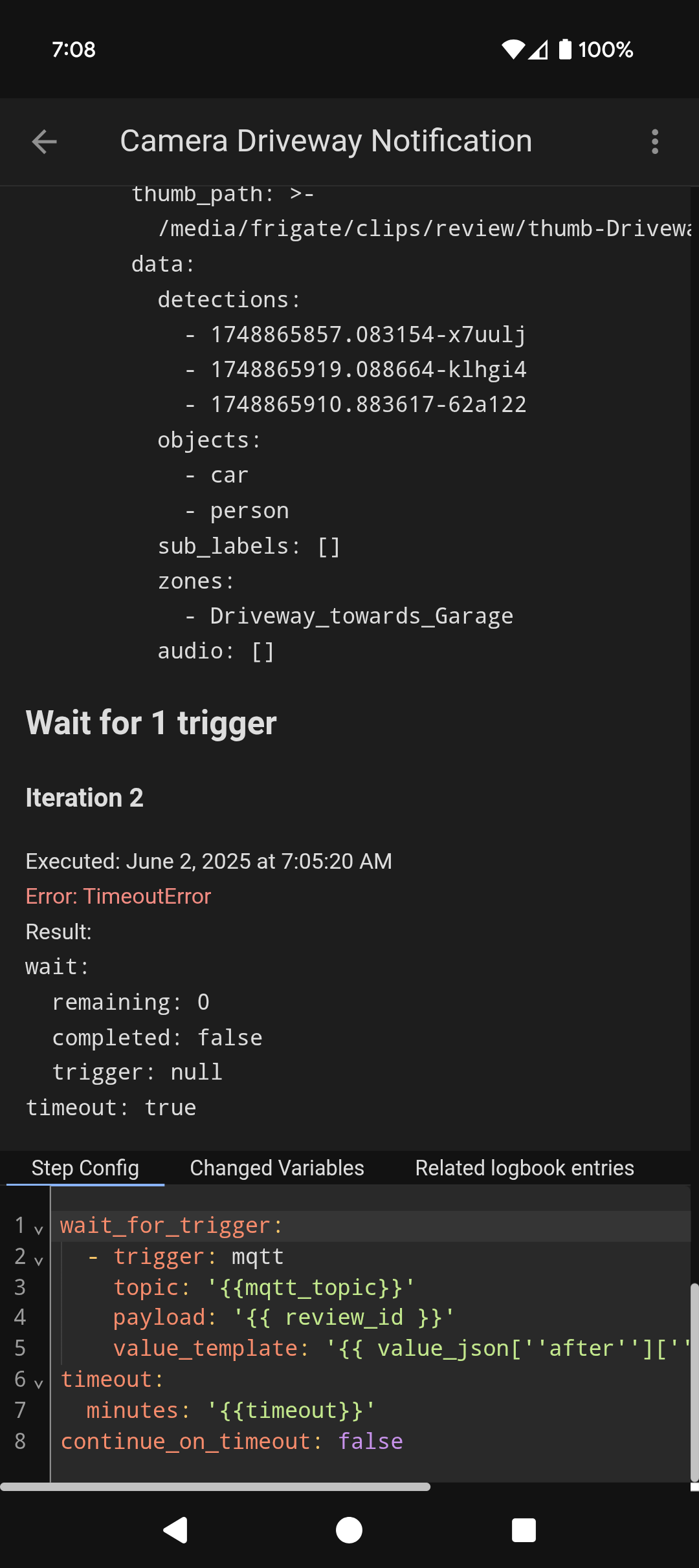

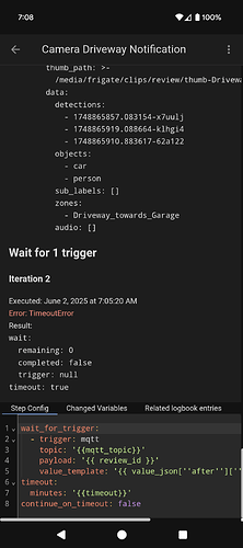

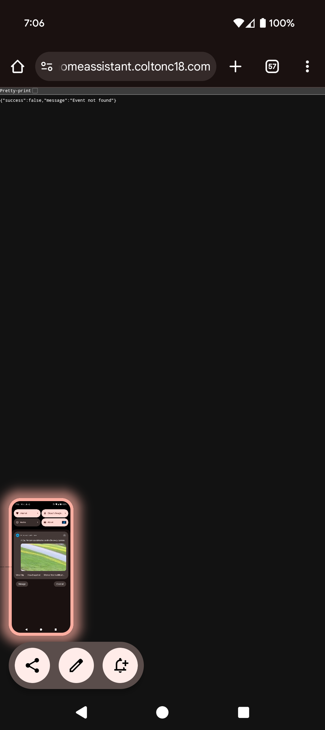

2nd issue is when I get a notification, but no image shows up at all, and I click on it and get this error.

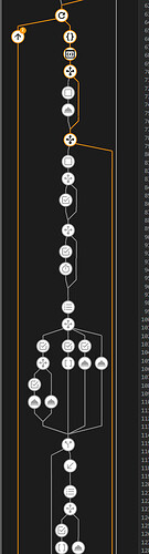

I went in the traces and it’s showing a timeout error, and I’m not sure where that would be, or how to address it.

1st issue, not really sure but could be variations in the frame used for the snapshot and the frame used for detection. Do you have cropping or something set up? Could play with that a little and see if a wider crop improves it.
2nd issue. It was likely a long event. The blueprint doesn’t wait forever. It could be changed I suppose but after some time it just stops waiting for an update by design.
Can’t speak to why the image doesn’t work unless frigate decided the event was no longer an event. But I didn’t think it did that with reviews.
