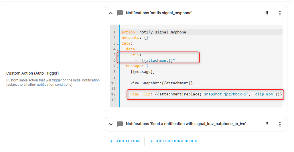

This got me on the right track how to send an additional notification with Signal using ā€œCustom Action (Auto Trigger)ā€ - thanks!!
The URL for the attachment seems to be wrong though:
{{base_url}}/api/frigate{{client_id}}/notifications/{{id}}/{{attachment}}
The variable {{attachment}} already has the complete path in my version of the blueprint, so ā€œ{{base_url}}/api/frigate{{client_id}}/notifications/{{id}}/ā€ in front of "{{attachment}} is not required and would result in a wrong URL.
This is what is working for me in release 0.14.0.2w of the Blueprint:
action: notify.signal_my_phone
metadata: {}
    urls:
      - "{{attachment}}"
  message: |-
    {{message}}
Regarding sending the clip instead of the snapshot, I would suggest to send the snapshot with a link to the clip, which will be a much faster notification and still provides the option of viewing the clip.
You can simply replace the last part of the {{attachment}} URL with clip.mp4 to access the corresponding clip.
action: notify.signal_myphone
metadata: {}
    urls:
      - "{{attachment}}"
  message: |-
    {{message}}
    View Snapshot:{{attachment}}
    View Clip: {{attachment|replace('snapshot.jpg?bbox=1', 'clip.mp4')}}
This is a GUI snapshot of the Custom Action configuration for Signal which works for me:
Hope this helps!

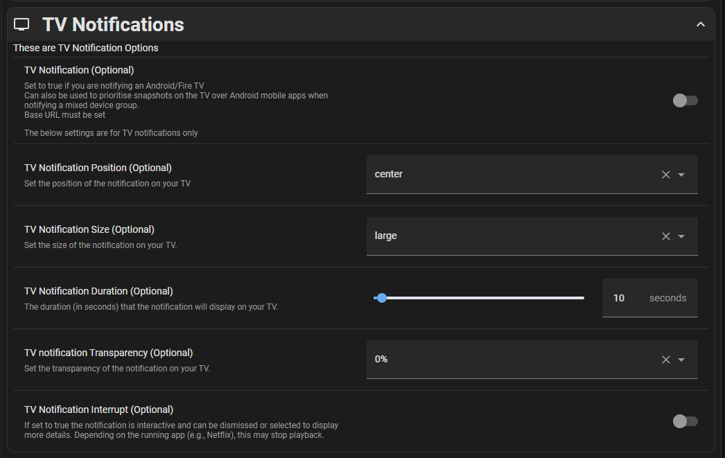

How can I play frigate zone notification recording on android TV using homeassistant?
want to do this but with firgate zone notification as trigger and frigate recording as media.

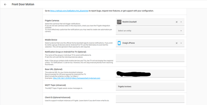

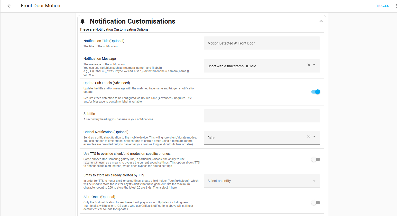

I’m having a problem getting these notification to work. Have I configured this properly?
Everything else is just default and I didn’t change anything.

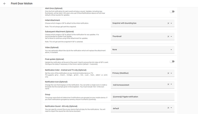

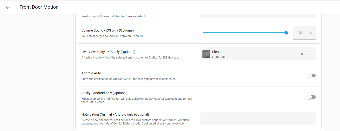

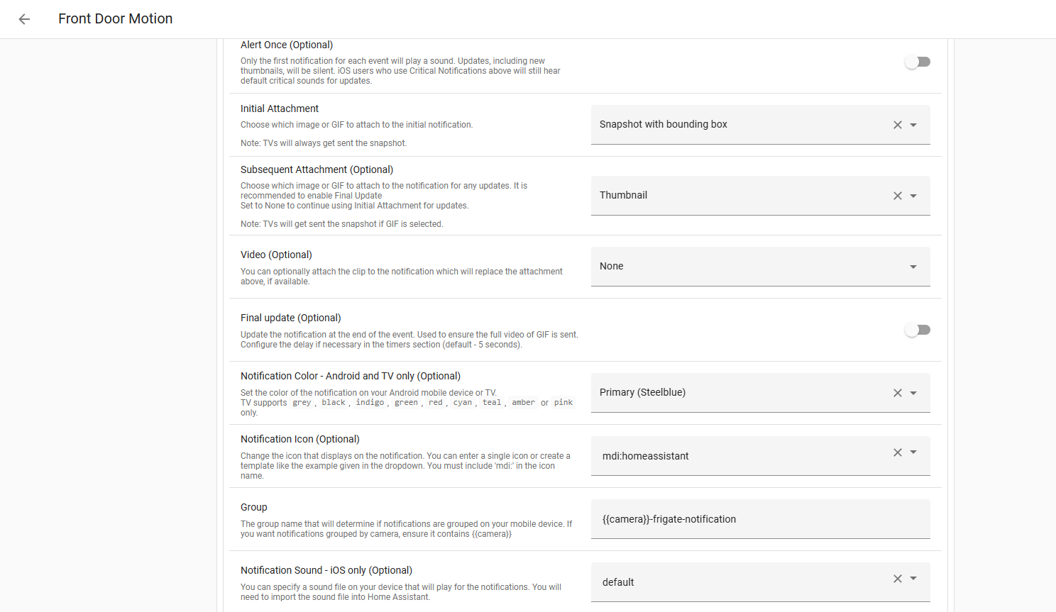

Hey there. I recently updated frigate from 13 to 15 and that ment I needed to update my blueprint from 12.0.2 to latest. Now I got everything working pretty well but I’ve noticed one thing that isn’t working on my iPhone. Before I could long press on the notification and it would bring up a preview snapshot and the action buttons. Now when I long press it’s just a black box that’s acting like it wants to play something. I have initial attachment set to snapshot with bounding box. Should I choose something else? If I regular click on the notification the url opens with the snapshot with bounding box as expected. Just wish I could get the preview to work again. Any help troubleshooting this?
Update… I removed the option ā€œlive view entity - iOS only (Optional)ā€ and now my notification long press is showing the snapshot like I wanted. Thanks for the great blueprint.
