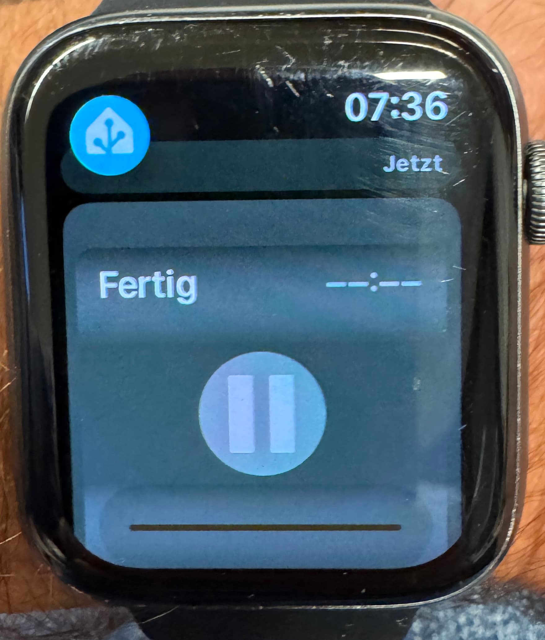

Does anyone has the problem, that the Apple Watch notifications try to play a video instead of a snapshot? No live view, no video - just snapshot with bounding box :slight_smile:
Yes, I’m seeing the same on my watch. It seems to have odd behavior since update in to iOS/WatchOS 26, seeing the play video or notification with no attachment.
Same problem here which started today. I have not updated my watch OS from what I can see. Been on 11.6 for a while. Updated home assistant to 2025.10 yesterday though

I have the same problem, when i sent a data message with mobile.app notify.
This solved it for me:
Thanks, i uninstall the homeassistant app on the watch and now it works. But when i reinstall the app it doesn´t work. I need the app for ios.actions on the watch.
So i have to wait for a fix.
I use now the telegram bot for notifications. This works fine.
this issue was fixed in the beta version of the home assistant ios app!
