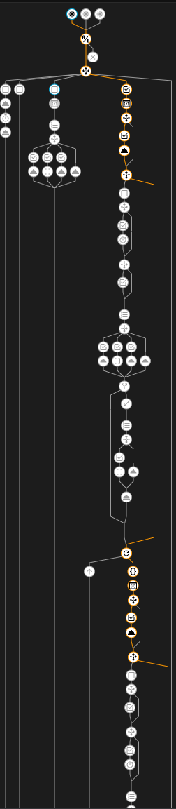

It’s actually much easier to glance at the trace tree. It’s a long screenshot but can you share a look at the tree
Hopefully this works, had to zoom out a bit to get it all.
It skipped both notification blocks. Where it branches to the right column that is a bypass due to conditions not being met.
To see what conditions are not met you can click the empty square one step below the branch and view which condition was false.
First one was
[Zone Filter]
Executed: February 9, 2026 at 1:55:49 PM
Result:
result: false entities:
2nd one was
Option 0
Executed: February 9, 2026 at 1:56:21 PM
Result:
result: false
conditions/0
[If 7 conditions match]
Result:
result: false
conditions/0/conditions/0
Result:
result: true entities:
conditions/0/conditions/1
Result:
conditions/0/conditions/2
Result:
Result:
result: true
Result:

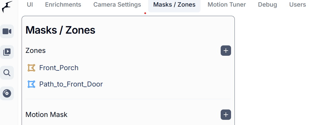

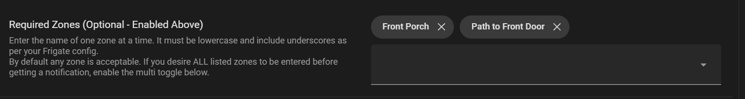

I uploaded pics of what I have the zones named…I think its correct unless it changed and I need it like Front_Porch vs Front Porch now.
On the second one, I’m not sure which section got the false report.
Thank you!
I prefer to use the alerts by zone kind of setup using frigate directly. But it should still work the way you are trying it. Have you tried putting them lowercase with underscores as per the description for that zone filter.
Ok, got it to work by doing everything lowercase and using the _ in between, which is different than it used to be.
