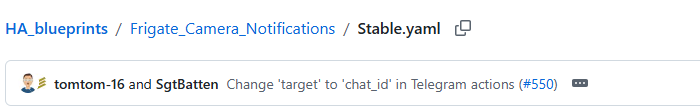

I am trying to get SgtBatten’s blueprint to work but it has beat me. Would someone please shine a light on what pure obvious thing i am doing wrong.

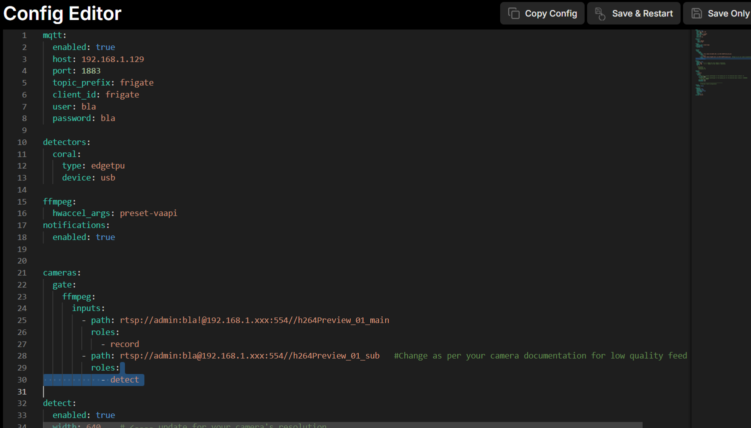

I have Frigate installed with a Reolink camera streaming. The camera is detecting persons through HA. My logs are clear in frigate. I can see MQTT is connected to frigate.
My problem is I am not getting any notifications at all to my mobile. In the blueprint I have just selected my camera and mobile that the blueprint had discovered itself and selected snapshots and persons. I couldn’t get MQTT to listen on reviews, so I changed that to events, I could see info while listening. Before, Action, End No New…

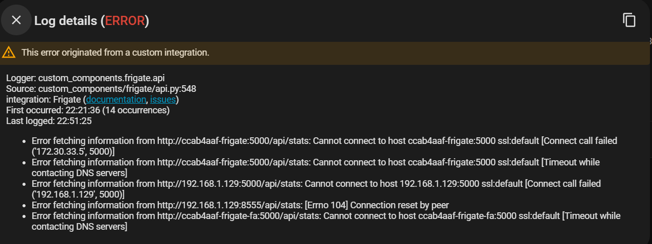

My log in HA is saying
This error originated from a custom integration.
Logger: custom_components.frigate.api
Source: custom_components/frigate/api.py:548
integration: Frigate (documentation, issues)
First occurred: 00:25:45 (2 occurrences)
Last logged: 00:26:03
Error fetching information from http://frigate:5000/api/stats: Cannot connect to host frigate:5000 ssl:default [Timeout while contacting DNS servers]
How do I correct this?

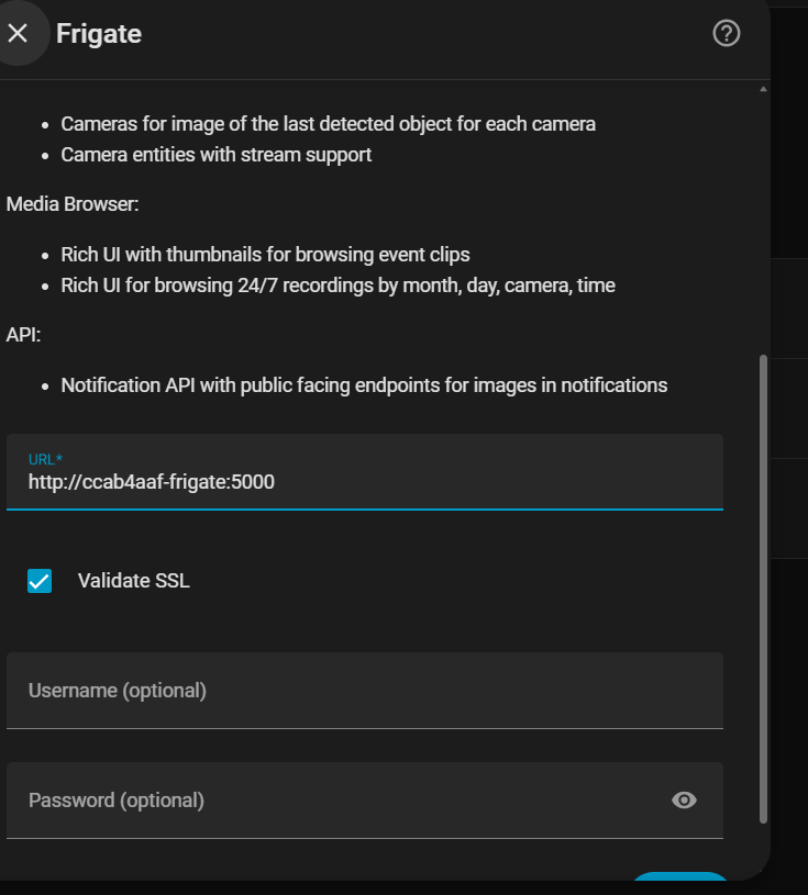

You need to use a url that points to home assistant, not frigate.

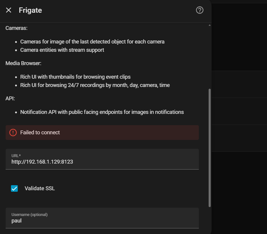

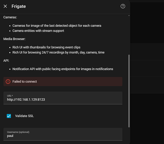

ok, thanks, I tried my local 192.168.x.xxx:8123 with password but it won’t connect either.

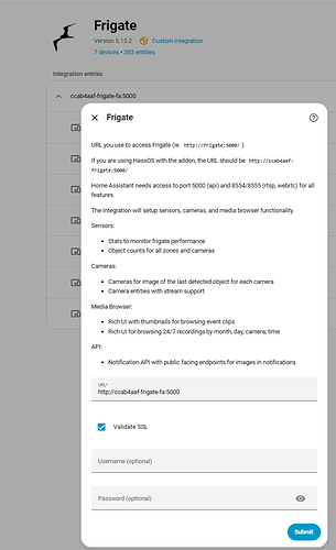

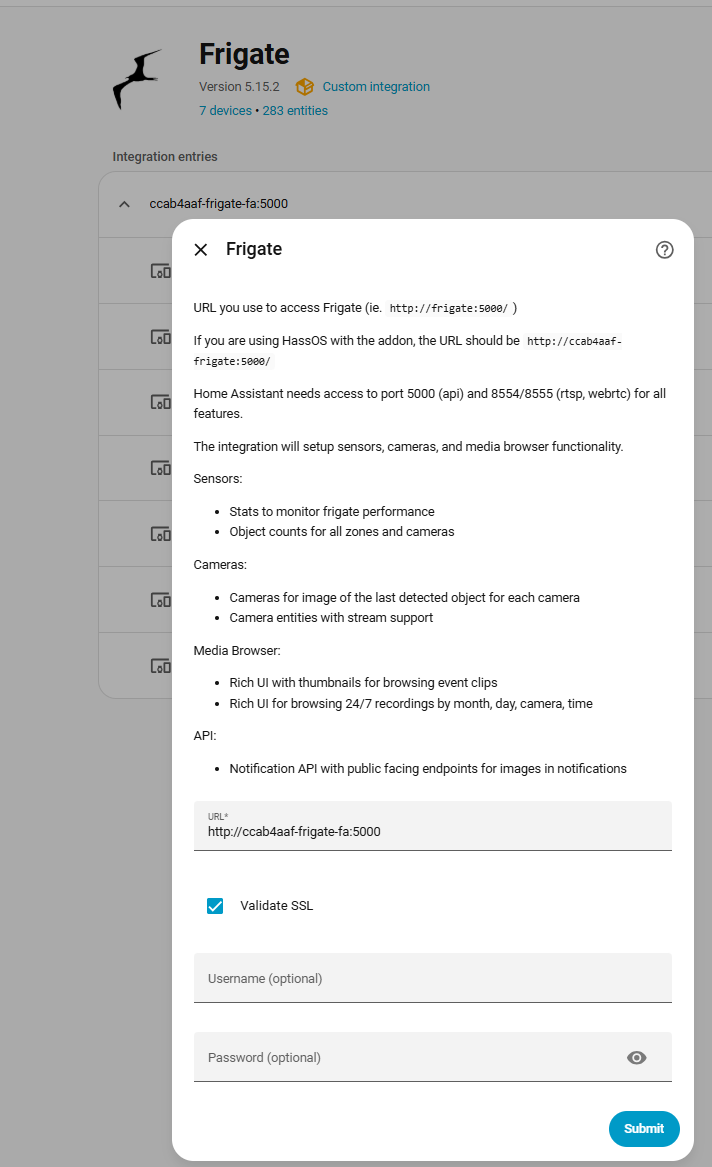

I have mine pointing to the Frigate App container:
http://ccab4aaf-frigate-fa:5000
me too but i keep getting error in log in home assisrant
i was running Frigate FA first and then deleted it because it didnt work. So now I am using basic Frigate. I am aware there is two different urls and I have tried them both.
use the exact address I posted, not ‘frigate’.
Oh I see, you have an issue with the integration not the blueprint.

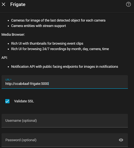

This url gets me connected ok but my issue is no notifications. I am running basic frigate not FA Frigate

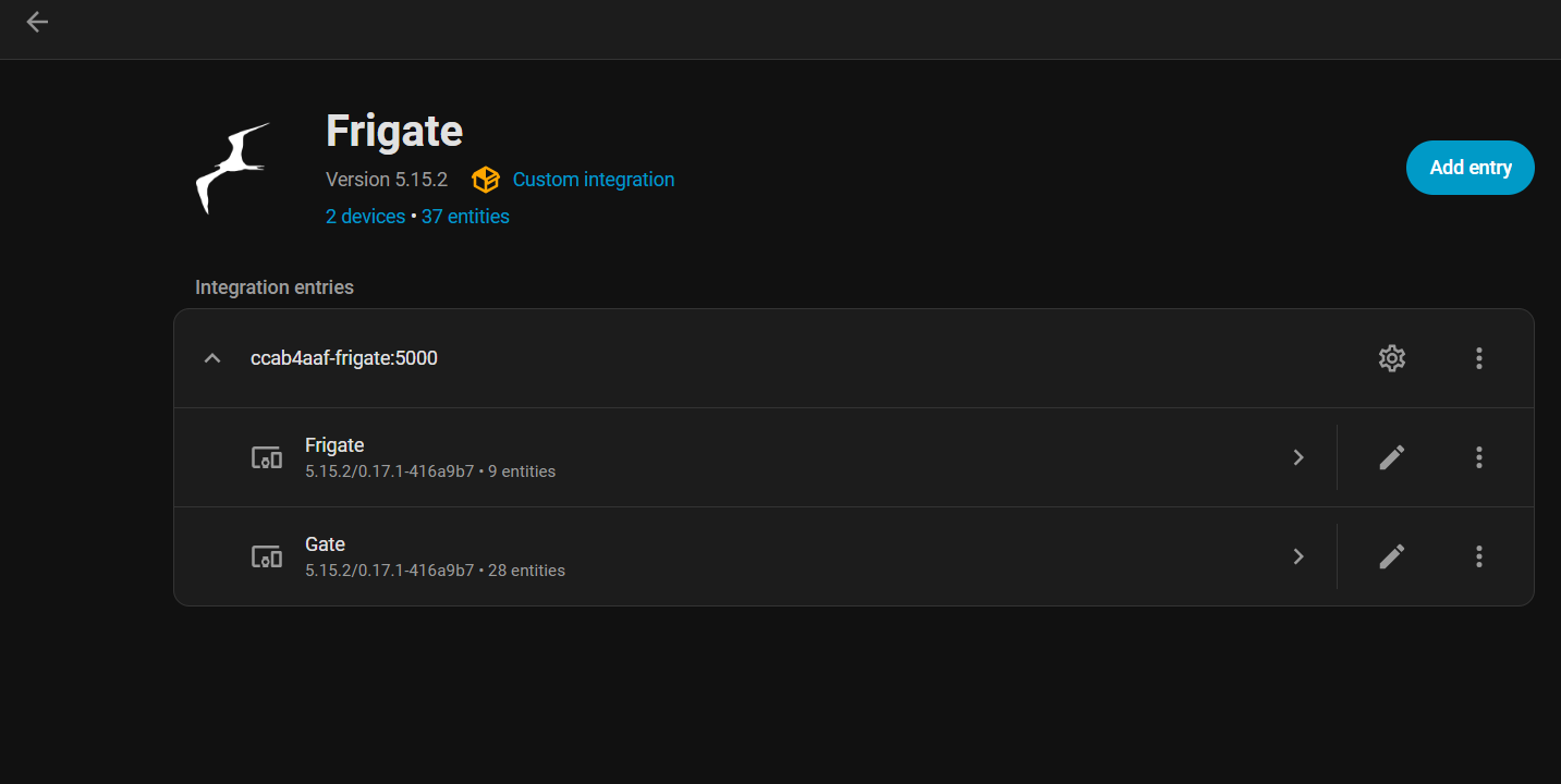

I deleted the integration and added it again. now I don’t have any errors in logs. Unfortunately I am still not getting any notifications or snap shots from the blueprint; I can see my snap shots in home assistant media everytime i walk past camera.

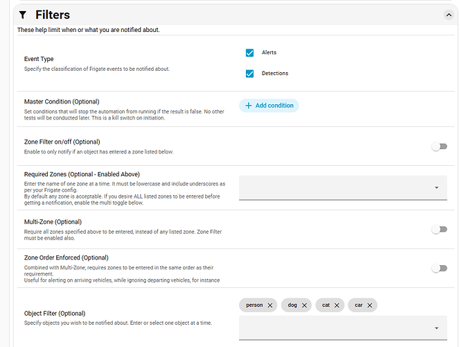

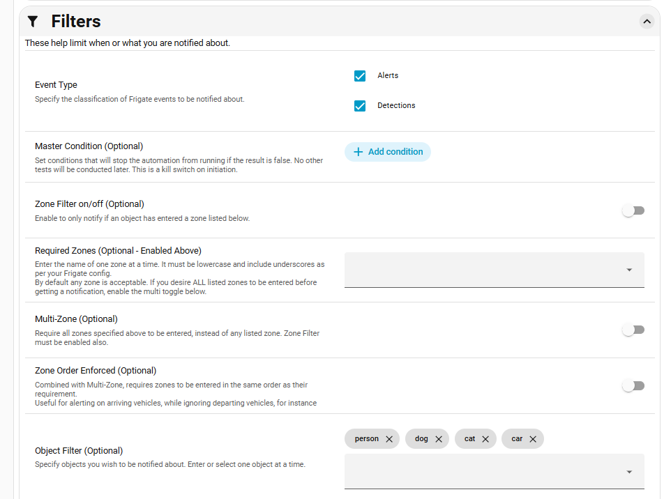

in the blueprint should the MQTT Topic (Advanced) be set to frigate/reviews or frigate/events? is there anything else that would cause not to send a notification ? My camera was automatically picted up and My mobile.
This is mine:
Guessing you have selected your phone or a notify group:
yes same as yours.

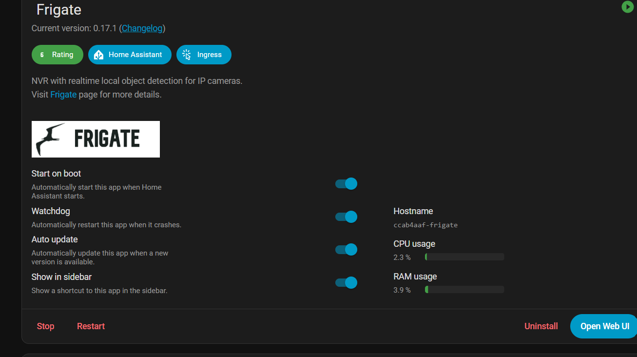

I have frigate working as an add on to my HA OS. I created another automation with SgtBatten blueprint again but still no notifications.
Why aren’t you using the ‘full access’ app? Could that be an issue?
I tried using the full access app and had the same problem of no notifications. I have spent ages at it, just not getting anywhere. So, I deleted the FA and installed the basic Frigate but still the same no notifications to mobile from this blueprint.
This is my integration.

I had a look at at settings apps, frigate, logs and I spotted this error

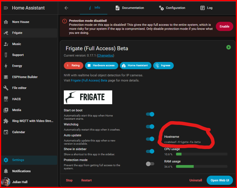

need to double check url of your app … not all the same…
