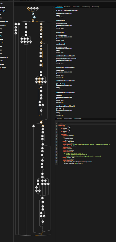

I have attached my trace of the automation
thanks

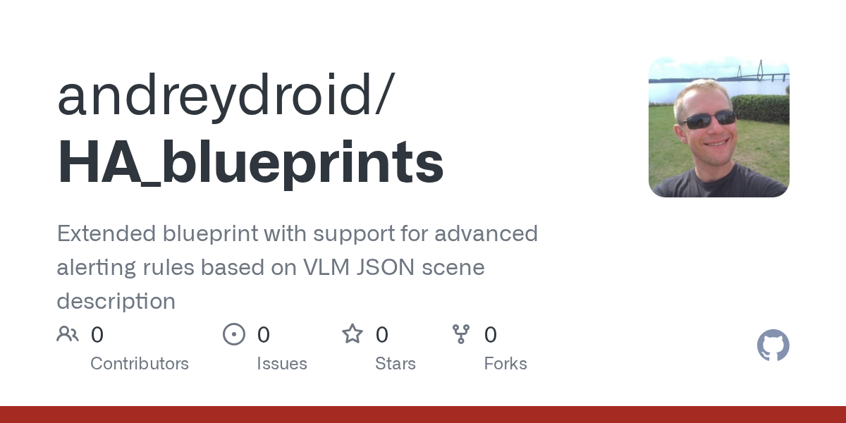

Hey all,
Wanted to give back to the community - my fork of the sergeant's awesome blueprint that:
adds smart alerts driven by Frigate's per-object GenAI / VLM scene descriptions, so you can notify on what is actually happening — "unsupervised child near the pool", "person at the gate at night", "package being taken", "delivery" — instead of "person detected, again".
It is not a parallel notification system: the VLM logic is wired into the SgtBatten blueprint as an extra branch, reusing the same notification dispatch, tags, and actions.
Hope this is useful to someone. Shoutout to SgtBatten on doing all the heavy lifting.
