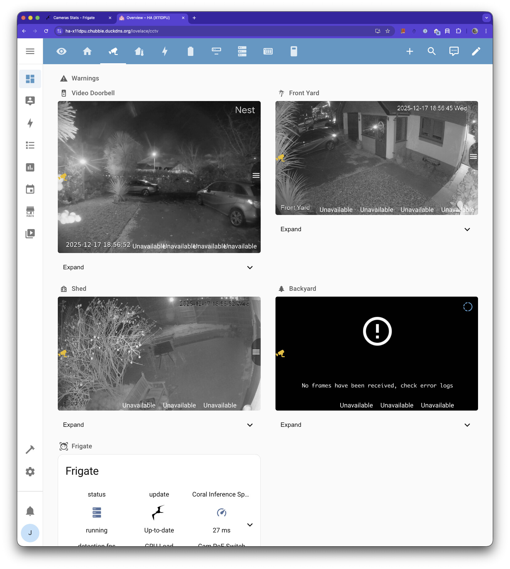

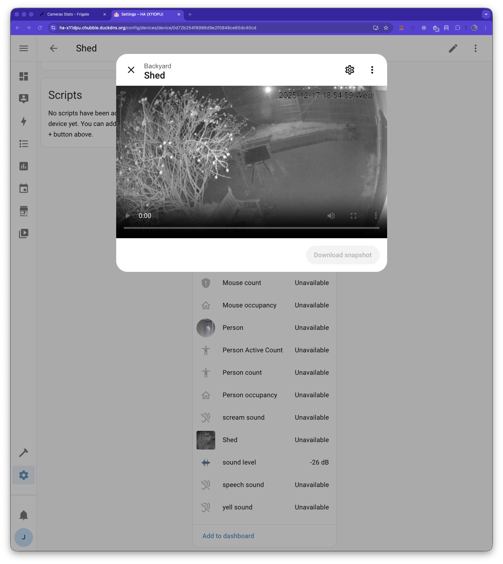

My frigate integration has lost most of the states.

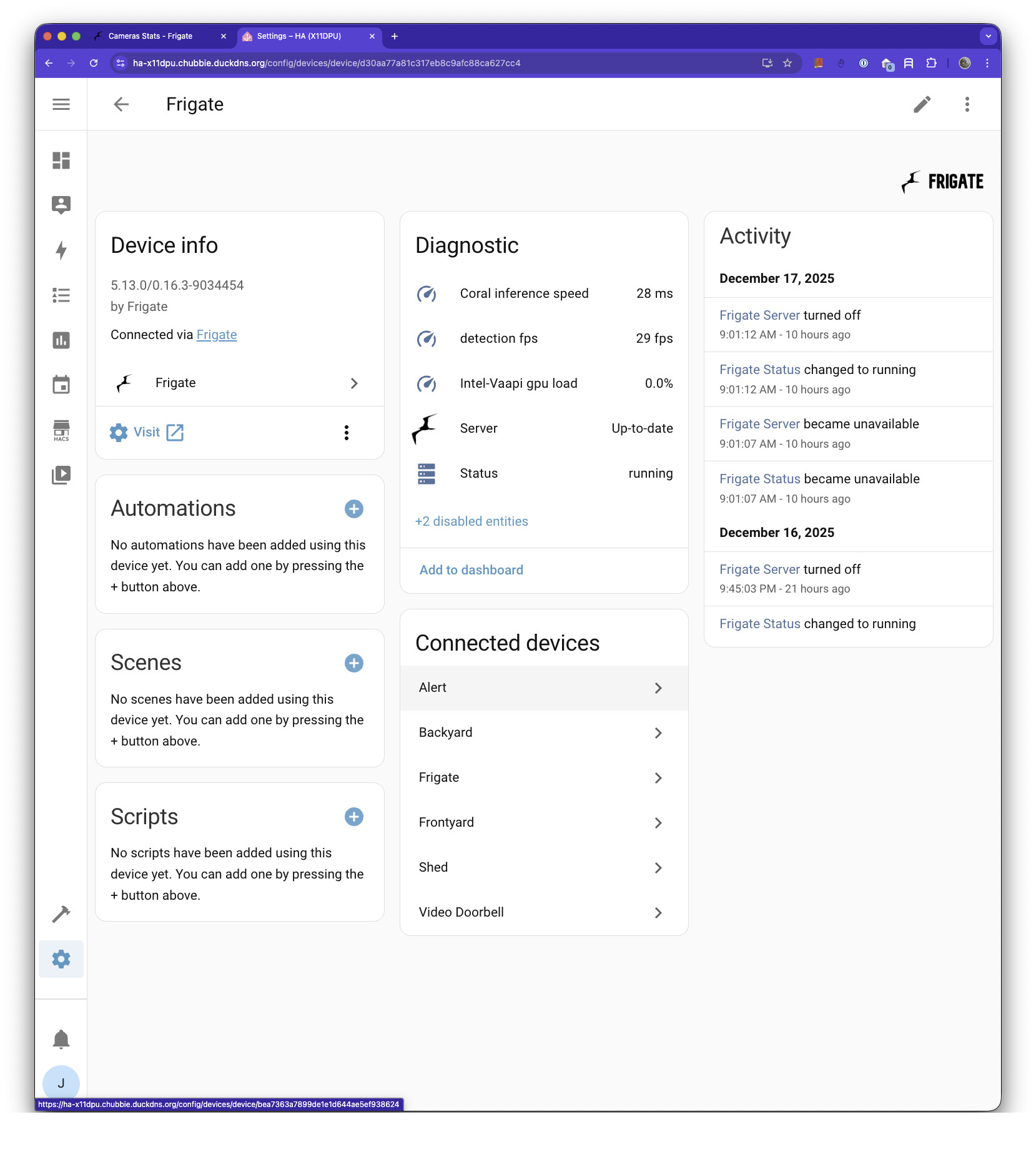

Only those under device “Frigate” are working.
Strangely enough. The video streams are working fine. (please ignore the backyard camera. The camera is dead and I have yet fixed it.)

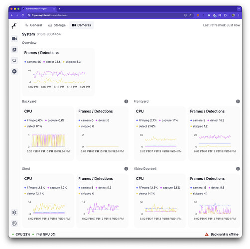

I checked those stats are available on frigate itself.

Afaik the sensors that are unavailable are relying on MQTT, while othere are done by the integration.
So check the MQTT settings in Frigate, the MQTT broker and integration, and the Frigate, MQTT broker and HA error logs.
ps. I have trouble detecting cats. So mice? Is that a fast moving pixel detector? OK, I know substreams from Reolink are low res, but still :slight_smile:
You nailed it pal! It was MQTT!
