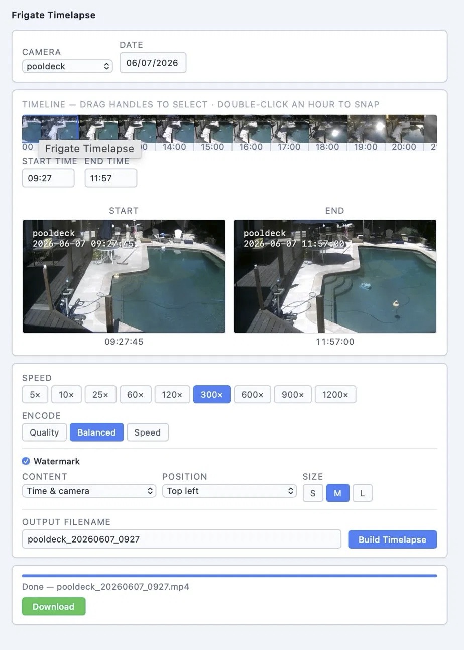

I've built a Home Assistant add-on that generates timelapse videos directly from Frigate NVR recordings, and I wanted to share it with the community.
What it does
Frigate removed timelapse from its UI back in v0.14, leaving it API-only and difficult to use. This add-on fills that gap with a proper browser-based UI that lets you visually select a time range and render an MP4 timelapse from your recorded footage.
Features
  • Visual timeline scrubber populated with real thumbnails from your recordings
  • Drag handles to set start/end range, or double-click any hour to snap to it
  • Direct time entry fields for precise control
  • Start and end frame previews with timestamp watermarks so you know exactly what you're rendering
  • Speed multiplier from 5× to 1200×
  • Quality/Balanced/Speed encode options
  • Watermark overlay (camera name + timestamp, configurable position and size)
  • Multithreaded rendering using all available CPU cores
  • Output saves to /media/frigate/timelapses/ — appears automatically in HA Media Browser
  • Direct browser download
  • Background indexing of recordings at startup with incremental filesystem watching

Screenshot
Source
Feedback, bug reports, and PRs welcome. This was built with Claude Code and has been running on my own setup for the past few days — it's working well but treat it as early-stage software.
