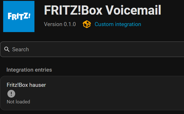

Just now installed this, also the voicemail integration.
The cards works fine, voicemail not so much.

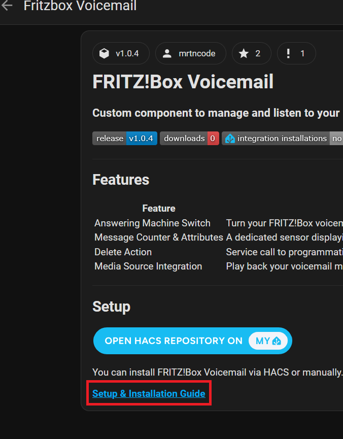

Also, the link to the documentation for voicemail returns a 404
Oh, thats bad.. Seems like a timing problem which only occured for some users. I have fixed it in v0.1.1. Please install this version and remove the integration fully before reconfiguring it :slight_smile:
Which link do you mean? I already fixed the setup link in the readme.

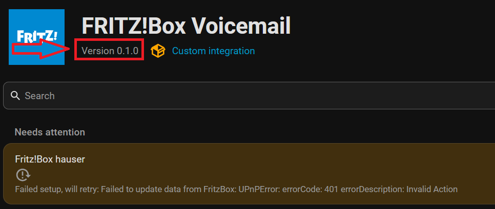

Uhm, the current version of the voicemail integration is 1.0.4
Are we talking about something different?
I am really sorry. I didn’t have much time, I mixed up the repositories and forgot to release the fix.
I have released the fix now with v1.0.5.
The docu link should be also fixed :+1:

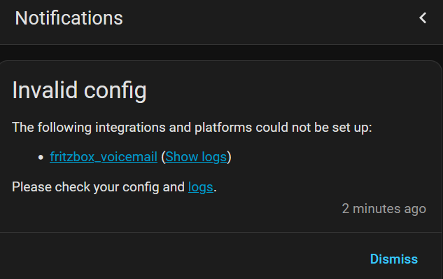

Logger: homeassistant.setup
Source: setup.py:412
First occurred: 10:21:43 PM (1 occurrence)
Last logged: 10:21:43 PM
Error during setup of component fritzbox_voicemail: async_setup() takes 1 positional argument but 2 were given
  File "/srv/homeassistant/lib/python3.14/site-packages/homeassistant/setup.py", line 412, in _async_setup_component
    task = component.async_setup(hass, processed_config)
TypeError: async_setup() takes 1 positional argument but 2 were given
Thanks, that worked great. Quick question: How do you get the call history from call monitor? The according entity itself has no attributes for me.
I accidentally deteled an argument when cleaning the code :zany_face: Fix is on the way! Should be available today.
Edit: Fix is available in v1.0.6 now :slight_smile:
