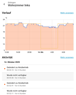

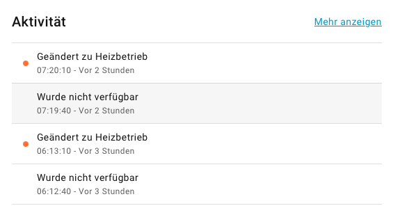

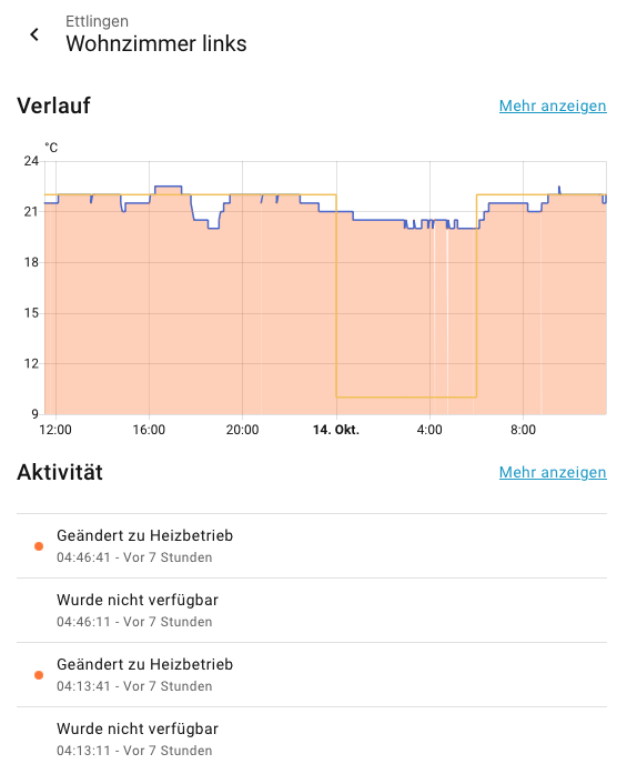

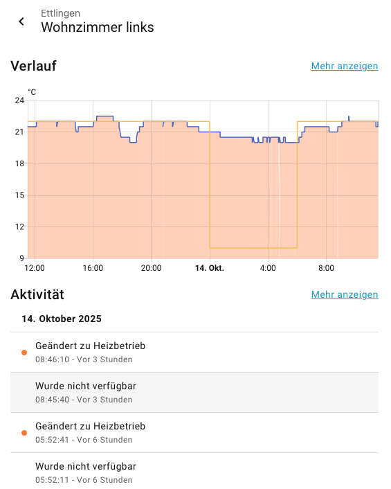

any idea why all my thermostats go offline (“not available”) for 30 seconds regularly?
HA 2025.10.2 running in Docker (TrueNAS) - if that might be the cause of the problem I can switch to a HAOS VM.

But it’s all thermostats at the same second that are “lost”.
