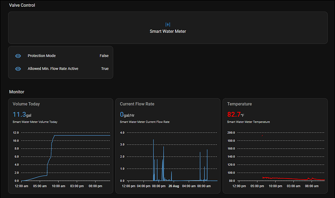

Thank You, Downloaded the Apexcard and added following to Configuration.yaml. Added the Yaml you posted above to dashboard but looks like my Apex charts aren’t loading not sure why, Can you please help me with that ?
resources:
  • url: /local/apexcharts-card.js?v=2.2.0
    type: module
Never mind, its working fine now. Thanks.

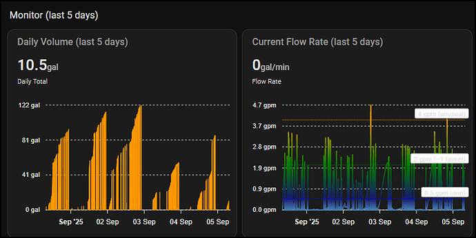

Actually, it looks like it is working but your thresholds aren’t set up correctly (I see the temp graph shows red):
Also noticed you have gal/hr - the numbers on your image look like gpm (i.e. 1.0 to 4.0 gpm)
You will need to convert my Volume numbers from L to gal (i.e L/3.78), Flow numbers L/h to gpm (i.e. Lph / 0.264) and Temp numbers C to F (i.e. (C * 9/5) + 32).
Example:
Current Flow Rate:
color_threshold:
- value: 0.26
color: steelblue
- value: 0.88
color: midnightblue
- value: 1.3
color: green
- value: 2.2
color: green
- value: 3.1
color: orange
- value: 5.3
color: orangered
- value: 6.2
color: red
Got it I played with it a little more and seems like its working now. Good catch on GPH to GPM, I fixed that. Thanks a lot for your help.

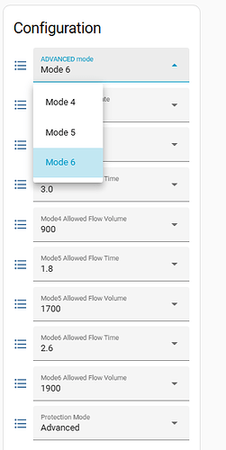

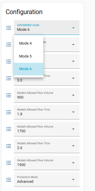

And here’s how it looks on the Tuya_Local device page:

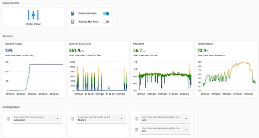

I did notice that some of it is wrong, somehow… 104 is definitely not “water_used_yesterday” - you had it right in your version. It was cool to learn the leak_warn and leak_alarm items as well.

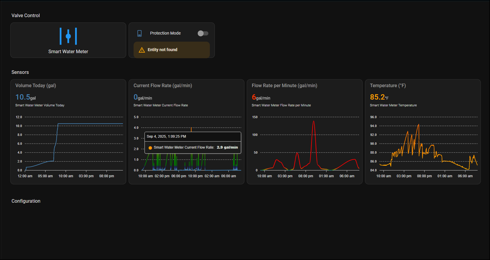

A note - HA didn’t like the units for flow rate (it needs L/h, instead of L/hr) and the Volume Today (103) needs to be class: total_increasing and unit: L - to be used properly with the energy section for water tracking.
Also - somehow the product id changed, so it wasn’t auto-detecting it properly. Updated that as well. It still won’t pick it up locally and match config, but using cloud retrieval it does via product id…
Pasting my YAML config I ended up with (I stripped some sensors I didn’t see a point in):

I also updated my dashboard to use the visibility options to control the configuration items:
Note: There is a defect in Frizzlife firmware where selecting “Auto” protection mode loses the setting for the “Advanced” mode # setting.
You need to toggle a mode number selection when returning to Advanced mode from Auto mode to make Advanced mode permanent. Otherwise Auto mode remains active. This occurs both in HomeAssistant and SmartLife.
Maybe Frizzlife will provide an update in the future.

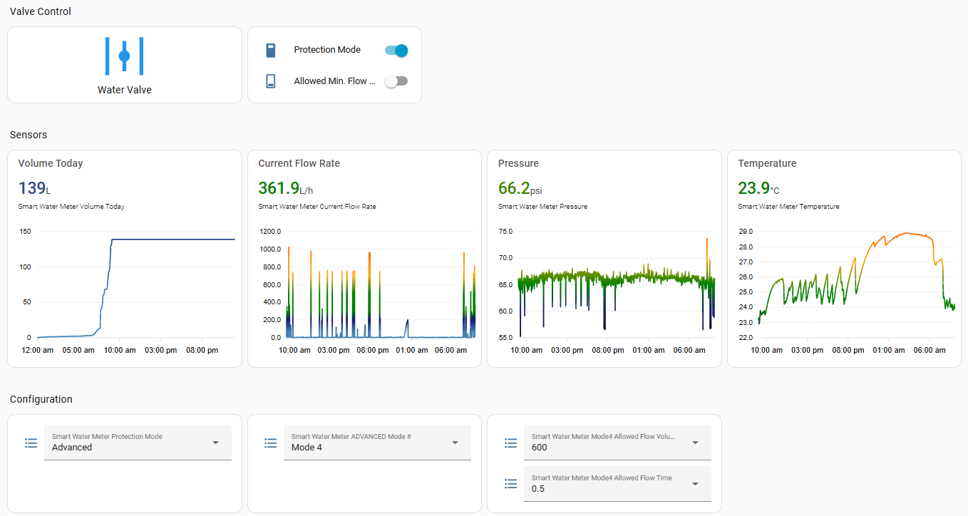

And the raw yaml is:
views:
  - title: Home
    sections:
      - type: grid
        cards:
          - type: heading
            heading: Valve Control
            heading_style: title
            grid_options:
              columns: full
              rows: 1
          - show_name: true
            show_icon: true
            type: button
            entity: valve.smart_water_meter
            tap_action:
              action: more-info
            grid_options:
              columns: 12
              rows: 2
          - type: entities
            entities:
              - entity: switch.smart_water_meter_protection_enabled
              - entity: switch.smart_water_meter_allowed_min_flow_rate_active
                name: Allowed Min. Flow Rate Active
            grid_options:
              columns: 9
              rows: 2
        column_span: 4
      - type: grid
        cards:
          - type: heading
            heading: Sensors
          - type: horizontal-stack
            cards:
              - type: custom:apexcharts-card
                overflow: hidden
                experimental:
                  color_threshold: true
                  disable_config_validation: true
                layout_options:
                  grid_columns: 4
                  grid_rows: 4
                graph_span: 1d
                span:
                  start: day
                header:
                  show: true
                  title: Volume Today
                  show_states: true
                  colorize_states: true
                series:
                  - entity: sensor.smart_water_meter_volume_today
                    stroke_width: 2
                    curve: smooth
                    show:
                      header_color_threshold: true
                    fill_raw: last
                    color_threshold:
                      - value: 60
                        color: steelblue
                      - value: 200
                        color: midnightblue
                      - value: 350
                        color: green
                      - value: 450
                        color: green
                      - value: 500
                        color: orange
                      - value: 550
                        color: orangered
                      - value: 600
                        color: red
            cards:
                experimental:
                layout_options:
                  grid_columns: 4
                  grid_rows: 3
                graph_span: 1d
                header:
                  show: true
                  title: Current Flow Rate
                  show_states: true
                series:
                  - entity: sensor.smart_water_meter_current_flow_rate
                    stroke_width: 2
                    curve: smooth
                    show:
                    fill_raw: last
                    color_threshold:
                      - value: 60
                        color: steelblue
                      - value: 200
                        color: midnightblue
                      - value: 300
                        color: green
                      - value: 500
                        color: green
                      - value: 700
                        color: orange
                      - value: 1200
                        color: orangered
                      - value: 1400
                        color: red
            cards:
                experimental:
                layout_options:
                  grid_columns: 4
                  grid_rows: 2
                graph_span: 1d
                header:
                  show: true
                  title: Pressure
                  show_states: true
                series:
                  - entity: sensor.smart_water_monitor_pressure
                    stroke_width: 2
                    curve: smooth
                    show:
                    fill_raw: last
                    color_threshold:
                      - value: 50
                        color: red
                      - value: 55
                        color: orangerd
                      - value: 60
                        color: midnightblue
                      - value: 65
                        color: green
                      - value: 70
                        color: orange
                      - value: 75
                        color: orangered
                      - value: 80
                        color: red
            cards:
                experimental:
                layout_options:
                  grid_columns: 4
                  grid_rows: 3
                graph_span: 1d
                header:
                  show: true
                  title: Temperature
                  show_states: true
                series:
                  - entity: sensor.smart_water_monitor_temperature
                    stroke_width: 2
                    curve: smooth
                    show:
                    fill_raw: last
                    color_threshold:
                      - value: 0
                        color: steelblue
                      - value: 22
                        color: midnightblue
                      - value: 24
                        color: green
                      - value: 25
                        color: green
                      - value: 27
                        color: orange
                      - value: 30
                        color: orangered
                      - value: 35
                        color: red
        column_span: 10
      - type: grid
        cards:
          - type: heading
            heading: Configuration
            grid_options:
              columns: full
              rows: 1
          - type: entities
            entities:
              - entity: select.smart_water_meter_protection_mode
            visibility:
              - condition: state
                state: 'on'
          - type: entities
            entities:
              - entity: select.smart_water_meter_auto_mode
            visibility:
              - condition: state
                state: Auto
              - condition: state
                state: 'on'
          - type: entities
            entities:
              - entity: select.smart_water_meter_advanced_mode
            visibility:
              - condition: state
                state: Advanced
              - condition: state
                state: 'on'
          - type: entities
            entities:
              - entity: select.smart_water_meter_mode4_allowed_flow_volume
              - entity: select.smart_water_meter_mode4_allowed_flow_time
            visibility:
              - condition: state
                state: Mode 4
              - condition: state
                state: Advanced
              - condition: state
                state: 'on'
          - type: entities
            entities:
              - entity: select.smart_water_meter_mode5_allowed_flow_volume
              - entity: select.smart_water_meter_mode5_allowed_flow_time
            visibility:
              - condition: state
                state: Mode 5
              - condition: state
                state: Advanced
              - condition: state
                state: 'on'
          - type: entities
            entities:
              - entity: select.smart_water_meter_mode6_allowed_flow_volume
              - entity: select.smart_water_meter_mode6_allowed_flow_time
            visibility:
              - condition: state
                state: Mode 6
              - condition: state
                state: Advanced
          - type: entities
            entities:
              - entity: select.smart_water_meter_allowed_min_flow_rate
            visibility:
              - condition: state
                state: 'on'
        column_span: 4
    type: sections
    max_columns: 10
    cards: []

Also I don’t smart water meter flow rate active sensor switch in your yaml so my dashboard is giving errors “entity not found”

103 is the volume of water provided today - resets to 0 at midnight.
104 - had to guess on this one - my best guess is it’s the cumulative flow based on a sliding hour window (i.e. Liters per hour) - it updates once an hour.
105 is the current flow being supplied (i.e. I think this updates every 30 seconds but may be more often) - is considerably larger than 104.
Note: I now have a fair bit of stats gathered, in the next day or two I’ll run through them to see if my units are correct. I’ll try an integration over the current flow to see if it matches the flow per hour numbers.
What does your current water flow look like while the water softener is being recharged? Is the recharge occur at a scheduled time?
Is there something about the flow that is unique so you can trigger an automation to either turn off protection (not optimal) or briefly change your limits (better) for a set time period.
Thanks for info on 104 & 105, I guess I need to change 104 to gal / hr then. I am still trying to figure out the pattern to establish the limits. I might pull the flow rate and total volume data for past 10-14 days and review it. Below is 5 day plot as of now. I haven’t yet looked the recharge pattern yet, its also possible that recharge cycle may now show significant flow since Value is connected to Out Line of softener which ideally shouldn’t have any flow during recharge, It was too difficult to connect it to In-line of Softener :
Also not sure why all the configuration isn;t showing on my dashboard like yours :-(. I’ll do some digging during the weekend and ask for your help if needed. Thanks a lot for all the good work you have done.

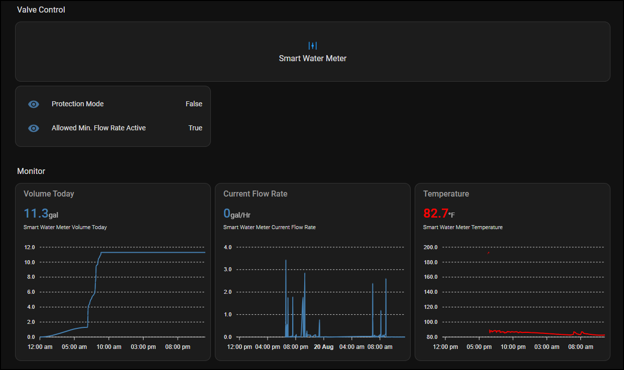

DjAnu: I was on Vacation for the last 2 weeks so didn’t get a chance to respond.
I set up the configuration with visibility options - so with protection mode turned off, the configuration items don’t appear. Also, you have an entity not found for the Allowed Min Flow. You must have a typo or changed the name of that entity.
Try turning on protection mode, and the “Protection Mode”, “Mode #”, “Allowed Flow Volume”, and “Allowed Flow Time” should be displayed.
You’ll have to investigate why the “Allowed Min Flow” entity is not found.
@grimmt, thanks so much for figuring this out and sharing.
Not sure if it helps anyone, but I added a “class: water” to the Volume Today entity, which allowed me to setup water monitoring in the energy section of Home Assistant

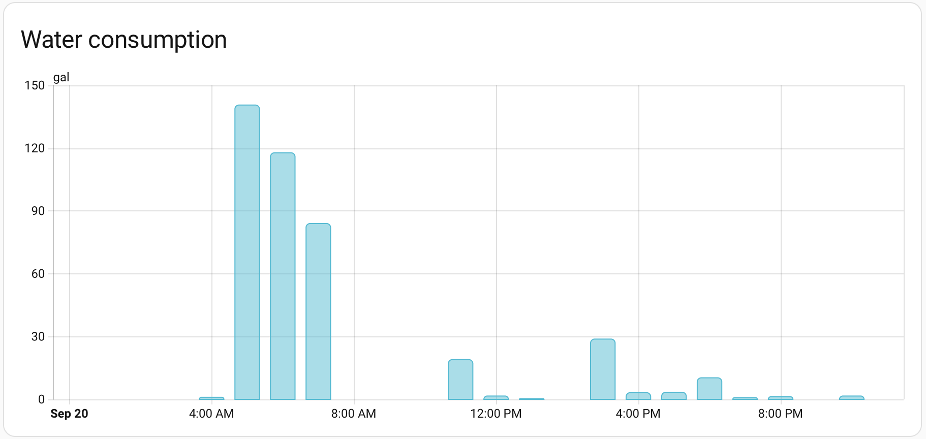

Is there a way to see total gallons (not just “today”)? Seems one could add the value at the end of ever day as a running total, but I think that’s asking for trouble. I want a way to track my water filter life. Even if it’s lifetime, I can set up a helper with a reset and basic math to find total since the last filter replacement.
