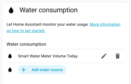

This is the reason why I added this to the energy monitoring section. Homeassistant does all the hard work, once tag the “Volume Today” entity with the class: water attribute, and configure the Water Consumption section of the Energy Configuration
You can then view the water consumption per hour / day / month / year.

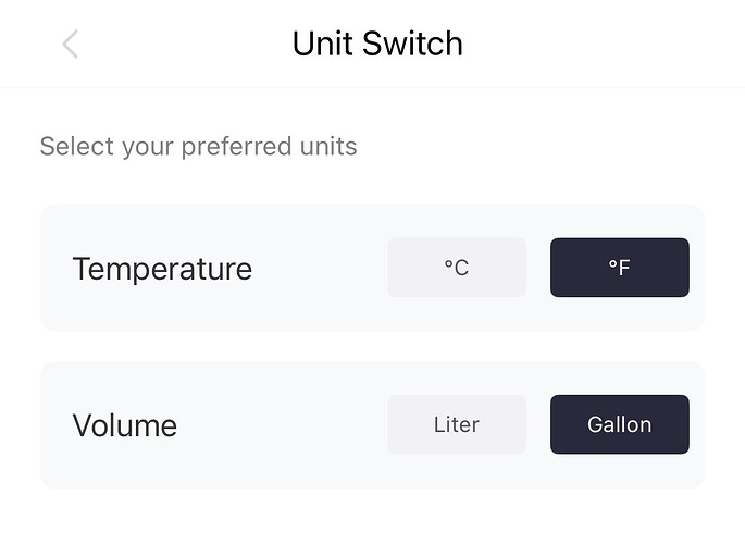

I noticed that ids 106-108 in your YAML ae different than previous YAML. Which ones are correct ?
I got those from the Tuya spec, if they are wrong or translated wrong, let me know.
Hi Roy, finally got around to testing your YAML. Everything looks good for me except water temperature. its showing up as -7.5C when it should be about 18.5C. I’m guessing the cause is using DPS 102 as the selector for temperature. Since my device is configured for us-units for volume, but metric units for water temperature, it might be using a different DPS for water temp units?
Other than that, everything seems to be working very well. thanks for the update - looking forward to this being merged.
I didn’t see a way to have different units for water and temp… How do you set that?
I set it in the SmartLife app. Seems to toggle dps 20 between values “c” and “f”.
Thanks, it must detect I’m in US and not show me that… try this one.
