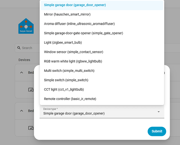

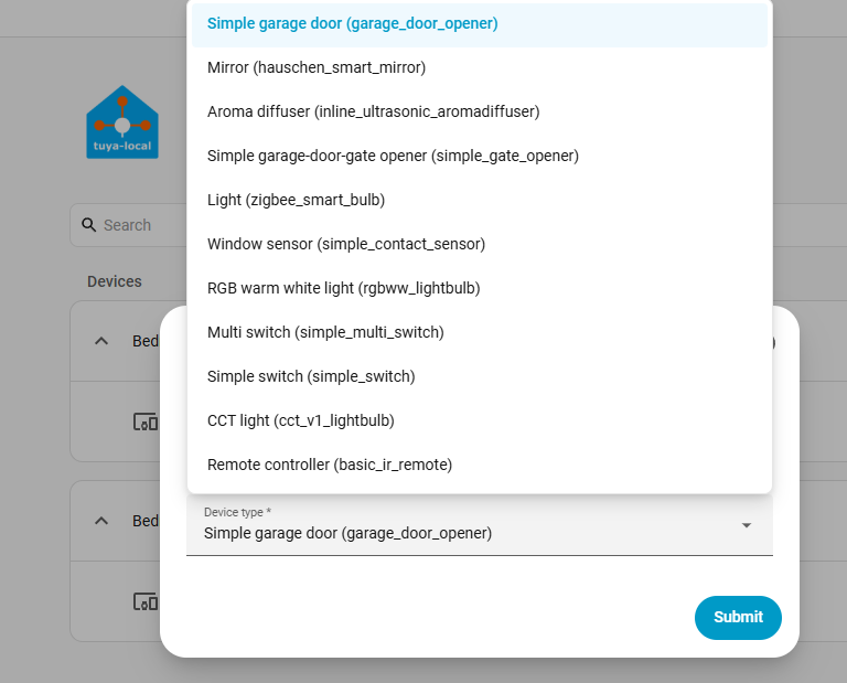

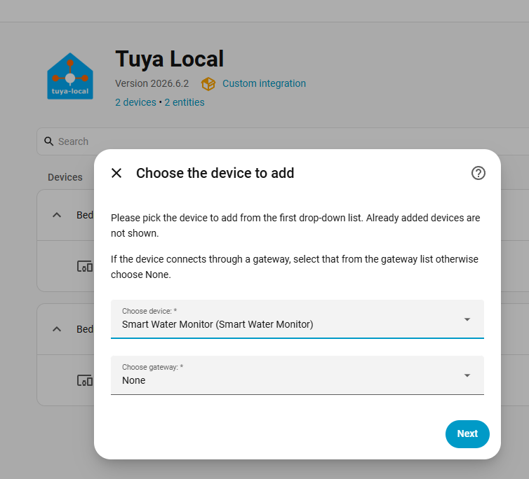

Not sure what happened there, but all my tuya local devices (some color bulbs, plugs and the frizz) showed as unable to connect to. I deleted them from HA and try to add them again. The Frizzlife doesn't show to choose the right device, but instead some other ones. I chose SIMPLE SWITCH and it controls the valve but I don't have any other entities with the device. What could be wrong and how can I choose the right device?
And then this:
Well, I knew it would be something utterly stupid. Even though the Frizz was able to be added to SmartLife multiple times (after removing it from SmartLife, every time I get a new local key), it was causing the error. I finally decided to reset it (holding PROTECT and VALVE for 10sec) and lose my precious total gallons and custom protect settings :smirking_face:
Now it was added to Tuya local immediately. Problem solved

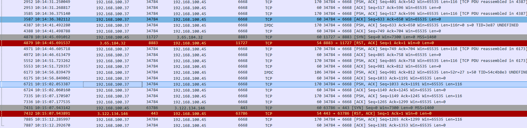

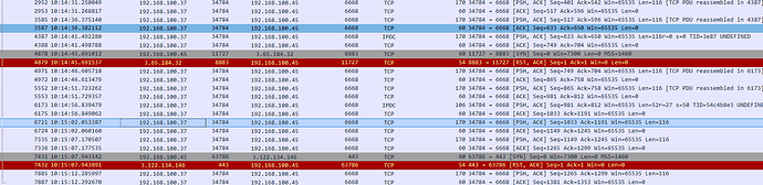

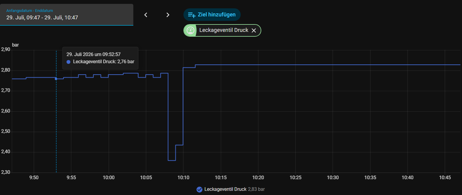

Hi there,
I got my Frizzlife lp365p some days ago and mounted it successfully. Thanks to the great work in this thread, I managed somehow to connect my tuya local installation to the device. But I still have some problems/questions:
  • The update rate is very sparse. When I have the android app, it sometimes updates once a minute (same as andoid app). Is it possible to get faster updates? Especially the flow and pressure would be interesting to implement my own security rules.
  • When I disable internet access for the Frizzlife in my fritzbox router, there are of course no updates in the app anymore but there are also no updates anymore in homeassistant?!
    I switched off the app and internet at around 10:11… There are some hints that this might have to do with protocol 3.5 which is used for the lp365p?
  • I found hints (GitHub - myhomeiot/localtuya35: local handling for Tuya devices · GitHub), that blocking DNS requests for the Frizzlife might help? I checked network traffic for the Frizzlife with Wireshark and found that there is regularly DNS requests for m3-eu.lifeaiot.com. And despite internet blocking, the DNS request is answered by fritzbox router. One idea would be to use an ESP32 and this project (GitHub - martin-ger/esp32_nat_router: An AI-enabled NAT Router/Firewall for the ESP32 · GitHub) to block DNS requests from Frizzlife LP365P. But maybe that’s overkill?
  • Is it right, that the total amount of water is not shown in app and homeassistant? I also found no dps for the device, but I think total volume is shown in the display of the device? What the heck?!
  • The dps 104 is in the data model like the following, but the value is definitley not the volume from yesterday… Is it a known bug?
        "code": "water_used_yesterday",
        "custom_name": "",
        "dp_id": 104,
        "time": 1785178502810,
        "type": "value",
        "value": 12
  • I checked the wireshark log and when internet is blocked, I only see traffic from homeassistant to lp365 around every 5 seconds, but no answers from the device… Maybe there’s a problem with the encryption?
Sorry for all the questions. I hope someone can help me a little? Or at least report, if your lp365p homeassistant integration works good? It’s really terrible, that there is no good leakage sensor available, which has good interface options and all necessary features (time limit with times down to minute level, volume limit, maximum flow limit with shutoff without delay). I’m just about to build something like that myself using an ESP32… But hey, maybe I can fix my device and it turns out good :slight_smile:
